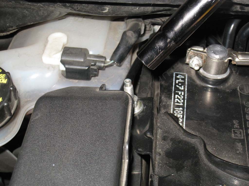

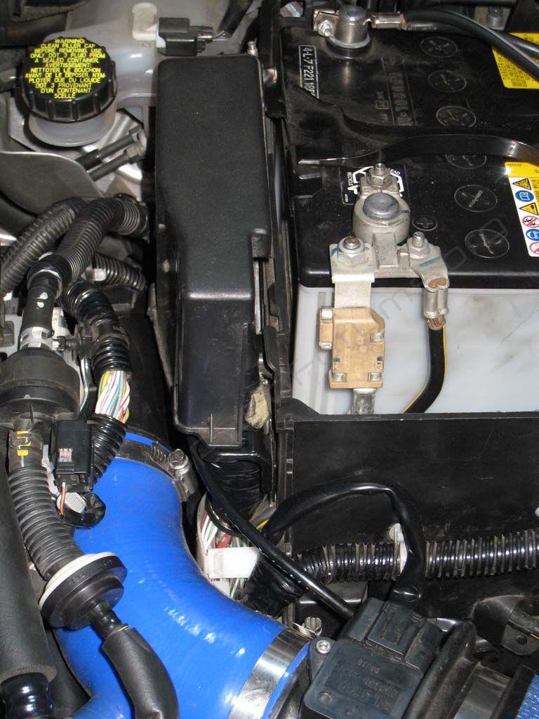

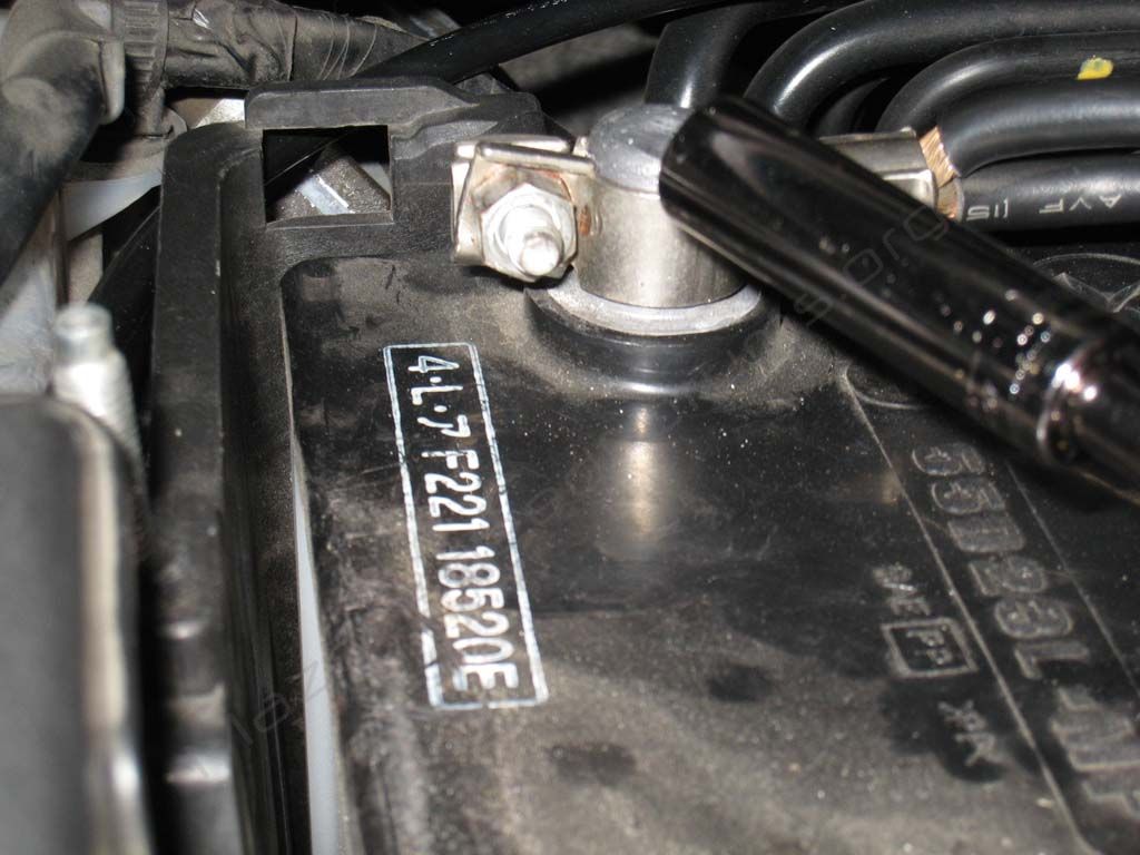

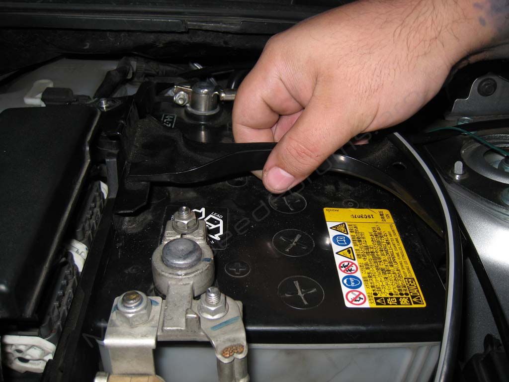

We will start by removing the battery. First things first, remove the battery hold down bracket using the 10mm socket.
http://www.mazdaspeedforum.org/forum/pics...bo_inlet/9.JPG
http://www.mazdaspeedforum.org/forum/pics...o_inlet/10.JPG

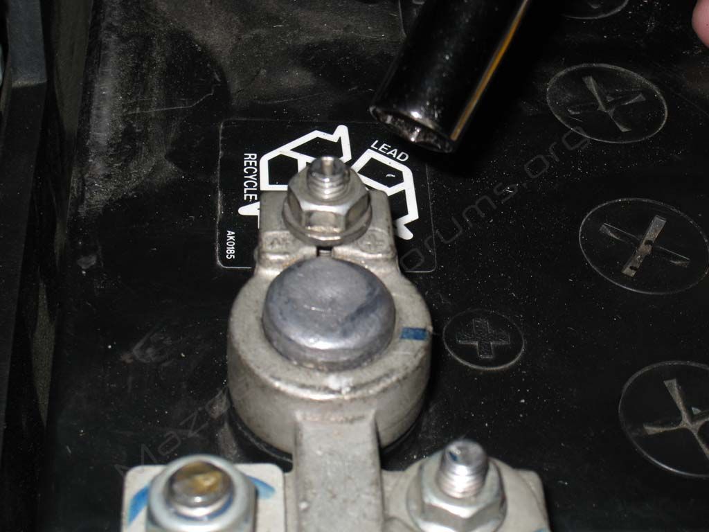

Time to remove both the positive and negative battery terminals from the battery itself.
http://www.mazdaspeedforum.org/forum/pics...o_inlet/11.JPG
http://www.mazdaspeedforum.org/forum/pics...o_inlet/12.JPG
http://www.mazdaspeedforum.org/forum/pics...o_inlet/13.JPG

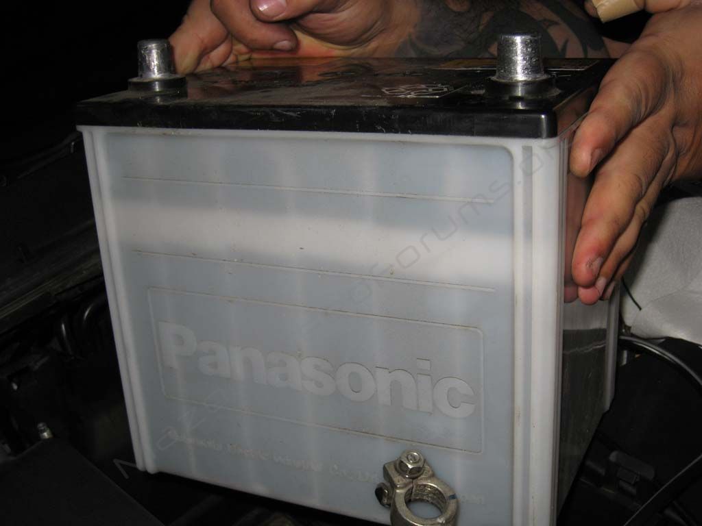

Now, with the bracket and terminals disconnected, remove the battery from the tray and set it off to the side.
http://www.mazdaspeedforum.org/forum/pics...o_inlet/14.JPG

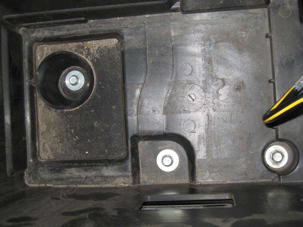

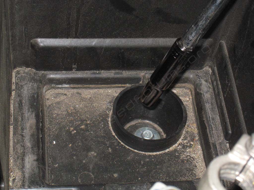

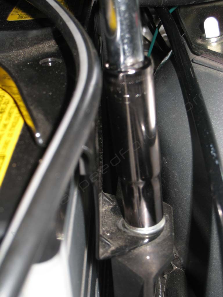

Now, remove the 10mm bolts holding the tray to the engine bay. These guys are snugger kinds tight, so use some muscle here.
http://www.mazdaspeedforum.org/forum/pics...o_inlet/15.JPG
http://www.mazdaspeedforum.org/forum/pics...o_inlet/16.JPG
http://www.mazdaspeedforum.org/forum/pics...o_inlet/17.JPG

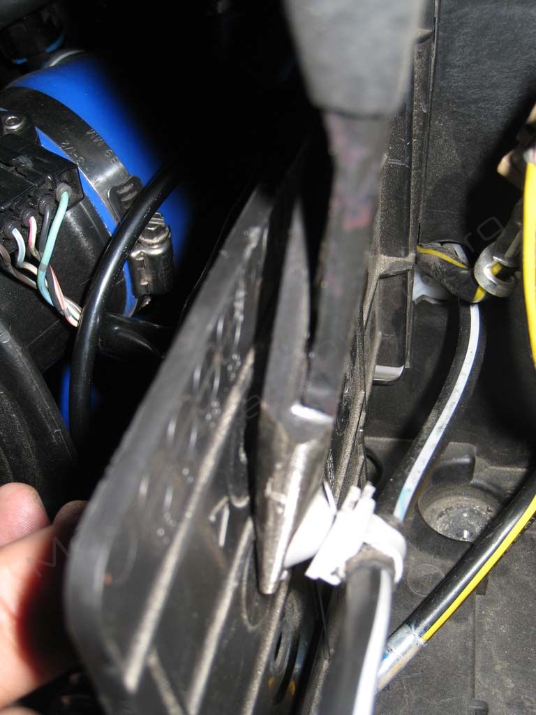

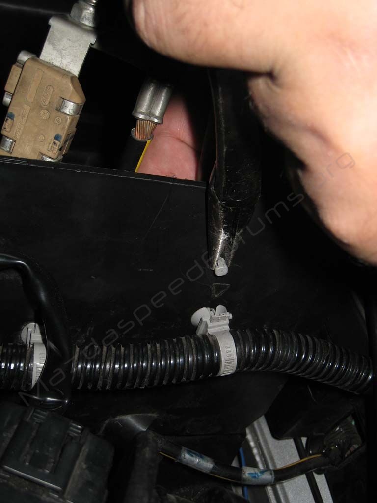

Take your needle noses and squeeze the wire loom retaining clips so they pop out of the hole on the battery box.
http://www.mazdaspeedforum.org/forum/pics...o_inlet/18.JPG

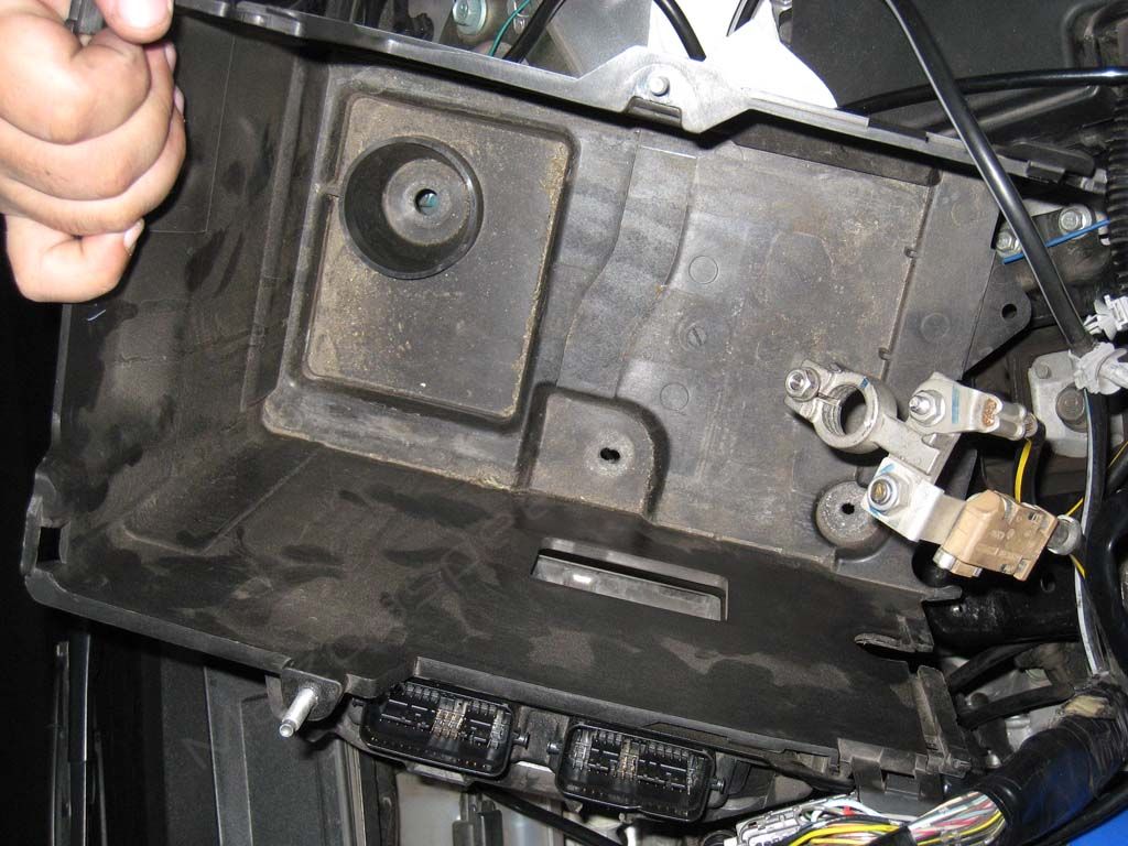

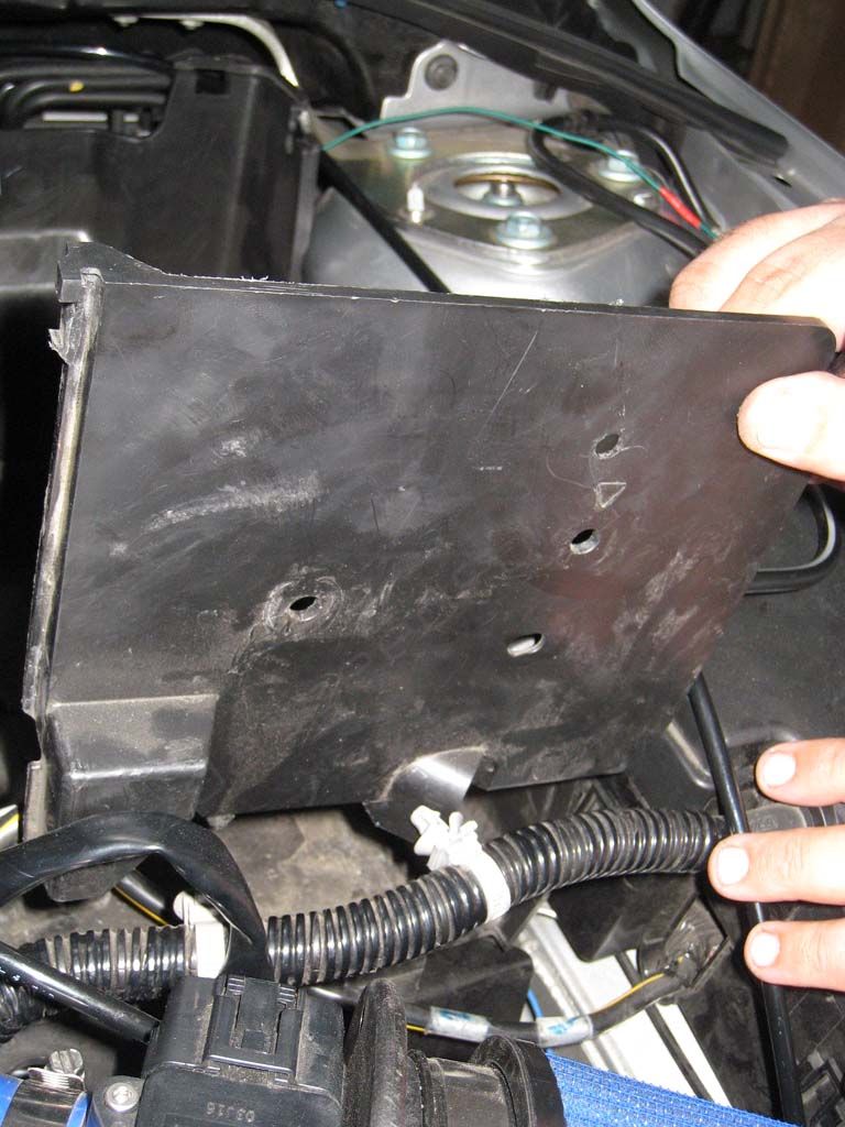

We can now remove the battery box front cover and move it to the side.
http://www.mazdaspeedforum.org/forum/pics...o_inlet/19.JPG
http://www.mazdaspeedforum.org/forum/pics...o_inlet/20.JPG

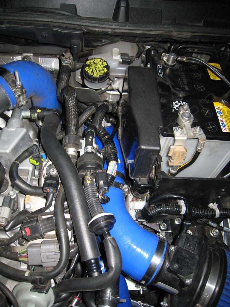

http://www.mazdaspeedforum.org/forum/pics...o_inlet/21.JPG

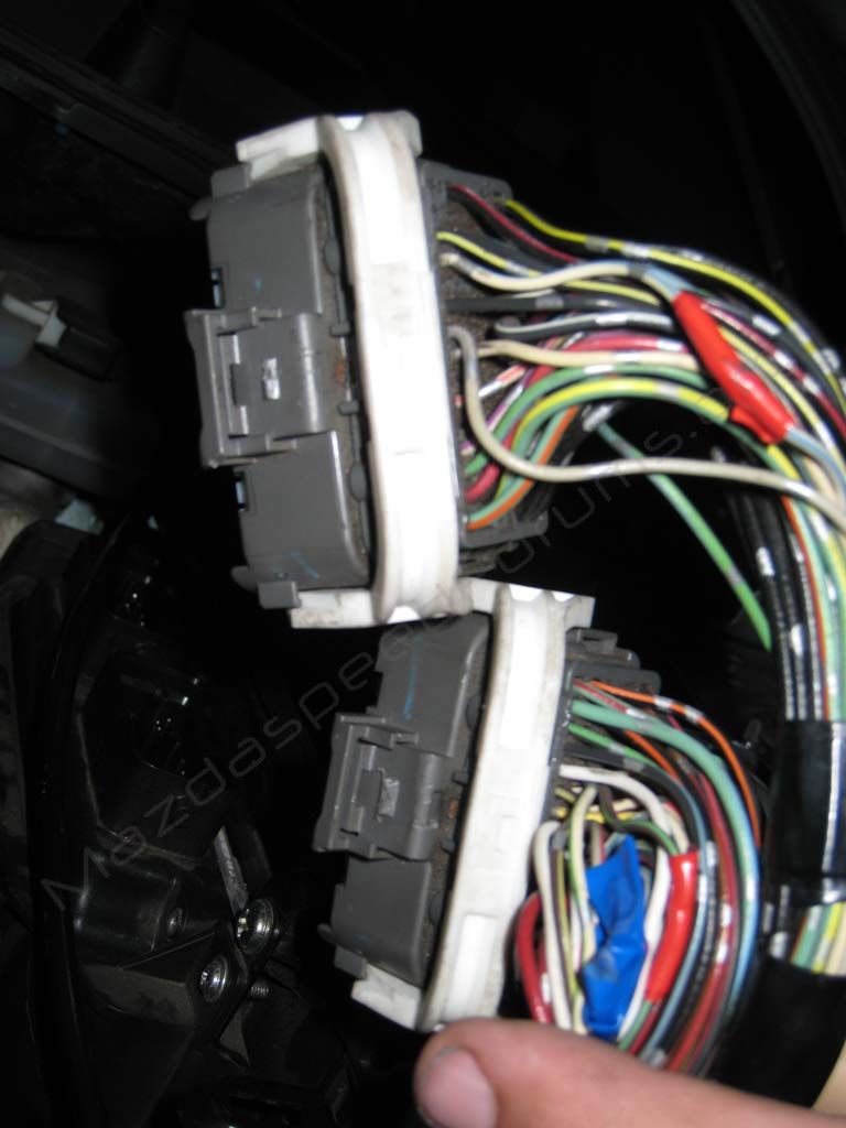

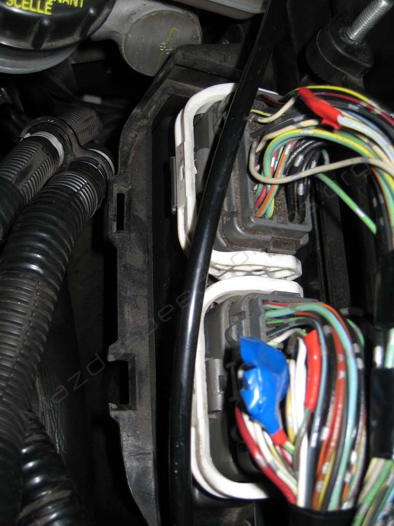

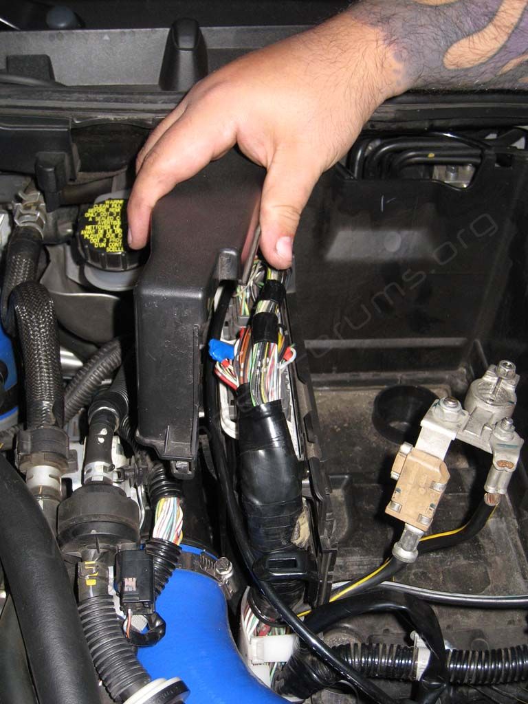

Time to remove the ECU cover. At this time grab your flathead so you can unsnap the ECU connectors from the ECU itself.
http://www.mazdaspeedforum.org/forum/pics...o_inlet/22.JPG
http://www.mazdaspeedforum.org/forum/pics...o_inlet/23.JPG
http://www.mazdaspeedforum.org/forum/pics...o_inlet/24.JPG
Now we have enough room to remove the battery box out of our way.
http://www.mazdaspeedforum.org/forum/pics...o_inlet/25.JPG

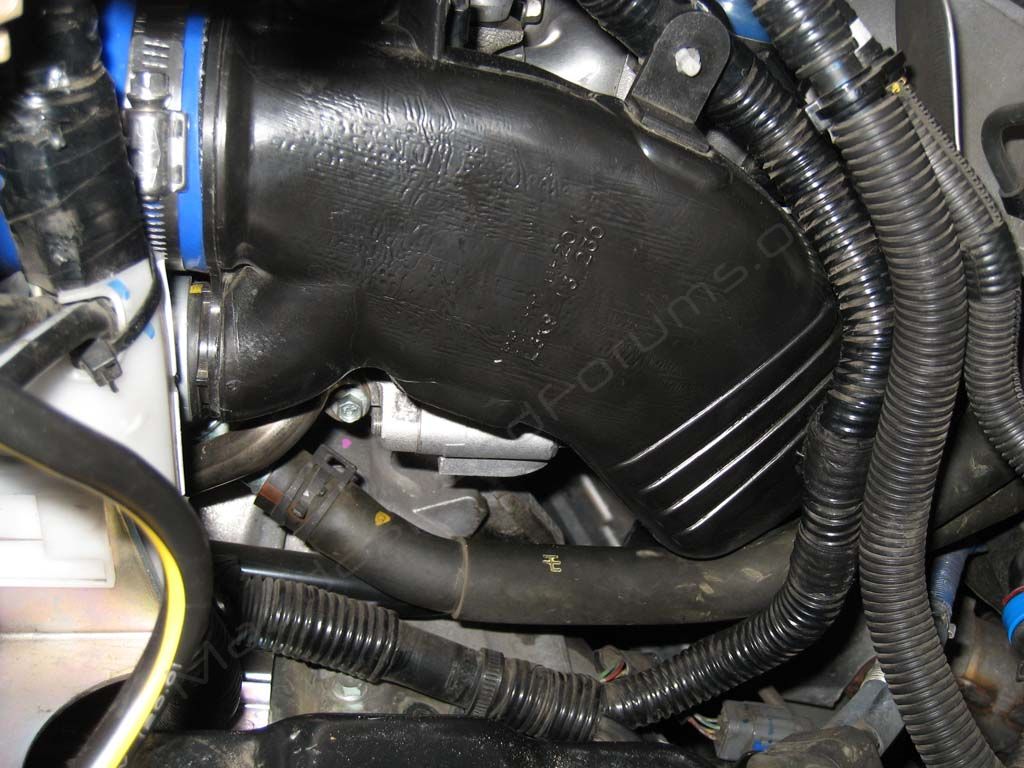

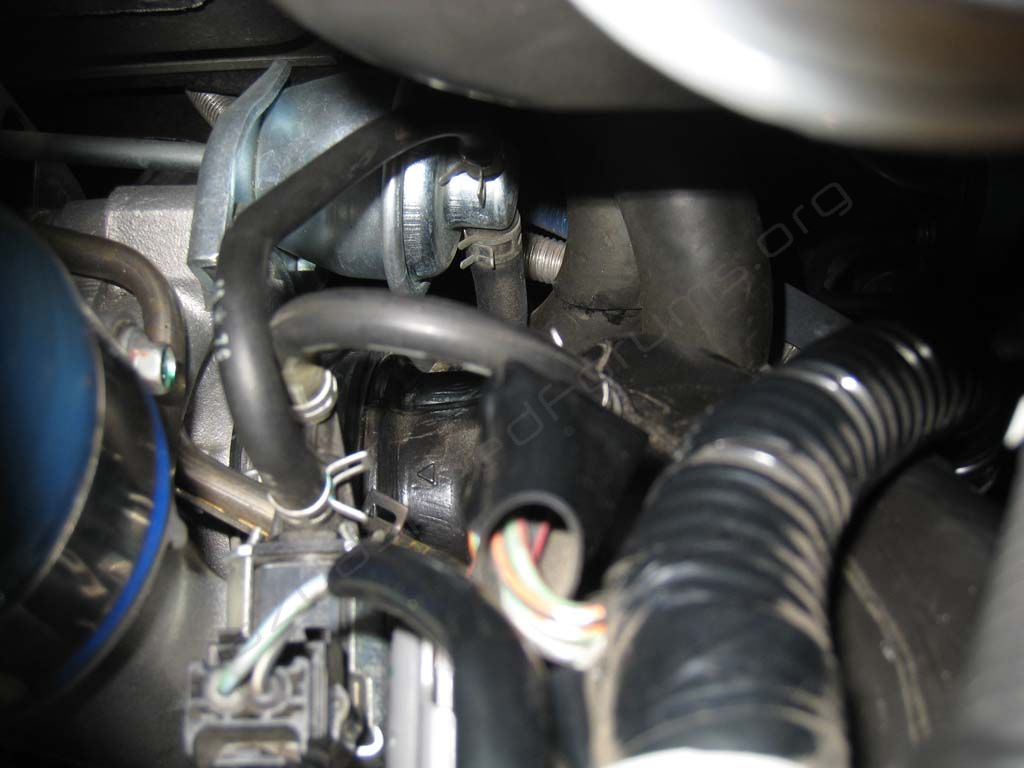

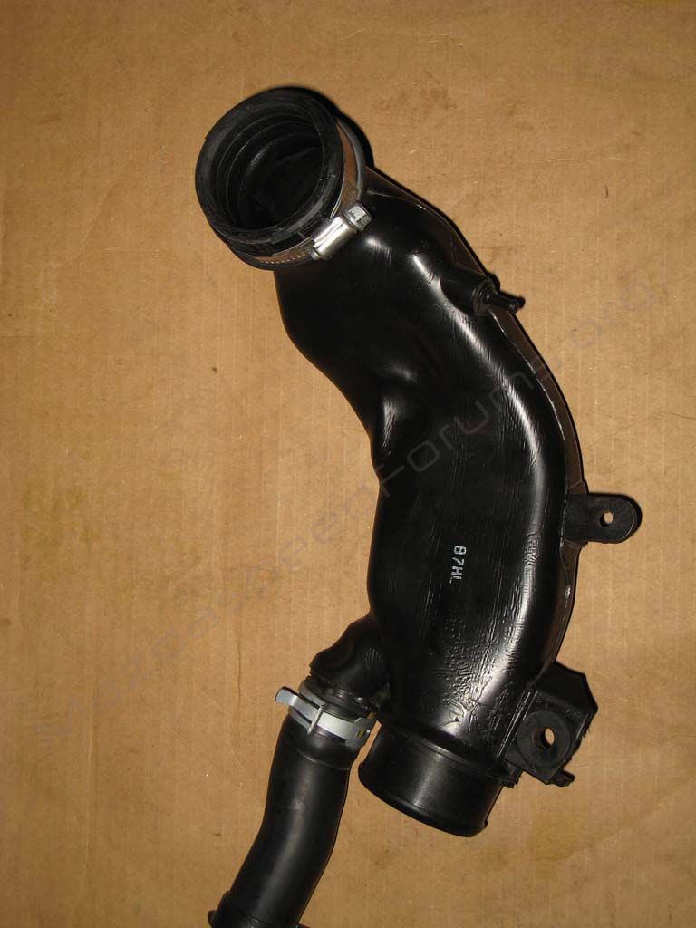

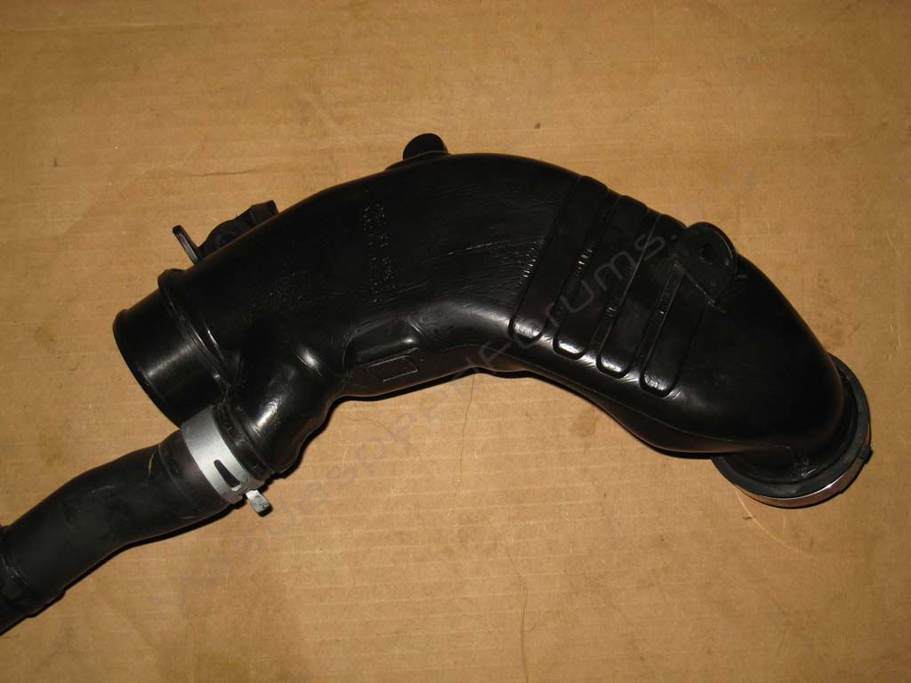

Here is a good shot of the stock plastic inlet piece. More then likely, you could grab this thing and pull off right off your turbo impeller. For those who seem to have some sort of boost gremlin in the car, this may be the culprit, so tug on it for cheap thrills.
http://www.mazdaspeedforum.org/forum/pics...o_inlet/26.JPG
http://www.mazdaspeedforum.org/forum/pics...o_inlet/27.JPG

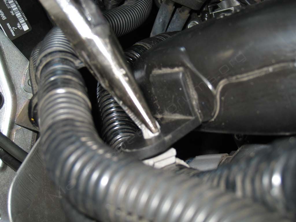

Here is another wire loomp clip we need to squeeze with the needle noses to get out out of our hair.

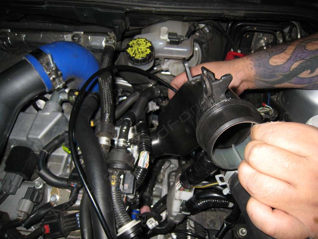

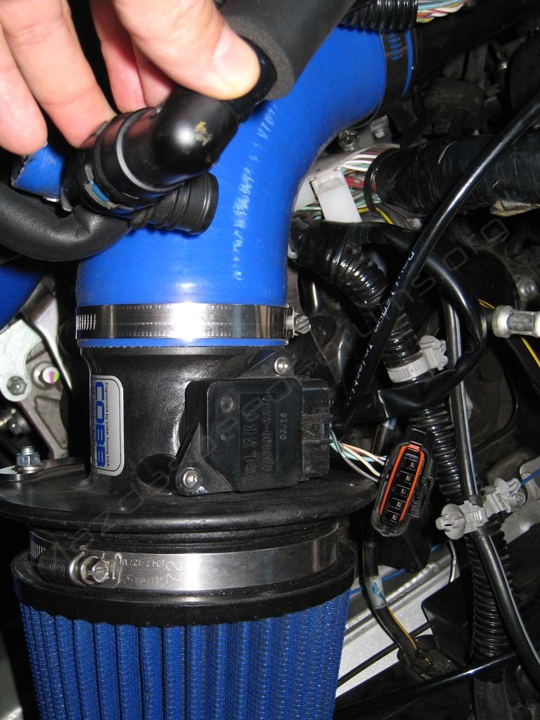

Now time to remove your CAI or SRI intake from the stock inlet. This can be done with a flathead, 8mm or 10mm socket depending on which intake you have.

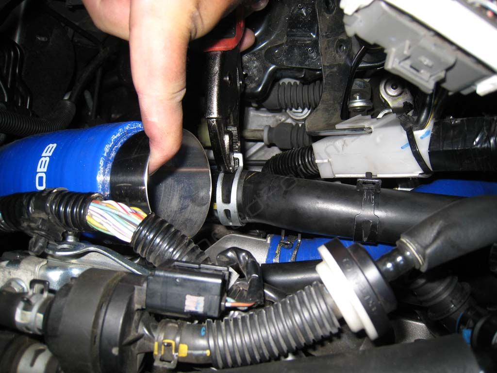

Remove the vacuum elbow using a pair of pliers for the larger hose clamp. Squeeze and pull back. it helps to rotate this plastic elbow back and fourth to release.

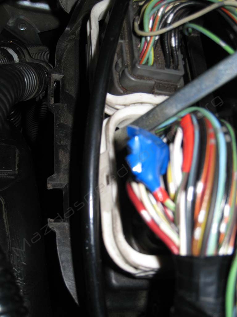

Unclip the MAF connector harness using a small flat tip screwdriver. You will see the lock connector in the middle, so slide the screw driver tip in there to release.

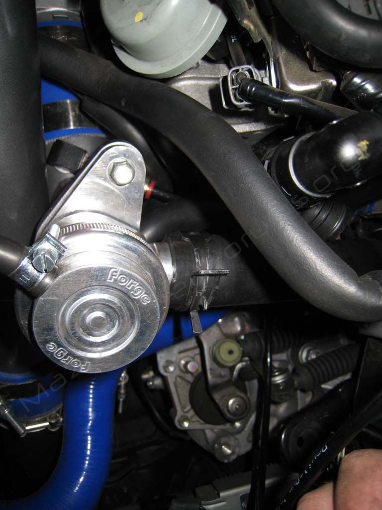

Remove the other end of the bypass hose from the BPV.
http://www.mazdaspeedforum.org/forum/pics...o_inlet/34.JPG

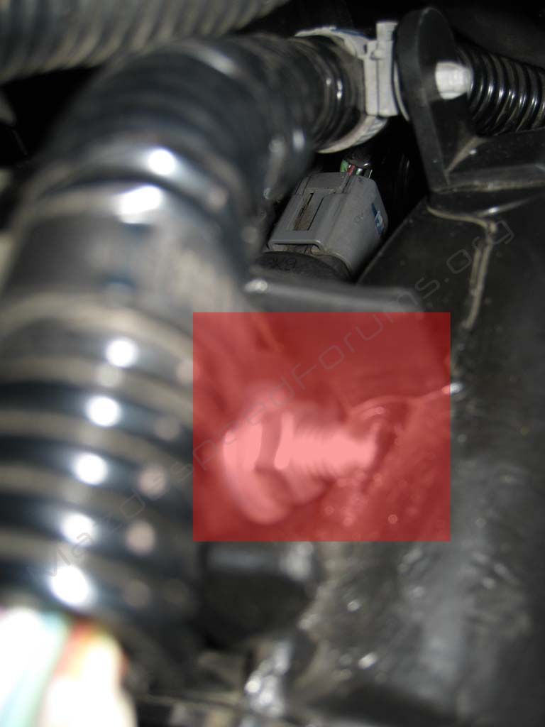

Now, here is one more nut that needs to be cracked loose, its a 10mm.
http://www.mazdaspeedforum.org/forum/pics...o_inlet/36.JPG

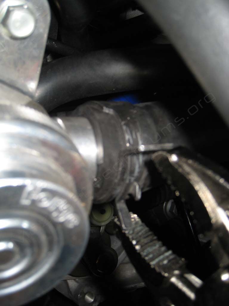

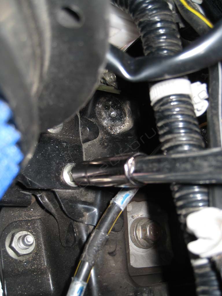

The hardest part of the install is getting the 1/4 drive ratchet in there to loosen the stock worm drive clamp. If you have small hands, this will be an easy task. Big hand, thick sausage finger people wont be as lucky, expect a nick, cut or even blood.

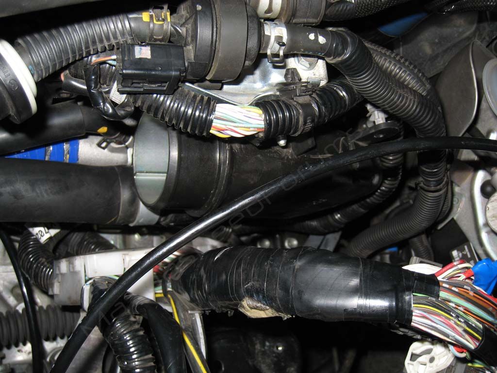

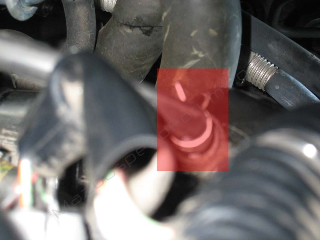

Here is the 1/4 inch vac line connecting to the solenoid. Be careful when removing this as these nipples on the stock inlet break. Get a angled set of needle noses in there for ease of getting the clamp to come lose and slide it up. Straight needles will require a little more body contour, but its doable.
http://www.mazdaspeedforum.org/forum/pics...o_inlet/38.JPG
Woohoo! The stock, restrictive piece of now removed... Toss it off to the side.

Below are some pics of the stock piece. Note the restriction of this box feeding your K04.
http://www.mazdaspeedforum.org/forum/pics...o_inlet/40.JPG

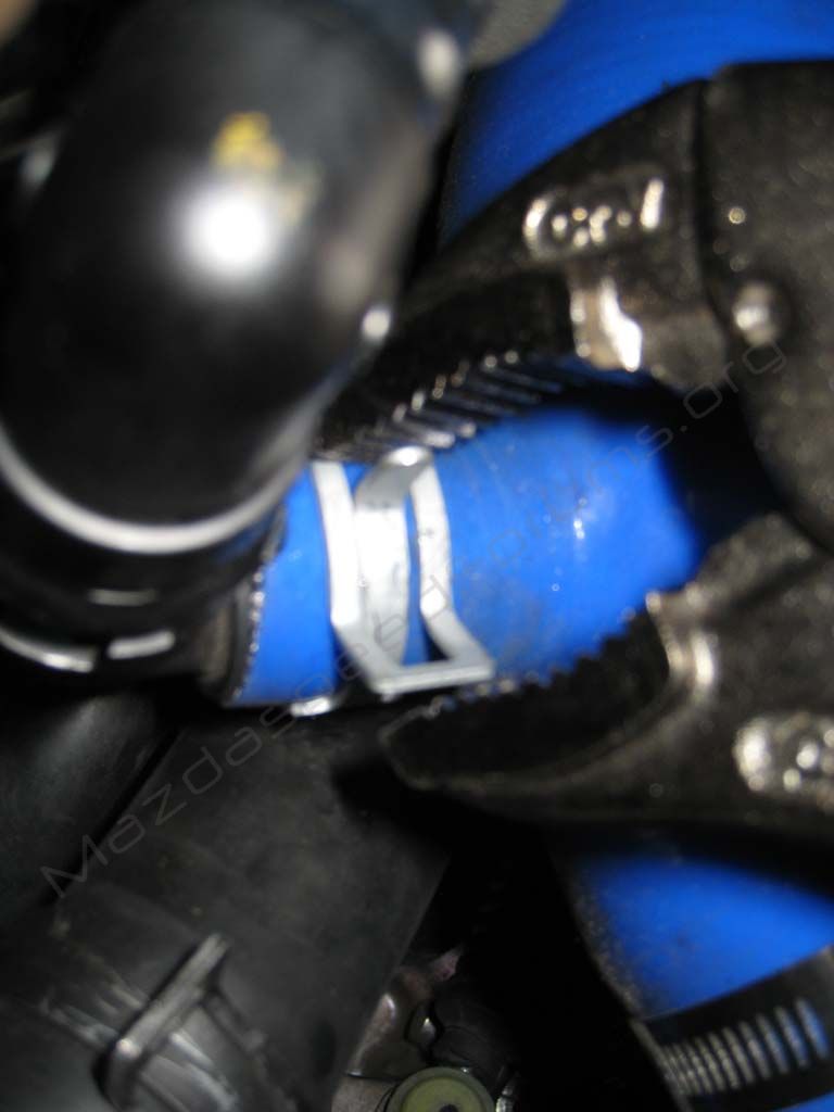

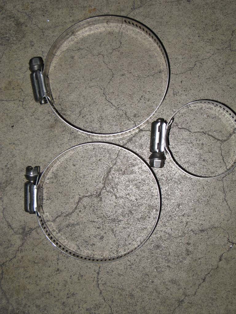

Here's the supplied clamps you will need. The 2 large 2inch ones go on the turbo to inlet connection and inlet to inlet reducer section. The smaller one attaches to the inlet bypass reducer.

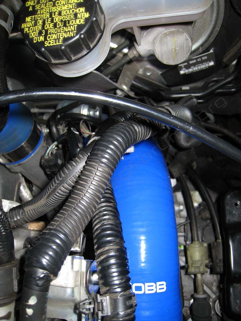

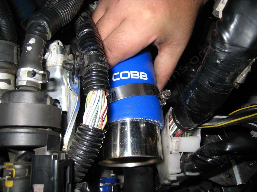

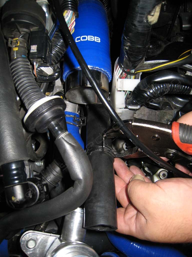

Time to place the inlet onto the turbo and place it into position. Be sure to re-attach the solenoid vacuum line. People sometimes forget this small hose.
http://www.mazdaspeedforum.org/forum/pics...o_inlet/43.JPG
http://www.mazdaspeedforum.org/forum/pics...o_inlet/44.JPG
Connect the bypass hose first if you decided not to connect the hose prior to installing the bypass outside of the car.

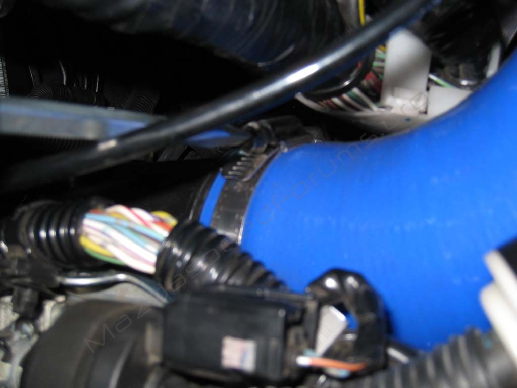

Secure the clamp to the intake reducer side before trying to install the intake back on there.
http://www.mazdaspeedforum.org/forum/pics...o_inlet/48.JPG

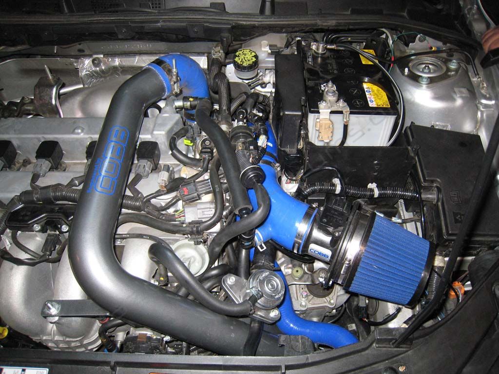

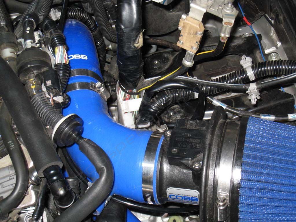

Attach your intake system and clamp it down.
http://www.mazdaspeedforum.org/forum/pics...o_inlet/49.JPG

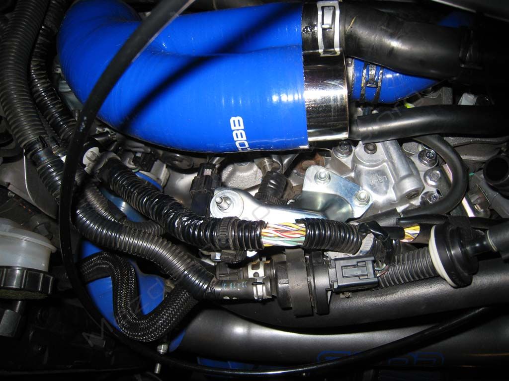

Reattach the MAF sensor connector, 90 elbow, battery box and connect the ECU connectors back. Place the wire looms back in the battery box, reinstall battery and battery cables. DOUBLE check all of you connectors and give the car a good twice over before starting.

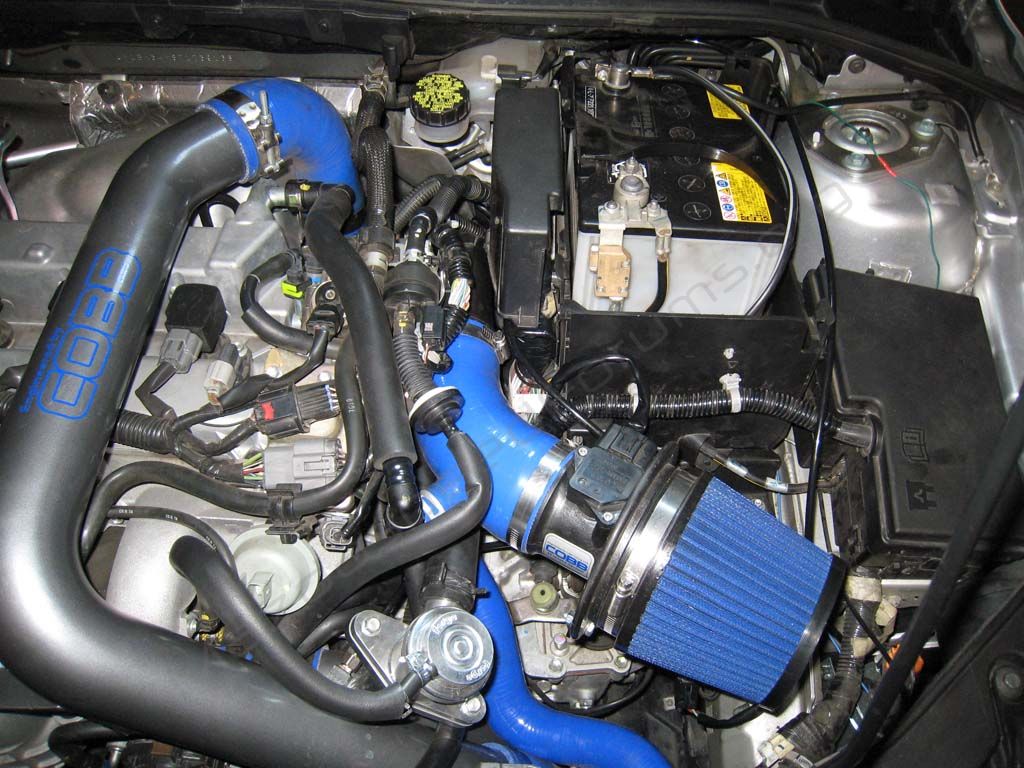

Conclusion:
This is one of the most simple mods to install on these cars. So, what do we gain? Well, although we didn't dyno, there has been some proof from other homemade inlets, these make anywhere from 3-7hp. If it does anything of importance, it allows your turbo to breath. How many times have you been romping the car at full boost, when required to shift to the next gear, you get a sudden delay of power? This inlet eliminates it from occurring. You get instant power between each upshift because boost hasn't fallen so drastically. This is most noticeable when upping the boost up to 17,18 and 20 psi.
You will also notice a slight difference with lowered BATs and IATs with the inlet on there. At only $165, these are a great buy and will give you satisfaction for your purchase.
