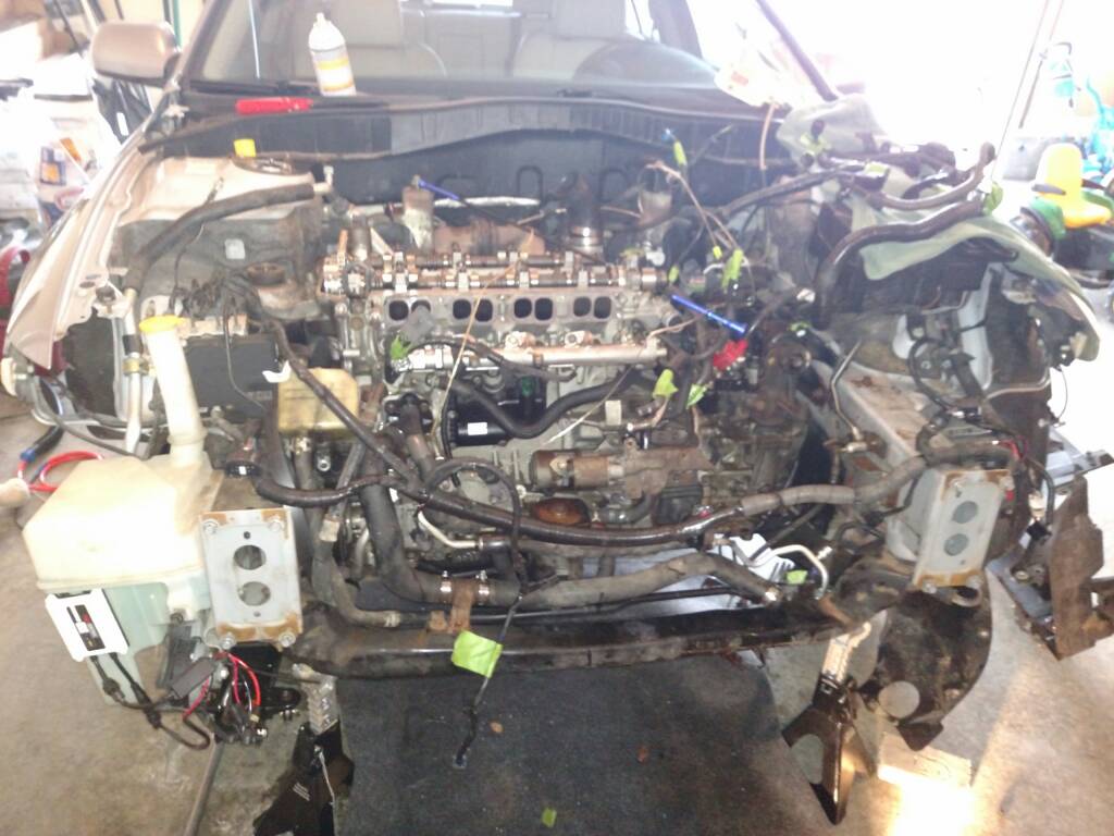

I suggest pulling the front clip off. It just frees up so much room and it's really pretty simple. Maybe it's different from a 3 to a 6, but I wouldn't even hesitate pulling the front if I have to do this again. Just my .02¢
again, mine is a 6, but just an idea of how much more room you free up/less obstacles.

Originally Posted by Elrodd View Post
I suggest pulling the front clip off. It just frees up so much room and it's really pretty simple. Maybe it's different from a 3 to a 6, but I wouldn't even hesitate pulling the front if I have to do this again. Just my .02¢ again, mine is a 6, but just an idea of how much more room you free up/less obstacles.
I agree. She just slides right out. Your neighbors look at you like you're having an automotive garage sale, but it's a nicer pull.

Sorry for the old thrad revival but i was looking for advices about removing the engine from a MS3.
@qtrmile beast you seam to did all sort of speed so i was wondering if a 3 change the way it would be best to do it?
I did see manny removing the whole front of the car but is it just because most of them do it at home with minimal tools ?
I have a lift and hoist in my garage and i pulled few kind of older engines either by the top or by the bottom already but i never removed the front bumper to do it. The speed is the first one i will do with a removeable front so i'm looking for advices if this make it easier...
I already did the clutch on it and i removed the trans alone by the bottom easily but at time of putting it back, it was a pita to pass the crossmember even on the lift. I finally removed the crossmenber and everything went fine.
That trans is beaffy so my plan is to take it in and out with the engine that time.
the three is much easier than the six. I would in simple form pull the axles and then the mounts and then exhaust. And since you have a lift I would see the motor and trans, once their loose, on jackstands and then use the lift to raise the car over the motor. No hoist needed!!! Need more detail just post here and I will help you the best possibly can!!!!!!!
Thanks i will try it like that from the bottom and lift the car, it is how i did my last klze install.
I'm not worried about anything else but disconnectiong the AC. Let that gaz go into atmosphere and pay to get it refilled when i have other options...
I have air tools and most of the bolts to remove already have anti-seize on them...
