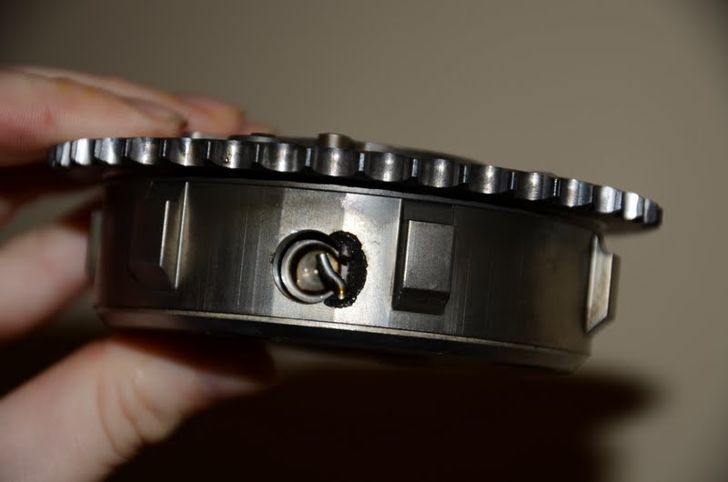

  29. Remove your intake cam, bishes, and follow FSM steps for removal and replacement of VVT Actuator
    I didnt remove the intake cam. Rather, I removed the chain and removed the bad VVT (pictures below). With the timing chain off, I installed the Cam Alignment SST and set my timing. My cams were about 5-10 degrees off. With the SST, they were religned. Make sure that you note the orientation of your old VVT when removing it. There is a specific orientation that you must take into account when you install your new VVT. There are holes in the camshaft that you must align with your VVT. As I understand it, this allows oil to enter the VVT and is critical to function. As will all of these bolts, torque to spec

Here is a picture of my broken VVT
