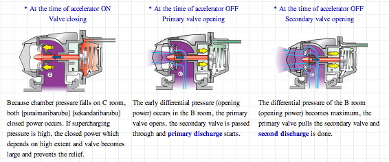

so i am running an hks ssqv in recirc. at lower boost there is a flutter, and i know that the flutter sounds i associated with compressor surge. i have read a lot of places that sometimes the hks valve makes this sound. just wanted to know if anybody else gets this flutter? is running recirculation what makes this sound?

I just installed mine, my recirc hose collapsed due to it bending too far. so i had to cut it and put a 45* fitting in it. helped but the valve still flutters. I called hks directly and they said that is the sound the valve makes. it sounds like this: @ 20 & 35 secs or so
sounds like the valve opens 2 or 3 times. The way hks explained it to me was the primary valve opens, then the main valve hence the double or triple sound. real surge sounds the same but lasts a lot longer (few seconds)

Valve flutter isnt the greatest, but it wont hurt anything. The valve just opens and closes a few times.
for HKS to say that this is "just a sound" that the valve makes is BS. Whoever you talked to doesnt know shit.

this may help
