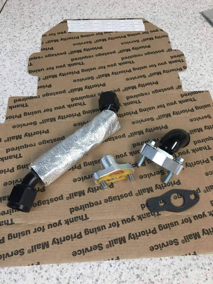

First off thanks to CodeMonkey for finding this. Just spoke with Brian at BNR and he says he has no issues with selling the drain kits separately from the s4 kits. For the time being it looks like you'll need to order directly from BNR, but I'm guessing Edge/etc will start offering the kit as well. I have mine on the way, so I just need to cry a little and put my big boy pants on to go pull the stocker off for no reason other than community love... Code Monkey should also have some fit/function feedback as well.
I think the kits are around $90 and well worth the money for those of us who have had emotional breakdowns over the stock line. Should make turbo swaps a dream. The big thing that makes these special is A. the block adapter and B. the flared ends that will prevent leaking like you get with just cutting the stock pipe in half.

len - yes it fits the ms6, check codemonkey's race car thread last post he has pics of it installed.

Any update on a part number for this kit?
Can someone easily email BNR and just ask for an oil return line kit?

yep, just send bryan an email and he will get you squared away. they are not listed on the site.

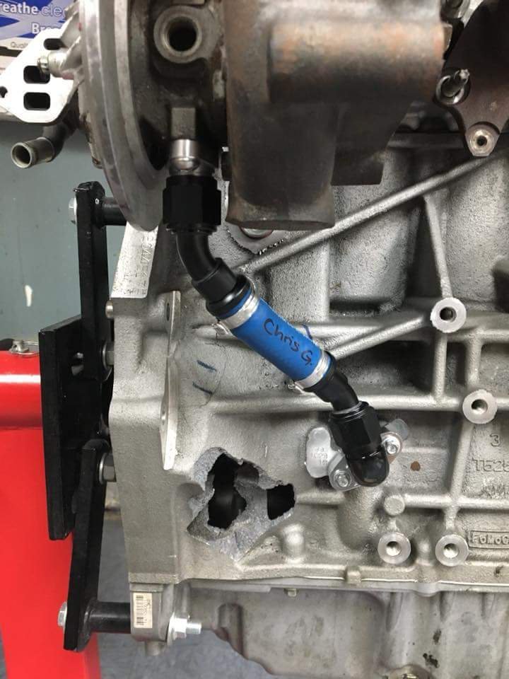

For pretty much the same price, why wouldn't you just get one of the nice ones that Eric makes?
Sent from my SM-G955W using Tapatalk
Who is Eric and how much? Is this helpful for any turbo install or specific ones? I have a BNR S3 to install soon.
What caused that block to vent?
because I doubt that one would fit the speed6 xfercase clearance, and the bnr is the only one I am aware of that is confirmed to work with the speed 6. There are tons of solutions for the speed 3 guys, bnr is the only one to date verified to fit a 6.
Erik's fit the speed6, and he's got versions for most (all? I'm not sure) of the major turbos.
http://m.facebook.com/groups/5397232...57452284299016
His pictures, idk. He just uses it for mock-up's.
He made it specifically for the ms6, it fits the ms3 by default. He's been doing it for quite some time....

He's all over the fb groups; a ton of people are running his drain lines and wire tucks.

File Type: jpeg 14FF3887-825E-4EBE-854B-D72FA979DD3E.jpeg (582.8 KB, 41 views)

I spy tc’s
File Type: jpeg 22BB28D5-3275-41B7-93D5-911C60BB2FBF.jpeg (403.0 KB, 30 views)
File Type: jpeg 46E97D44-736F-4780-989D-6EED978B0A22.jpeg (326.1 KB, 26 views)
File Type: jpeg 3974CB1D-9FAB-4851-B516-CBE6E631A021.jpeg (491.9 KB, 28 views)

Has anyone used the bnr drain line kit yet? I trried installing my S5 into my 6 yesterday and it was a huge failure.
Bottom bracket's spout rests on the transfer case. Upper brackets spout rests against the ewg of the hotside.
Not sure how they mocked this kit up but I found no way to get it on.
Sent from my Pixel XL using Tapatalk

So looking at Code Monkeys pictures I see my issues.
Red circle on my car was sitting against the transfer case. so no way to get hose on it.
Yellow circle is the fitting that I needed to allow the angles to be right. The BNR fitting goes straight down and when you try to make the line connect it kinks the hose there.

Here is how I ended the night at 2am. I used the upper BNR fitting and a cut stock drain for the block side. Hose is kinked closed.

Little Update: Got all the parts in to make the line. The Turbo and Block fittings are top notch for sure. Going to be installing this afternoon so I will update how it goes.
File Type: jpg 00000IMG_00000_BURST20180629214446_COVER.jpg (2.20 MB, 15 views)

Thankfully you guys won't have to wait much longer. I already fabbed a -10AN line for the S5 and S6. Bryan was good enough to loan me a hotside for both so I could do so.
