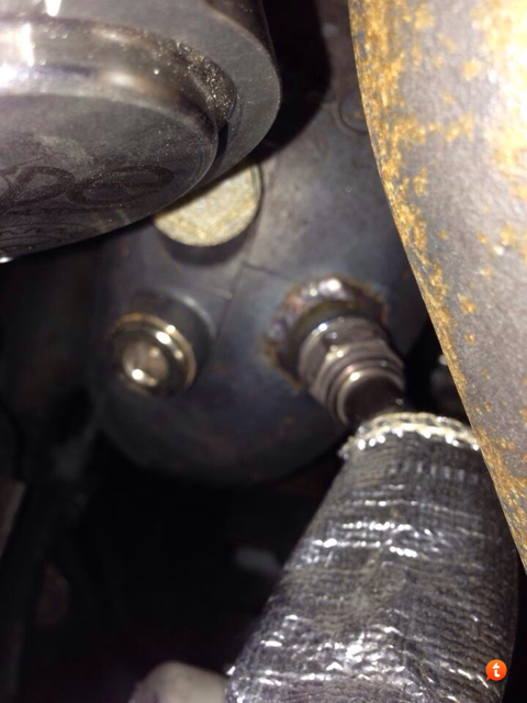

I have the V1 UR DP. I do have a second bung welded in, but the O2 sensor in either one would not have been in the way. the only issue, if you can call it that, was securing the wiring away from direct heat sources. couple of zip ties did the job. No issues.
Originally Posted by illegal shishkebab View Post
hummm I'll take a pic of mine and post it.

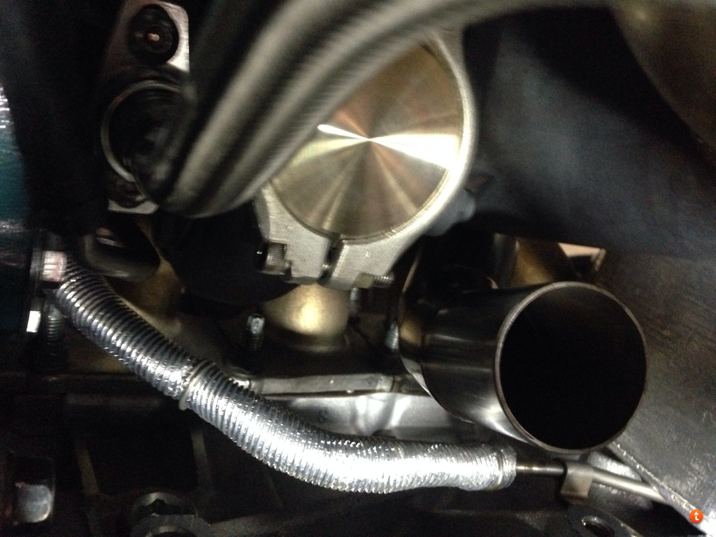

This is the solution for cpe downpipe, new welded o2 bung, but I got new custom dumptube

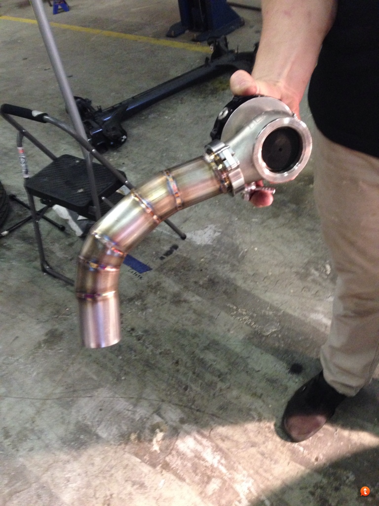

from Davids Facebook.
"Kozmic Vband Mazdaspeed3 downpipes in stock. Made for cpe precision vband manifolds. Full 3" non cheater cut outlet. Full stainless construction, 3 sensor bungs (relocated not to be in the way of dump tube) with one plug included. With ss flex and flanged to bolt up to oem or aftermarket cat backs. $539 plus shipping. In stock and ready to ship. Options for high flow cat and ceramic coating are avialable"
I'd call them up if I were you Rob. @rfinkle2;
Fitment might be a little off on a garrett, but who uses thoughs POS turbos anyway!?!?! haha jk jk

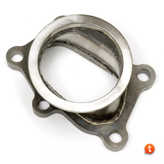

You guys have any idea about this ^^^ will it work with kozmic DP ?
Unfortunately this downpipe would have to be modified to run on a garrett turbo. Garrett turbo Vband flanges are different then a Precision, you would have to have the flange chopped off and have a new Garrett Vband flange welded back on.
The piece is very top notch quality, it was designed around running a Precision Vband inlet/outlet housing turbo on a CPe manifold.
Sent from driver seat, bro!
tapafuck....
The entire downpipe would have to be modified for that too work Iboo. This would extend the downpipe off the turbo further causing lower fitment issues with clearance etc!
Dang (( I is sad :///
Well I will get it when I go to precision turbo, of course after ZZB
So the litter flapper door thing to the far left is where the SSP dump tube would route too with the Tial-MVR WG. large amount of space between the tube and o2 sensor.
2.0t03speed likes this.

Kozmic Motorsports Precision V-band Downpipe at EdgeAutosport
Speaking of the devil.

Will the kosmic pipe work with TiAL hotside? Provided you use TiAL clamps?
"Exclusivity" - CP-enis

Will the cosmic pipe work with TiAL hotside? Provided you use TiAL clamps?
David said he will be making a downpipe with a TiAl flange so I would guess no.
2.0t03speed and LumberJack like this.

Guys,
The CP-e Downpipe does WORK with the manifold (ask me how I know).
The O2 sensor has no issues with hitting the wastegate.
It is the SSP (actually Kozmic I believe?) dumptube that interferes with the O2 location, which they obviously could not forsee.
Also, the Tial V-Band housings are a different matting surface on the discharge. A PTE V-Band discharge flange will not mate up or create a seal.
LumberJack likes this.
