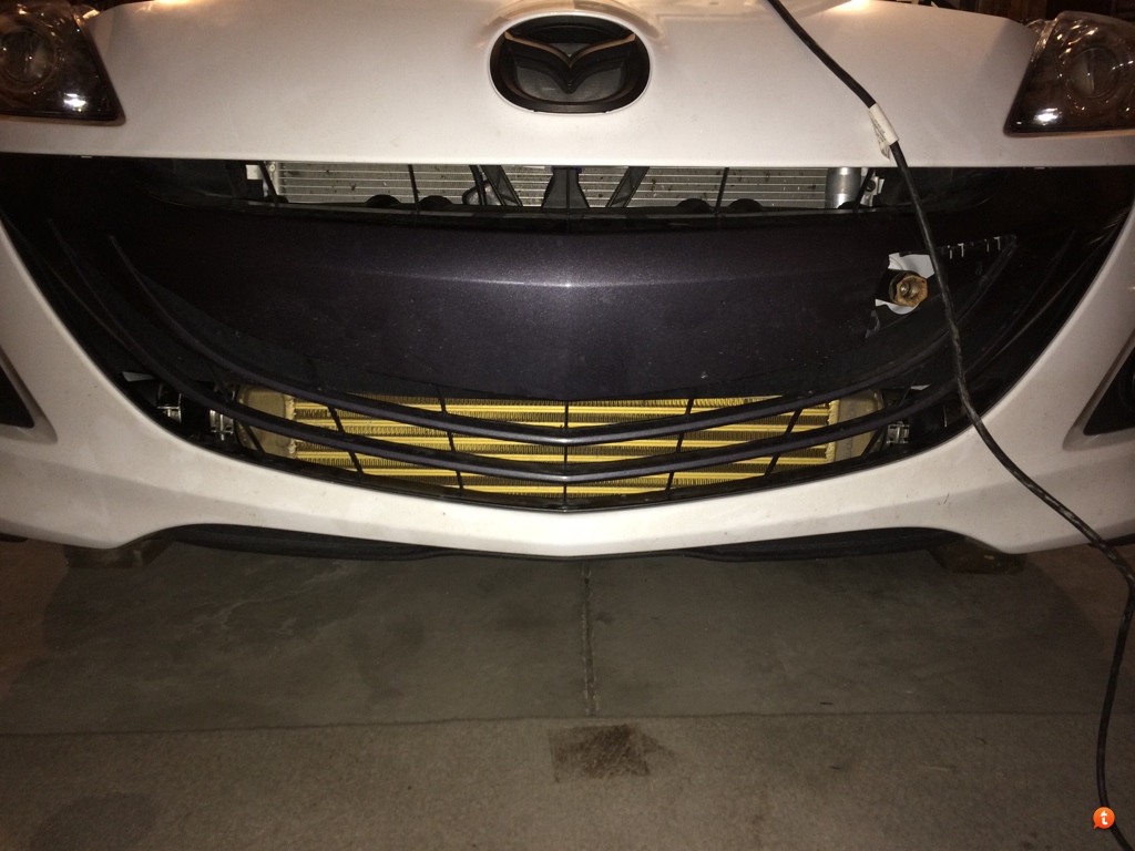

I just had a protracted discussion about the merits of this video with some people in my local facebook car-modding group. Here's why I would never paint my intercooler:
This won't really work for you if you've got a top-mount, as it'll absorb more heat from the engine than it normally would. Black is also extremely efficient as a radiation absorber. Moreover, in order for the emissive characteristics of a black intercooler to be additive with the convection/conduction characteristics that the device already has, the "paint" itself needs to be thermally conductive. In other words, it's probably better to have a black-anodized or powder-coated intercooler than it is to have it spray-painted.
It's also important to note that the coating is more likely to serve as an additional layer that decreases the surface area-to-volume ratio of the intercooler (this is bad for the efficiency of a radiator of any kind). If, on the other hand, the intercooler itself was made of Silver, Copper, Gold, or Aluminum (which most of our intercoolers are), then it is probably pretty efficient to start with, and our best bet is to try and a) improve flux through the fins, and b) reflect radiant heat away from the intercooler. Basically, it comes down to "no coating" is better than "any coating".
As far as heat soak is concerned. If you've got a front-mount, then the likelihood is that you're not going to suffer from this too TOO much. On the other hand, my ETS TMIC will heat-soak pretty quickly with the hood shut and the car stationary. If I'm moving at even a ~20-30mph rate, the intercooler will remain cool to the touch even on a hot day.
Finally, and perhaps most importantly, unless you're waiting in line at the strip, or at an AutoX course, then all of this is pretty much a moot point. The most important, and interesting, part of the MCM video is the fact that with air passing through the intercooler, the impact of the black paint was negligible relative to the effect of the air passing through the fins.
If you watched the video, you would see the awesome way they painted the core to make sure as much of it was painted as possible. One of them was spray painting while the other used a leaf blower to force the paint in as far as possible.
I wonder if you painted the underside of a TMIC white (to reflect heat from the motor) and the top/sides black (to shed heat) if that would be a better way of doing it?
I had the end tanks, sides and bottom edges of my ETS TMIC wrapped in reflective gold tape. No clue if it made a difference but I like the space ship look!
Like you, my end tanks are Reflect-a-Gold wrapped as well. I did some relatively non-scientific testing (not enough trials for there to be any significance to the results), but it looked like my BATs dropped by a degree or two in traffic, at idle, etc.

I had to repaint my spearco FMIC as it was shot so I wire brushed all the paint off the cast top and bottom and the "things" that the air goes thru between the exposed fins (sorry brain dead).
Time consuming but then went and covered all the fins before painting because I did not buy the special paint. After coating everything well I did a few light passed with the fins exposed.
Came out great but I would not have painted the whole thing without covering exposed air cooling fins.
I dont think it would make a huge difference but enough pain and will be less room for airflow and less cooling along with heat transfer issues between fins to paint to air.
And the whole black thing does not make any sense, but ive no reason to get into that. Paint it white and try the argument.
