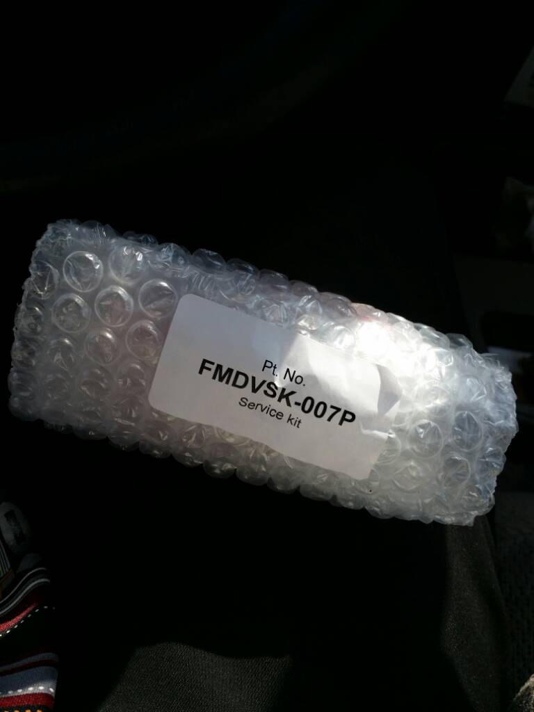

@Jeff23spl;
Give it 6-10 days to get there.

OH already ship !
