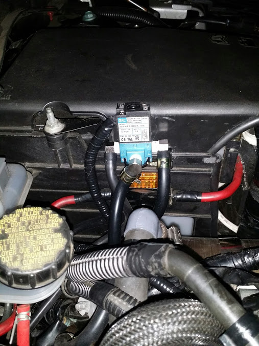

ImageUploadedByTapatalk1411523054.012088.jpg here's mine... Just installed it tonight... Car runs like a champ

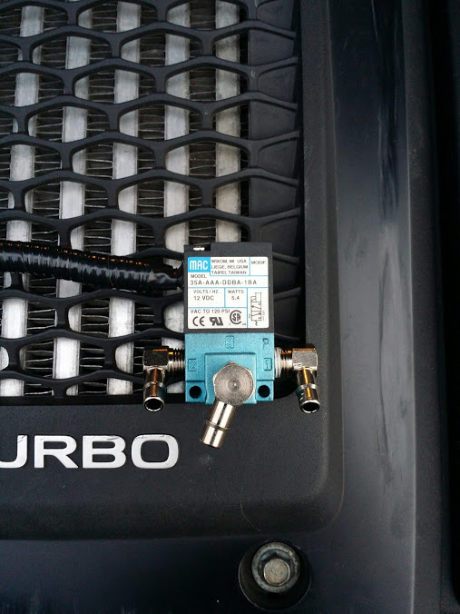

instead of a pigtail you can get just a plug and put it all together by yourself :
Tyco/AMP Econoseal J Series Mk II Motorsport Connectors - Corsa Technic
this is 174354-2 from Econoseal J Series Mk II
I'm 99% sure this will fit. will confirm in a week or two when I have mine installed.
edit: the link above is an example. I didn't buy from this store, there is a lot of suppliers locally.

OK. the plug / connector works. Anyone who wants to save 5 more bucks on the project - this is the way to go

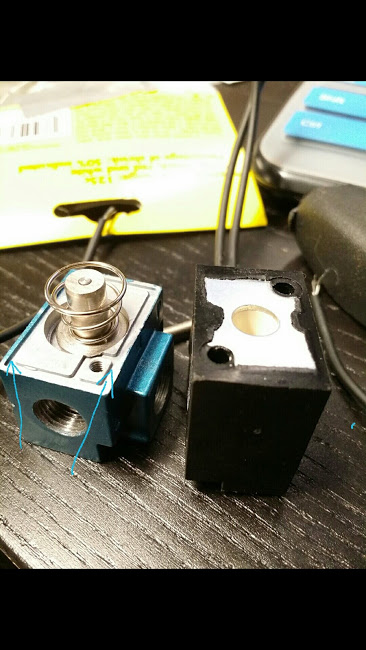

As a side note, does anyone know if these little paths in the bottom part of the EBC do anything?
I was worried about the seal to the top part so I put a very very minimal amount of silicone there to provide a light seal so that that there is no air coming through the plunger opening affecting the ports... but now I wonder if those paths are there for a reason. It really does look like there is a gasket supposed to be there though... kind of like the OEM BOV flange gasket.
Finished product:

Partial solution - I did have the hoses mixed up somehow. After hooking them up, I am able to maintain boost of 17.5 as targeted, BUT:
Only until 4,300 RPM. This is where WGDC drops to 0 again, while boost stays at 18psi tapering off to 16.5 at redline.
This feels like the restrictor pill is perhaps keeping enough pressure out of the WG diaphragm to avoid opening it when necessary to keep the boost down. I just don't have another explanation right now.
Anyone chime in to confirm?
UPDATE: Switched boost source to tee off the BPV valve, as per CS instructions. Now I am making boost properly, but have trouble getting it over 19psi between 3.5K-5.5K, my WGDC commanded values are into the low 50s now, which I thought wouldn't be the case with a 3-port EBC. Regardless, it's working fine now, the WGDC curve just looks a big different than the OEM one.
