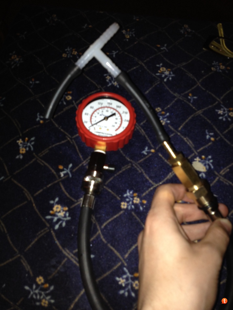

@Fjager; I rigged up this bad bitch and got somewhere between high 40s/low 50s for a pressure.

Nice. That's not bad at all from the stock pump. I saw some 40-60 PSI mister heads, that makes it interesting now. I've been looking all day for a damn pressure switch that isn't too expensive or from china that will take forever to get here lol... to make the system automatic and consistent.
