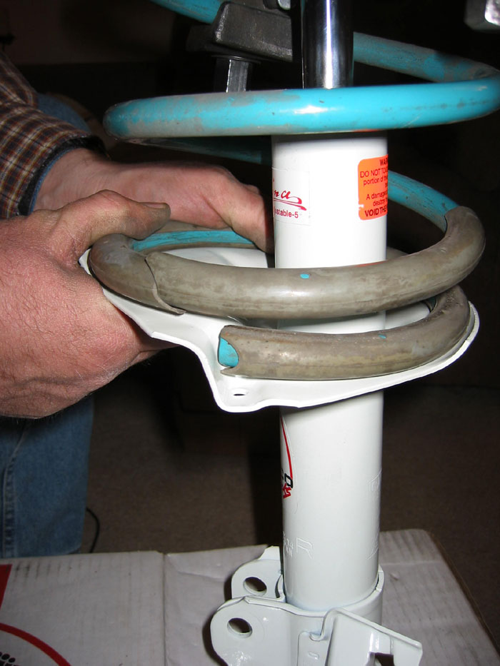

H&R CO:
Sent from surveillance van #2

Doesn't look like the Corksport MS6 springs have been mentioned on this thread, so here is what they look like on stock wheels. The ride is nice, not harsh. Serves well for a bar hopper, havent's taken it to the track yet. I like the look.

1.5 and 1.6R drop. Did they say what % increase in stiffness? The Installation pages showed the rear bump cushion removed, is that what you did?
It appears CS no longer carries the big 25mm rear bar. Too bad, with an extra hole added, it would be the stiffest bar available.
Car looks really nice .

I do not recall CS indicating what the % increase was, it just seems slightly stiffer than stock. We did not remove the rear bump cusion.
And thanks, I really like it too.
