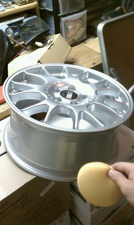

yeah, im using that opti-coat on my BBS's i absolutely love it. ive never went to powerwash or high pressure wash my rims, so i dont know if you can actually just spray the brake dust off or not.
but i do know, you can just spray water on it, and wipe the rim down and it takes it right off. and also, i have never EVER seen water bead up like it does when they are clean.
and as far as trying to get an even coat on them... i was nervous to do it with mine too because i didnt want them to turn out like shit.. but it is ALOT easier than what you think it is.
i mean, i have only had this rims on for like a month and a half so far, but as of now, i really dont see myself ever having an issue with brake dust that i cant get off.
-----also, to help with the long term brake dust accumulation.. if you are running stock brake pads, that would do it too. i switched to HAWK high-performance street pads. they aren't supposed to shed as much dust as the factory pads. and so far.. i definitely believe it. my front wheels actually stay somewhat clean for a while.

nah.. it is actually just a liquid that you squeeze (NOT A LOT---only a couple drops at a time) onto that sponge applicator that you can see in that picture (it is included) and rub it on. extremely easy to get an even coat.
it then starts to get tacky and harden. and even if you have some streaking when you apply it, it says that during the curing process, it will flatten out smooth and it dries clear. and it starts to cure within minutes.
i did my whole rims, the face, the sides of the spokes, the barrels.. everything. i figured, ive got the stuff, why not?
but the thing with that is, if there is some dirt on the rim and you coat over it... you're never going to get that dirt off then. so if you do this, make sure they are as clean as you always want them before applying it.
