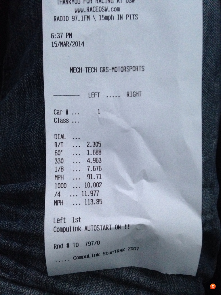

Default First 11 sec K04

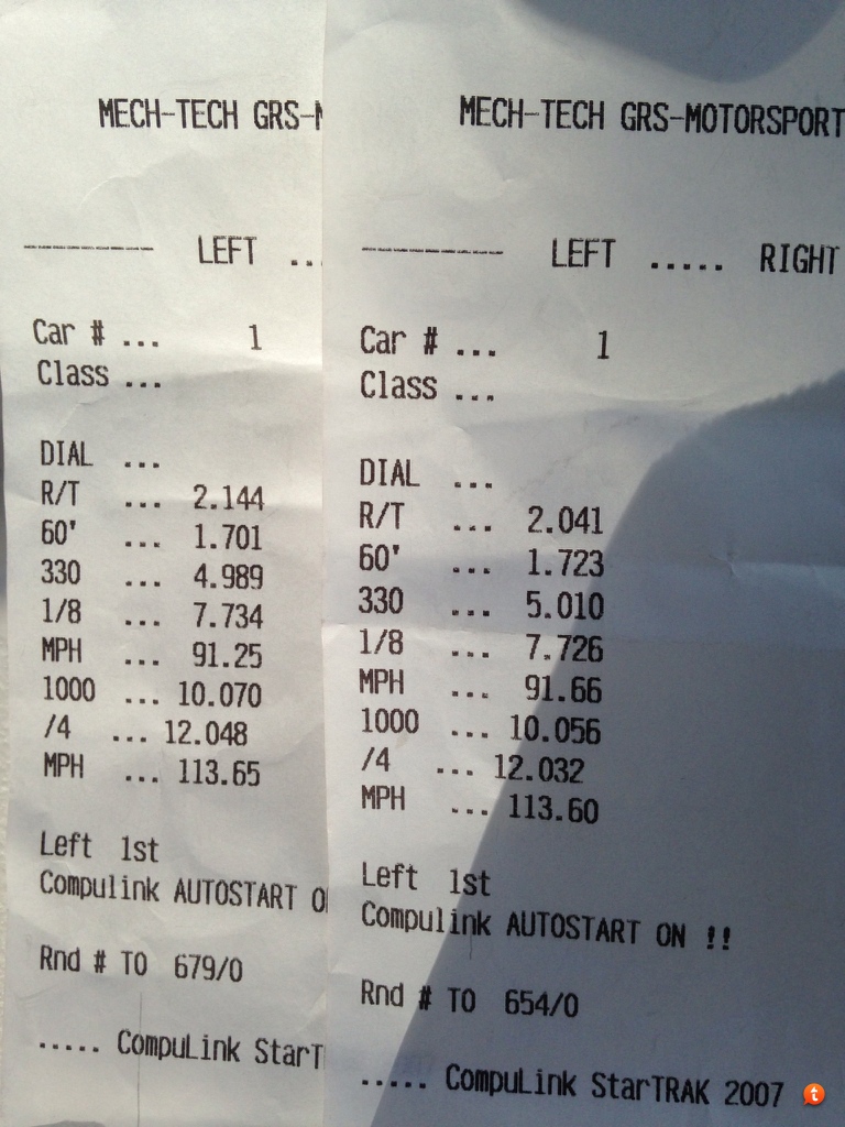

Took about 10 passes, and about six 12.0xx with 1.69-1.72 sixties until I was able to get it all perfect for one pass.
I'll have vid hopefully tomorrow.
*added in car vids, gopro died before 11 sec pass, all these are 12.0xx with 1.70-1.72 sixty foot times.

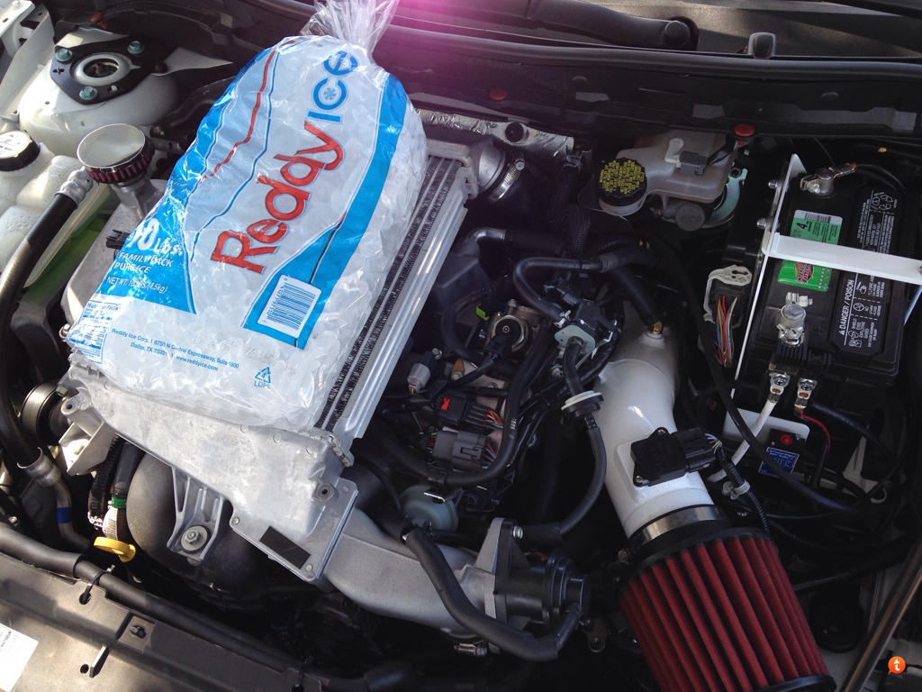

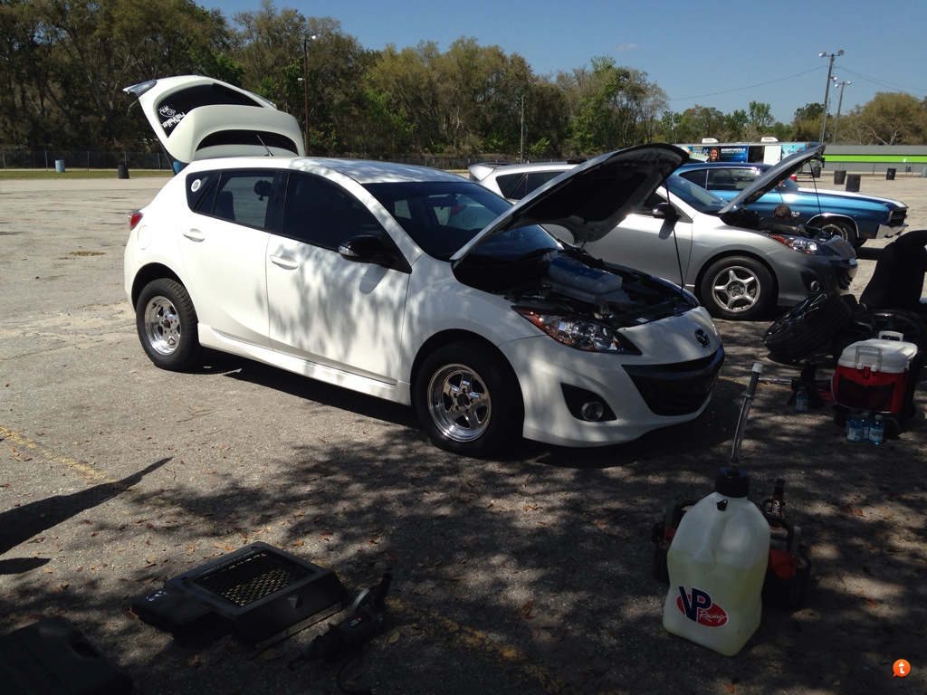

Mods are, HTP 3.5" intake, cat less open m2 dp, 3 port boost solenoid, rmm, weight reduction, slicks/skinnies, 50/50 e85 tune by @snailD;
*EDIT-forgot to mention in my mod list, air lift bags in the rear springs, running 85psi, and just for @He Hate Me; autotech hpfp internals

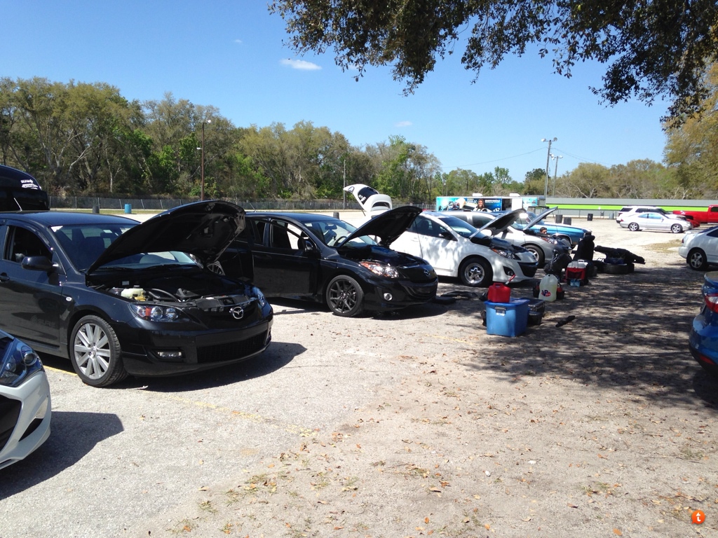

Still on stock tmic and bpv. Had a track rental, thanks to @Livingframe; for making it happen, day wouldn't have happened if it wasn't for him.
Track prep was top notch, weather was good, DA was around +1200 most of the day. Air temp was mid-high 70's. I'll have more info tomorrow, I'm fuckin exhausted.
