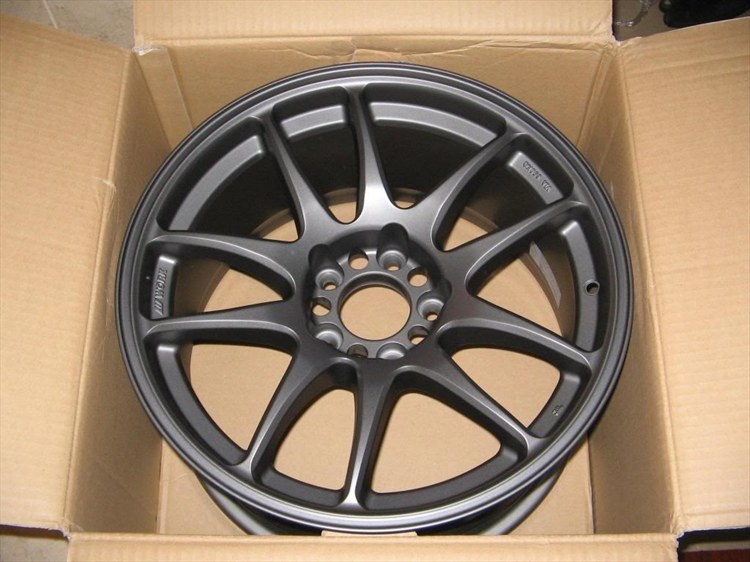

Here are some of the little parts for the Car. I will post pictures of the 14" 8 Piston Brakes (Front) 13" 6 Piston Brakes (Rear), Engine, Trans and upgraded turbo.

My Current ENKI CDR-9 = 24 Lbs @ 18"
The New Work Emotion KAI = 16.1 Lbs @18"
Saves almost 8 Lbs per corner.
- 32 Lbs of Rotating Un-Sprung Mass...
Work Emotion KAI
RT-615 225 40 18
Brian MP5T is offline   Reply With Quote

New Rims from my Trip to Toronto. They are WORK Emotion KAI, in a non standard Finish, Semi Gloss Black. They are about 9 Pounds lighter (Each) than the other rims, and the tires are 3 Cm Wider than Standard. Big thanks go to Scott (TO Protege). They need to be rebalanced with the weights in a different location, there is 4mm-6mm of clearance from the caliper to the Rim. LOL The weights will not pass between.
