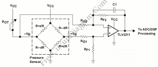

On the characteristic curve graph... it does show the dotted line to 4.8V, and translates to upper area for signal range... but i'm not sure if this is evidence enough to say it'll read that high.
I'd like to see some SB logs with some readings over 4.5 V.

If anyone has a spare sensor taking it apart is not too tough. There is a pressure transducer in the tip (variable resistor essentially) and a potted PCB inside the casing.
In heavy duty applications all sensors must be able to take above battery voltage even if they are rated for 5V and not break. This is a safety and reliability requirement and I am not sure if the same one exists in passenger vehicles. It seems that it may be the case.
Edit: Here is what it likely looks like inside. The diamond like resistor setup is the wheatstone bridge.
Edit 2: Better diagram.
