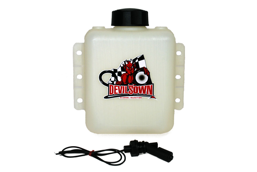

With tanks mounted in the bumper - how do you know when it's getting low?
Also, I hope you have a copy of this saved somewhere, in case there's another crash.
2009 MS3 sport MGM
 Old 11-30-2010, 03:39 PM   #8
taf0422's Avatar
Location: Andover, MA
Posts: 4,689   (View Stats)
Thanks: 17,936
Groans: 192
If you opt for the the float in the tank, there is a light that will light up when the tank gets to a certain point.

You would want to put the float a little past half way
With all the bumps, jerking and tight turns when it's low.
Wouldn't that cause air in the lines kinda like skips in
Spraying cycle? And if so if that bad or less effective?
The float is not a air line it is just a sensor located in the picture below. It is recommended that the float be placed about an 1inch above the bottom of the tank. This is why you have to constantly monitor the level of your meth tank but unless you are so aggressively tuned with meth there will not be any real worry about it running dry...( I wouldn't recommend it though)
http://www.alcohol-injection.com/ima...with-float.jpg
Sorry that's what I ment about the float,placing it high so you have almost half left so your not running dry or getting dry spots from splashing.
I use a sort of fail safe method with ATR in case there is a malfunction in the MW system.
High BAT flag ON is set at 120 degs and High BAT flag OFF at 118. I am running 19-20 psi boost and without MW BAT's past 5K rpm at WOT go to about 130. From previous tests without MW installed I noticed KR would appear at around 125 degs so if there is something wrong with the MW system and BATs pass 120 degs, the the ECU will switch to the HIGH BAT req. load tables by gear which are about 20% lower than the regular ones. I've tested it and it seems to work.
