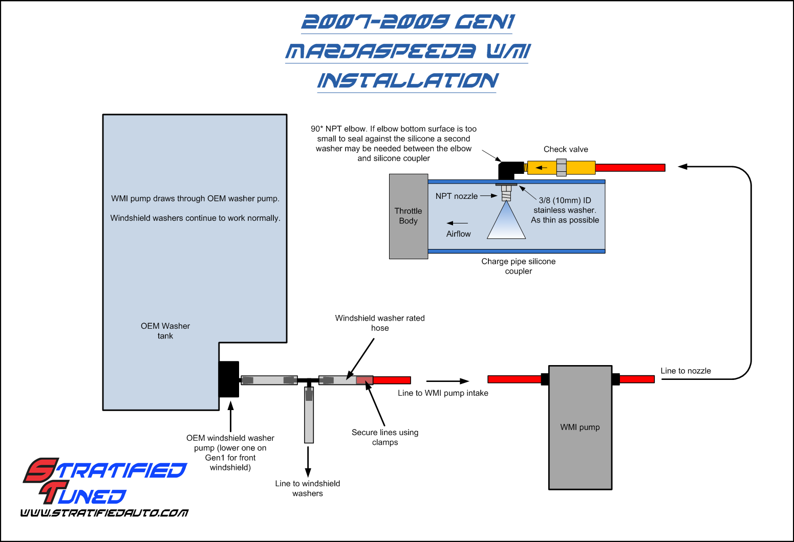

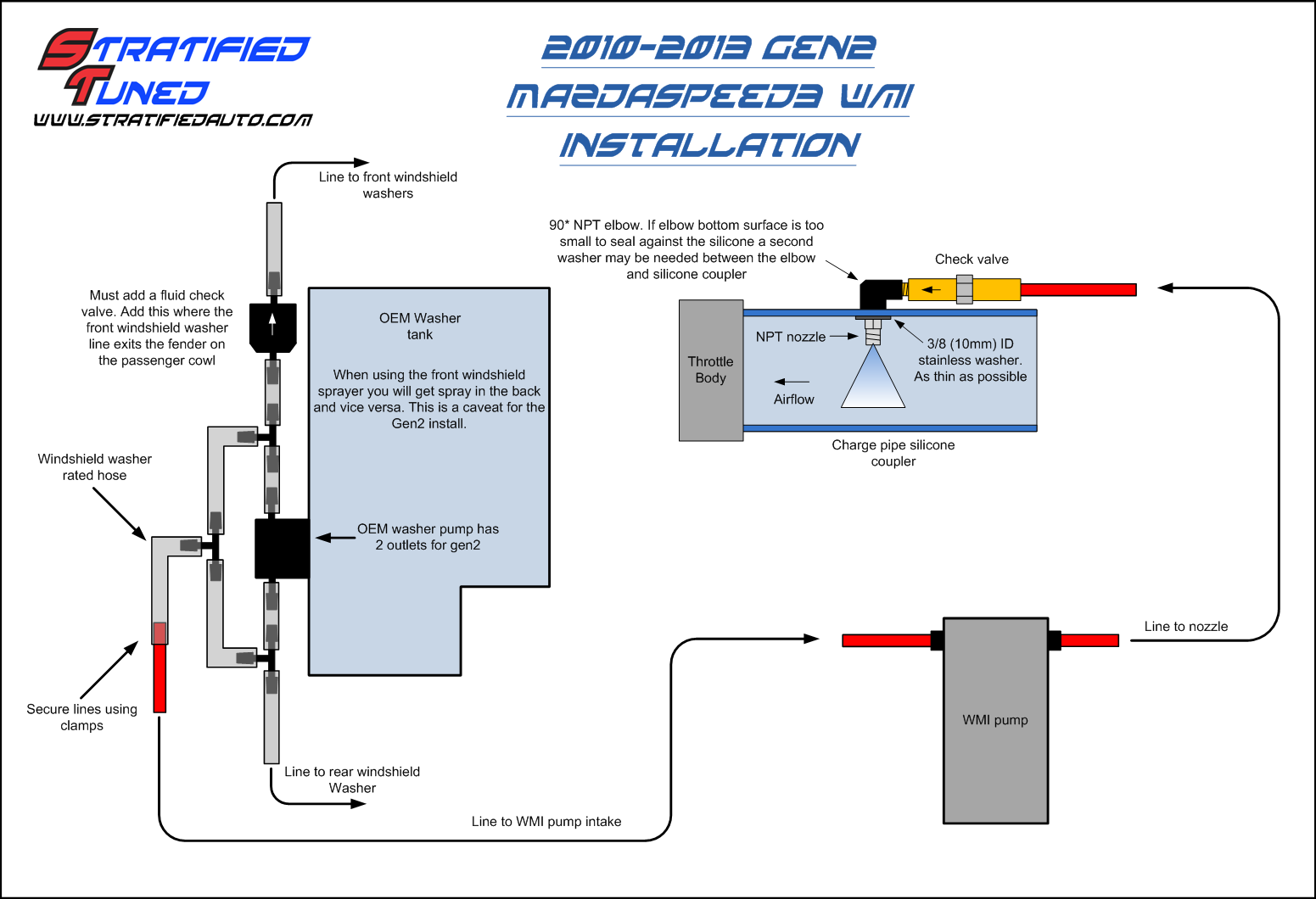

Decided to update and revamp this post with some fairly thorough diagrams for both Gen1 and Gen2. I have also included a good method to mount the nozzle in the charge piping without tapping a hard pipe. I will leave the original post content and images below but all you need are the 2 diagrams and information below. I have also added this writeup to our Blog
The octane and cooling benefits of installing a WMI kit on the MazdaSpeed and other vehicles is well documented. However one of the toughest parts of the installation is installing the fluid tank in a tight engine bay. The vehicles however come with a perfectly good and methanol safe tank for windshield washer fluid (washer fluid contains methanol). On top of this they have a low level light – a huge bonus.
While tapping the stock tank is an option, there is another option for using this tank without tapping it – drawing through the OEM washer pump.
The 2007-09 and 2010-13 vehicles have a different setup for this so we have created 2 diagrams attached below to show the two different setups. In both cases the windshield washers will continue working. However for the Gen2 (2010-13) cars the more complicated setup means that when activating the front washer, fluid will also be sent to the back and vice-versa. This can be a nuisance and if you don’t need the rear washer you can always just cap the line going to the rear washer.
Now you no longer have to run lines inside the car or add another tank and can enjoy the benefits of WMI if these were holding you back!

1. Tapped stock cold pipe and a Devil's own D05 nozzle, tight 90 degree turn, and check valve. The DO 90 degree turn makes all the difference here because you don't want to be hitting the hood with a tall nozzle such as the one from snow performance.
2. The pump was mounted where the horn is. A longer bolt is used to hold the pump in place with the horn behind it. Twin zap straps fit perfectly through the frame rail openings and the seemingly useless little bracket behind the driver side bumper offers another support. Make sure you pad your pump properly if it touches anything as it will vibrate and make noise.
3. The meth source. I used the stock windshield reservoir. At first I was going to tap it, but I quickly realized that water comes out if you unplug the stock washer pump. So I used a T to draw meth right through the pump. Everything works great and no tapping needed! I ran the hose in front of the bumper and covered it in wire loom to keep the color black.

Lol, yes flashback! Surprised more people aren't using the stock tank. It works on gen1 and gen2 but the gen2 pump system is different so you have to add a check valve and be a little sneaky. I should do a writeup and update this.

I will put something together soon but not for another week or 2 as I'm traveling and swamped this week.
Essentially you pull through the OEM washer pump (the lowest one) for Gen1 and for Gen2 it's a bit more involved but the same principles apply.
lex / or anyone .... Can this method be used on the 6?

Yes it works on all speeds. The gen 2 requires an extra check valve. I will get some diagrams up hopefully within a week just have been too busy.

I would definitely be interested in a write up for 2nd gen because I was going to start to piece together a kit and just bought a 2.5 gallon reservoir and I am thinking I might have went overboard lol.

Yup you can do that on any vehicle. It makes install a breeze. Because half the battle is finding a place to install a seperate tank.
