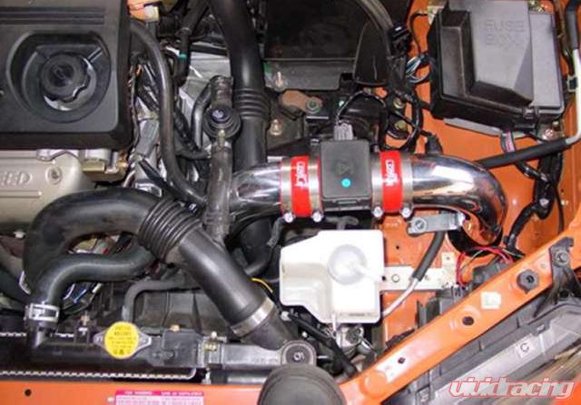

The Following 2 Users Say Thank You to StealthWyvern For This Useful Post:

injen CAI (check)... injen intercooler pipes are where?

i don't think injen makes intercooler pipes
but S U and protegegarage do have them.

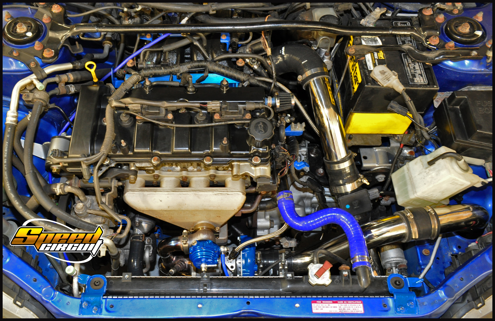

Default BOV Stallout
I just installed my BOV TurboXS type H and I am stalling out when I go into neutral.. anyone else experience this or any tips or suggesting to solving this problem? Everything is stock except for the aftermarket intercooler.

Your stalling for two different reasons... 1) your venting metered air or 2) you haven't relocated your MAF yet to the cold pipe between the BOV and the Throttle Body.
Personally Im running a relocation MAF and the Stock BPV vent to air.
StealthWyvern is offline   Reply With Quote

So is the verdict to just get an aftermarket BOV that vents into the air that isn't recirculated? And if this is the answer, do I have to relocate my MAF....Or how If I can get my BPV to pssshhhh more, do I just recirculate it ?...and where if so?

the final word
YOU CANNOT VTA WITH A BOV WHILE HAVING THE MAF IN THE STOCK LOCATION.
you must relocate to fully vent.
you could do hybrid..vent and rec, but that's just ghey.
now, if you don't have hardpipes or a FMIC, forget VTA cuz you wont
this is what you would need to relocate and VTA
oh and google man...google that shit..took me 10 seconds to find the answer...this car is from 2003..believe me, everyhting that coulv'e been asked..has been asked.
