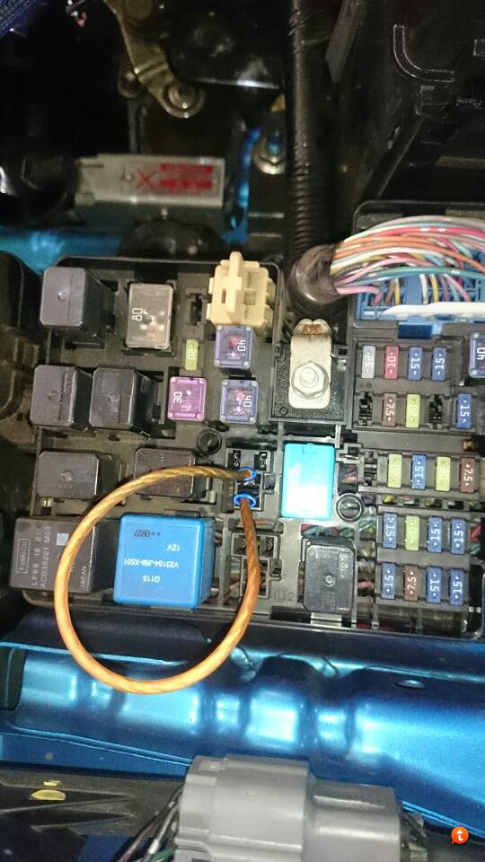

I had to drain a full tank of old fuel after my engine build, so I thought I might as well make a How-To for it...
1. Open engine bay fuse panel, and remove the primary fuel pump relay (labeled 'Circuit' in the diagram on the cover)
2. Create a jumper cable by crimping on two spade terminals on a short piece of wire. I used 14ga wire.
3. Plug one terminal into the port on the the fuse panel closest to the windshield. This is the +12VDC terminal:
4. Disconnect the blue fuel line connector on the HPFP. This is the line from the fuel tank to the HPFP (low pressure line).
5. Using a funnel and hose, run a line from the disconnected fuel line to a gas can:
6. Connect the other spade terminal to the port on the fuse panel just next to the one used in step 3 above. This will start the ITFP. NOTE: fuel pump relay 2 controls the high/low speed for the pump. with the relay not energized, the pump will run at low speed (which we want):
7. Profit:
Disconnect either jumper lead to stop the pump.

@silvapain; can you confirm this is the same on the gen2?
edit: this works as well on the gen two. the relay is in a different spot. i just tried it. standing at the driver side fender you will jump the two horizontal plugs in the circuit. these will be the two closest to you.

i didnt take any. if you pull the "circuit" relay stand at the drive side fender. looking at the fuse box it will the the two horizontal plugs you jump (going off of my memory and my previous post)

Correct me if I'm wrong, but wouldn't this be hard on your low pressure fuel pump? I know most fuel pumps use the fuel for cooling and lubrication. Wouldn't running your tank dry like that put a lot of wear and tear on it? Not to mention it will suck all the gunk at the bottom of your tank into your fuel system and threw the pump. Seems like a good one time thing and not something to do all the time.
You're running the pump at low speed, which means it will not need as much cooling/lubrication. You also shouldn't be doing this every week, so the wear/tear should be negligible. The pump always sucks from the bottom of the tank, so all of that "gunk" would be sucked up whether the tank is low or not. That's an old wives tale as far as I'm concerned. This is also why fuel pumps have filters.

What makes you think it's bad for the pump?
It's doing what it does any other time it's operating, but instead of going into the HPFP, it's going into a gas can.
As long as the pump is promptly stopped when fuel is no longer flowing, there should be no issue.
I would be more concerned with fuel flowing near live/exposed electrical circuits.

 Old 06-16-2015, 11:47 AM   #27
batmsp3's Avatar
Location: Mesa, Arizona
Posts: 153   (View Stats)
batmsp3 has a reputation beyond reputebatmsp3 has a reputation beyond reputebatmsp3 has a reputation beyond reputebatmsp3 has a reputation beyond reputebatmsp3 has a reputation beyond reputebatmsp3 has a reputation beyond reputebatmsp3 has a reputation beyond reputebatmsp3 has a reputation beyond reputebatmsp3 has a reputation beyond reputebatmsp3 has a reputation beyond reputebatmsp3 has a reputation beyond repute
Thanks: 58
Thanked 70 Times in 46 Posts
maybe I'm going full retard, but I was hoping to get clarification for the ms6. I would like to add pics after I am successful (or fuck something up) to help others.
@superskaterxes; where/what is the check connector you are referring to?
"Looks like Travis Stephens"
batmsp3 is offline   Reply With Quote
 Old 06-19-2015, 01:54 AM   #28
batmsp3's Avatar
Thanks: 58
Default Check connector
Think this might be it for the ms6

 Old 04-07-2016, 06:28 AM   #30
sailnaked6842's Avatar
Join Date: Aug 2014
Location: Monroe, Mi
Posts: 100   (View Stats)
sailnaked6842 has a reputation beyond reputesailnaked6842 has a reputation beyond reputesailnaked6842 has a reputation beyond reputesailnaked6842 has a reputation beyond reputesailnaked6842 has a reputation beyond reputesailnaked6842 has a reputation beyond reputesailnaked6842 has a reputation beyond reputesailnaked6842 has a reputation beyond reputesailnaked6842 has a reputation beyond reputesailnaked6842 has a reputation beyond reputesailnaked6842 has a reputation beyond repute
Thanks: 16
Thanked 44 Times in 25 Posts
I know I'm kicking the dust off this thread but just to confirm that for the MS6 you are only pulling the check connector and grounding the top right pin and will not need a jumper?
sailnaked6842 is offline   Reply With Quote
 Old 04-07-2016, 04:14 PM   #31
batmsp3's Avatar
Thanks: 58
yup ,just take a wire from the check connector and connect it to ground.
