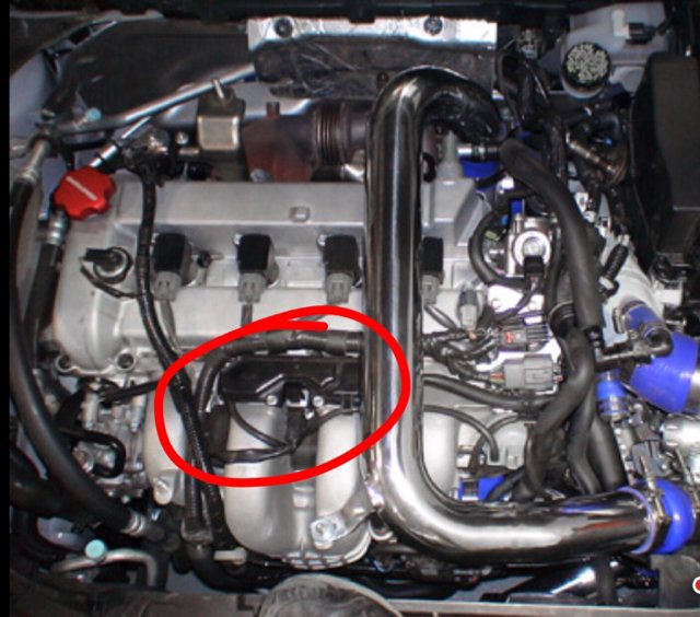

To gain access to the area we need, you must first remove the engine cover, TMIC, and Intake.
Now you will be looking at a mounting plate with two wire harness on them. Disconnect these two harnesses.

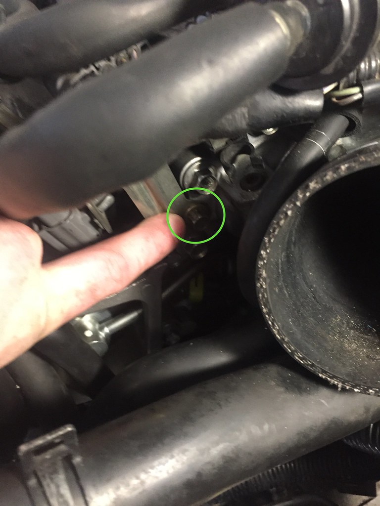

There are two bolts that hold this plate in place both are 8mm, one is easily seen on top:

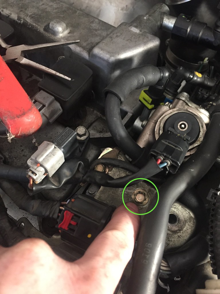

The second is located on the right side of the head you can see here:

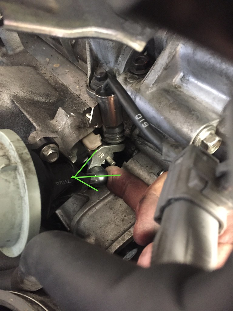

Now with the plate removed you will be able to see the broken plastic piece:

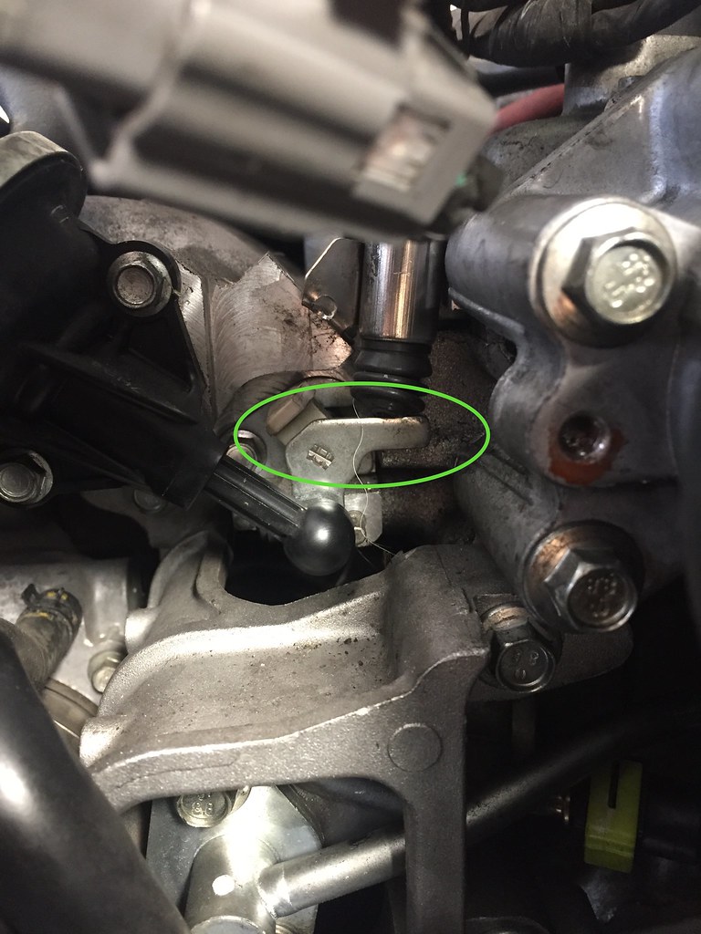

The actuator moves this the VTCS sensor, which is held on by two phillips head screws. We want to remove the top one.

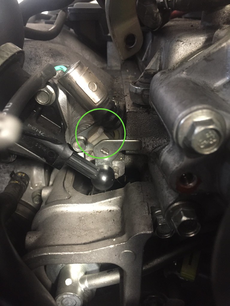

Once removed you will want to bend the entire bracket/sensor forward, it should be pretty easy to bend. You want it to sit right on top of the actuator so it pushes the plunger in:
Now when ever the actuator is pushed in the sensor is allowed to travel outwards:

I have a 2009 MS3 that just put out a CEL P2006 code, any idea where that intake manifold runner control valve/solenoid is located?

Yep. Pull off your TMIC and it’s in inside of the little black box towards the front of the engine bay. Here’s the location, this obviously ain’t a stock engine bay

I have the P2006 code, I can clear it and the CEL will stay off as long as the engine is running but the CEL comes back after almost every restart. The mechanical part of the system seems to be operating as intended, I can watch the actuator turn the linkage to open up the butterflies in the intake as the engine warms up or when starting/turning off a warm engine. I haven't noticed any drivability issues with the car since the CEL started coming on.
I thought I had found the issue when I found this thread but when I got to the plastic piece, it is not broken. The car is stock and I doubt that the intake has ever been off. Could it be the plunger/ sensor itself or do I start with the intake manifold runner control valve/solenoid?

That's exactly how the system is supposed to work. If something isn't working properly and you haven't fixed it, then the CEL should be clearable, but it will also return upon the recurring failure of whichever part of the system has failed.
You might want to check or replace the VTCS actuator and hose to the vacuum block beneath the intake manifold.

Did the fix for the broken plastic piece. Worked perfect. Simply bending it wasn’t enough to make contact so removed both screws and shifted by one screw hope lower down. Thanks all!
