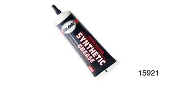

| Not Ranked : 0 score ![]() will this work?

| Not Ranked : 0 score I have been using synthetic paintball marker lube on my valves for years and thousands of miles, scant an issue. Sent from my Galaxy Nexus using Tapatalk 2
