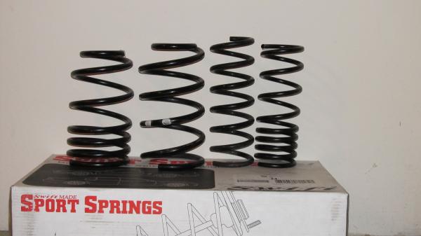

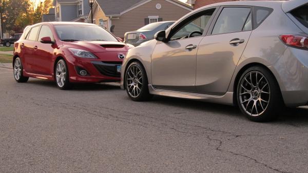

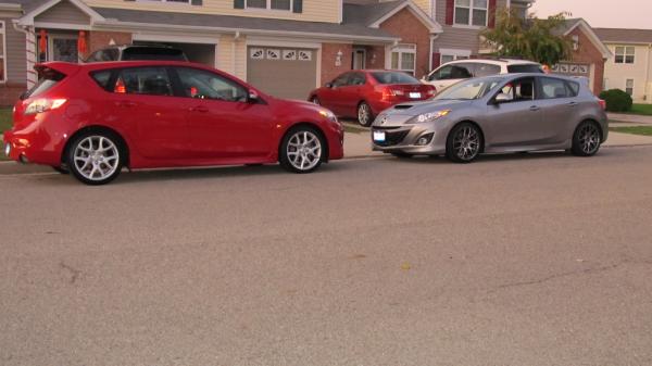

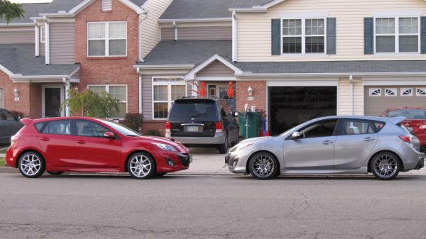

Swift springs installed
Here are some pics
Swift next to OEM
Swift when car is on load (on the ground) in the front. The "progressive" portion is just there to fill a void I guess (fully closes) and becomes only a linear rate spring.
Car is on a slight downhill on passenger side. Red MS3 is @R3L3NTL3S . Will be installing Swift springs on his car tomorrow
From our short drive. Car feels good. Smooth. Not bouncy. Took small bumps or imperfections on the road better/smoother. It actually rides smoother than stock. It doesn't have that jolt like the oem springs when going over small bumps/cracks or whatever. I will go for a longer drive later and get back with more. So far so good. Now I need 235/40 or 245/40's .. I hate how thin the stock tires are.

Swift replied to a question I had about the progressive portion. This was what their reply:
"yes the progressive portion of the spring acts like a helper spring. It is fully collapsed at static height. And yes it is a linear rate."
he also mentioned that Bilstein sport would be the best way to go. I guess he was getting a lot of people calling to see what higher performing shocks/struts would be best. He contacted Bilstein and found out GREAT news. You can get it custom valved for FREE when you order them new. I contacted AJUSA.COM (probably Bilstein biggest distributors and cheapest price actually) to confirm, and indeed it is true. I asked what info they need. He said: spring rate (we have), curb weight (we know already) and corner weight (i emailed swift to get this info). With this info we can have custom valved high performance struts/shocks for our cars!
Now I need to find a way to buy these< ran out of money! lol
Nliiitend1 and Stwok240 like this.
