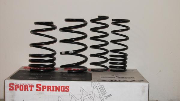

Swift springs installed
Here are some pics
Swift next to OEM
Swift when car is on load (on the ground) in the front. The "progressive" portion is just there to fill a void I guess (fully closes) and becomes only a linear rate spring.
