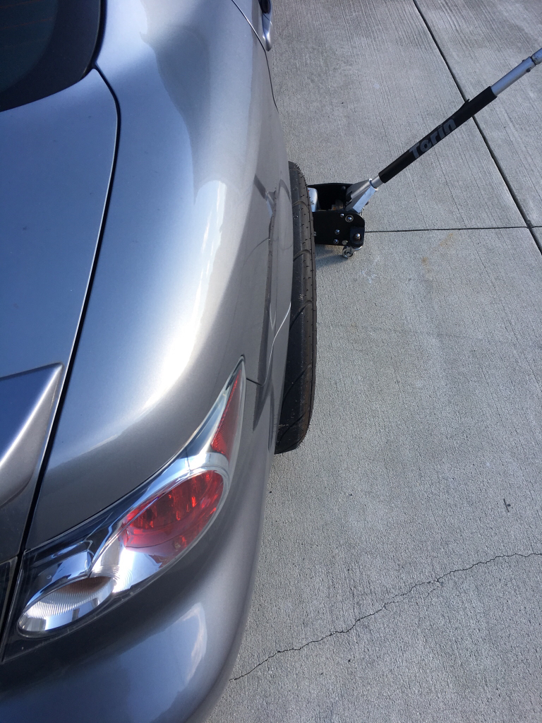

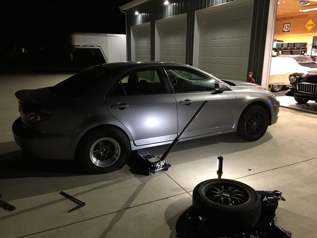

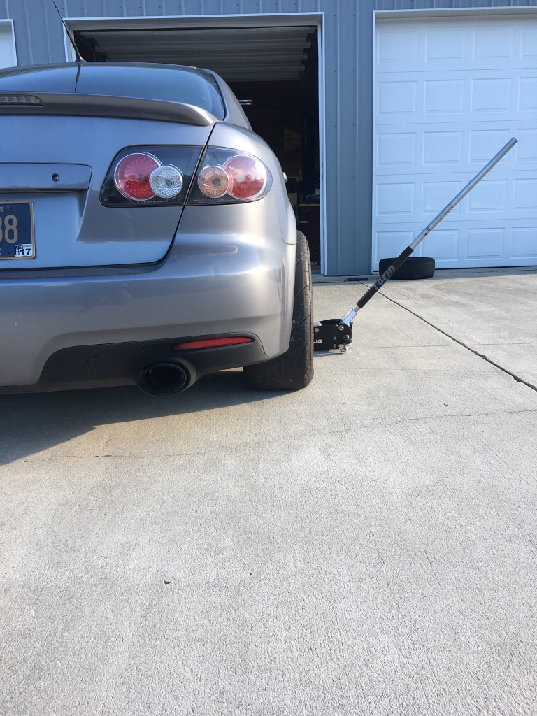

Little teaser. Friend let me borrow one of his Welds to test fit.
This is a 15x8 5.5"BS (21mm offset) with a 275/60 (28") I'll be doing a 26" tall but tire width is unknown. Also the wheel hit the caliper on the face of all places. So a little spacer will solve that issue or shaving the caliper down. Right where the barrel dips to meet the spokes. I'll probably order a set of 15x8 6.5"BS (51mm offset)

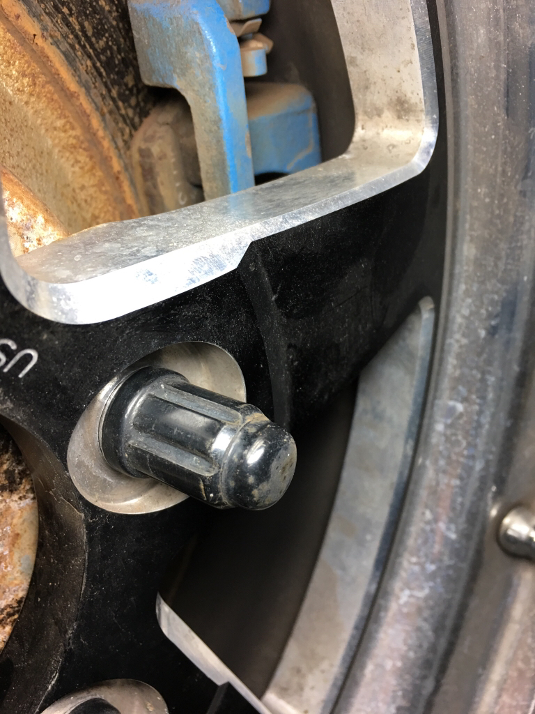

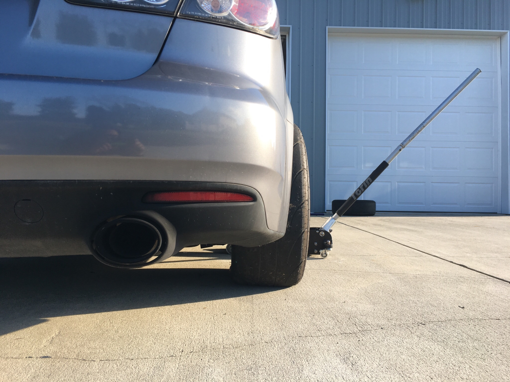

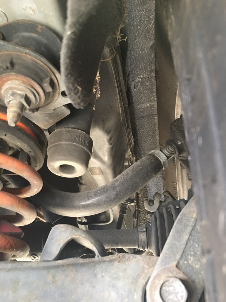

More pics
Where it nicks the caliper.
I know the poke is corny. It'll tuck nicely inside the car on the finished product. Thank you to @BigRed06; for getting me straight on what brakes to use in the rear to eliminate the contact issue all together.

Good to know that 15s will work. What brakes are you gonna use in the rear?
Also, I know fender flares are sorta corny but they would cover the poke.
Sent from my Pixel XL using Tapatalk
03-05 Mazda6 rears. They should be considerably smaller. A set of good rotors and pads and I should be fine.
I really do want them to tuck. And I'm sure the 6.5"BS (51mm offset) will be nice and flush. I also decided to run 245/55/15 M&H radials. Equivalent to a 26x9. I've had good luck with M&H on my Chevelle (325/45/17) and my Nova (390/45/15). This makes it easier for me on the front tires as well. I can do a 17 in the front with Evo calipers and 245/45/17

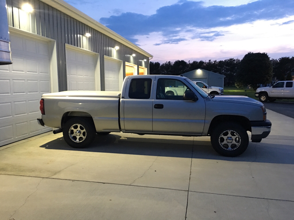

Also wrapped up a single turbo Silverado build for a friend of mine.

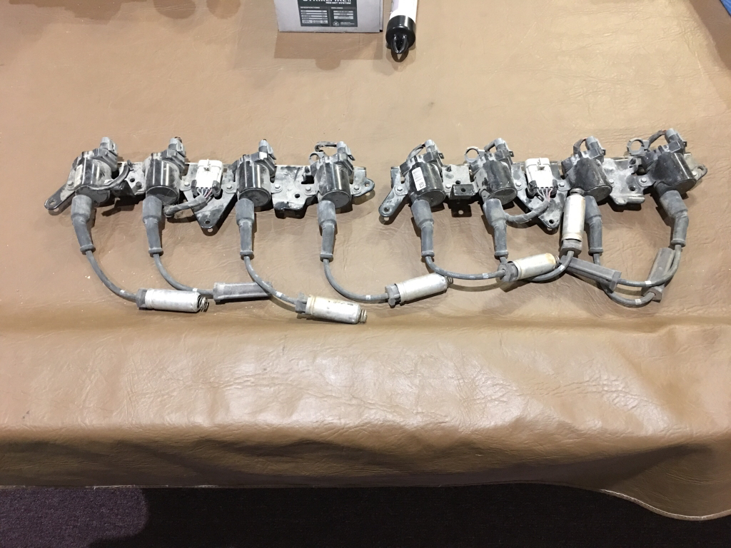

Picked up some coils for the 6 today

Got the speed in the shop finally. This week I will mock up the Mustang K member and see how it all fits up.
File Type: jpeg AB6EB4AE-3701-4F90-98BA-388E05CAD11B.jpeg (776.9 KB, 15 views)

Got the factory subframe out and dropped the body on the mustang K member. It will need to come back about two more inches to get the wheelbase correct, as well as the k member trimmed to fit inside the frame rails so nothing is hanging lower than the floor. All in all moving in the right direction. I didn’t want to build a k member solely for the fact that I can order tubular parts from a huge selection of vendors. The engine will be mounted to an engine plate so where the k member sits has no relation to the engine.
