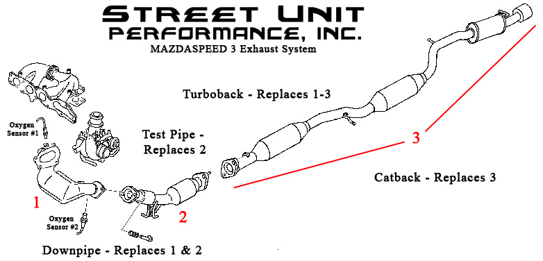

Default Difference Between Testpipe, Racepipe and Downpipe
I'm probably going to get torn to pieces for this post since at some point in history it's been covered. Screw it, I'll ask again.
I'm new to the MS3 and am not familiar with turbo'd cars. What is a testpipe, racepipe and downpipe? Do you have/need all 3? Are all 3 street legal? I'm trying to gather my list of future mods for the '12 I picked up yesterday.
Kevin

Test pipe and race pipe pretty much the same. Downpipe is from turbo to first cat, I think.
My test pipe replaced cat #2.

SEARCH!!!!!! Then you would know that those items shouldn't be on your radar until you:
1: have a way to tune for em (Cobb ap)
2: hpfp solution (internals or cpe pump)
3: look into RMM's (many vendors)
4: read and search more
Test pipe/race pipe (replace 2nd cat) are used interchangeably and a downpipe is from turbo to cbe usually replacing stock dp and 2nd cat
My opinion is ap/intake/RMM/internals
Then install those and enjoy an OTS map until you decide where u wanna go with the build.... Stock exhaust is fine for light mods.... *remember to stock out for stealership visits
1 thing to add, aftermarket dp's can come in short style(only replaces #1) or long style(replaces #1 & #2).
