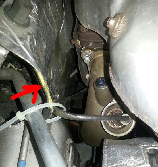

Cobb downpipe install took me around 10 hours. Not a fun experience, ran into some typical problems and have a few leftover questions/issues.
This was done on a 2010 speed that had 38000 new england miles on it.
I read the shit out of every thread I could find before I even planned the install, and pretty much regretted buying the downpipe before it was even installed...
Kept reading about all the things to worry about and that could go wrong.
  1. Ruin one or both o2 sensors by crossthreading, or using too much penetrating oil
  2. Heat shield bolts strip threads or heads
  3. Remove or torque down 5 bolts from downpipe to turbo flange
  4. Break a bolt to turbo flange and have to remove turbo to extract the bolt
Thankfully I only ran into 2 of these issues myself.
The heat shield on the original downpipe has a screw facing the firewall. It took me well over an hour for this one fucking screw. Pneumatic chisel, stripped head extractor, and vice grips got the job done - fuck this screw.
Got to all of the bolts on the original downpipe no problem from the top, was so excited things were going smooth again.
Started removing the downpipe and almost called it quits... install guide from cobb and corksport says "You may have to twist and maneuver the downpipe to get it past everything". This is a huge understatement.
Its like trying to shit out a pumpkin with spikes on it.
The factory downpipe has tons of heat shielding, a bracket welded on for 2 extra bolts, and wire hangers for the O2 sensor cable.
This is where I wanted to call it quits, shove the thing back up, bolt it back on and turn my new downpipe into a bong.
After mangling some of the foam/foil heat padding attached to the exhaust channel on the body, I got the old downpipe out.
Putting the new downpipe in was a little easier since it didnt have a giant heat shield and little fucking wires sticking out of it. The length of the cobb dowpipe made it a little harder. If I were to do this again I would go with a 2 piece pipe, or even the full race design that has a separate bell mouth all together.
Bolting the new downpipe to the turbo flange was the next moment that made me regret spending so much money to be in this position.
The top 3 bolts were easy, sockets fit on all of them, was able to get them on no problem and snug them up. The 2 lower bolts dont allow for socket to fit because of the bell mouth on the Cobb downpipe. I had to use open box crescent wrenches and turn them little by little since the ratcheting wrenches I have were too fat to fit.

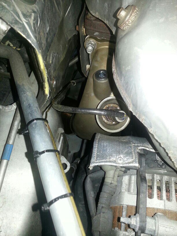

The downpipe is in now, I still havnt found a good way to keep the wire from the O2 sensor out of harms way. The zip tie I decided to use for now is tearing at the heat shield that sits behind the turbo, so this is the first thing I want to fix. I put a red arrow in the pic where its rubbing.
Whats the best way to have the primary O2 sensor cable routed to keep it from getting harmed?
Question 2 is, should I stop worrying about the under-belly heat shield I tore up removing the old downpipe? I'm worried it will get wet, retain water and dirt, start rotting and spread.
Last concern is the donut seal that mates with the catback, there is a gap between the flanges but it seems to be sealed properly. Does the cobb downpipe have too long of a dick for the donut gasket to sit on? I'm woried that its hitting the OEM catback and not allowing the flanges to meet.

Man. Should have made a little slit in the head shield to run the sensor through. Just my .02 cents

First time always sucks .... First one we did 8 hrs .... By the 20th 3hrs flat no power tools lol
O2 wire looks fine , fuck the heat shield on the bottom ...and as long as downpipe seals who cares .... Enjoy

I'm more concerned the zip tie I'm using will scrape away the insulation shit and make a mess at this point, the wire seems out of the way. I guess I'll add more zip ties to keep the one holding the wire from being so close to the shield

Don't worry about the gap between flanges. It has to move around. The donut is there to keep things sealed. There'd be a problem if there was no gap
And for the heatshield, if you're so worried about it, get some reflective tape and tape over the edges.

Took a clothes hanger and made a small coil on one end that I fed the o2 cable through. Zip tied it to the AC line, it goes down a good foot and keeps the o2 wire well out of harms way. Will keep tabs on it after every drive to make sure its staying in place.

Or you could do what I did and take the two nuts off the heat shield and put the wire behind it.....
The one that is against the firewall (in my picture it would be to the left)? I didn't even look to see how easy it is to remove that. Thanks

Yeah that's what I did. There only 2 nuts holding it on
