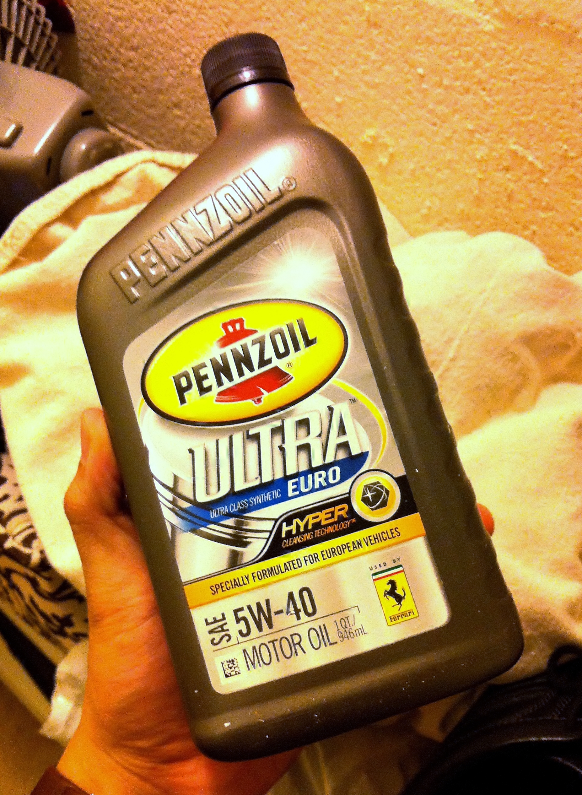

What makes the Ultra different from the Platinum? From what I read the Platinum gets great reviews.

It's more expensive, so it has to be much better right? lol
Not sure to tell you the truth

Up here, the platinum is more expensive than the ultra.
And why would you put that euro 5-w40 in 10-40?

I can only use 5W/30 in my car MCI would just love any excuse not to warranty my car! I have been using Amsoil XL for all my Oil samples with 3,000km oil changes at 5% fuel dilution with viscosity breakdown, besides the first one that MCI had put 15W/40 amsoil heavy duty diesel and marine synthetic prior to new turbo which was 10% fuel dilution at 6,000km and oil was sheared down to a 15W/30.
Now I am using Amsoil OE to try and keep costs down with frequent changes but will probably revert back to mineral oil from Mazda with their oil filter and let the problem Polaris Laboratories found which is not an Authorized Mazda Dealer which of course no defect has been confirmed by an Authorized Mazda Dealer, so therefore there is no warranty defect that an authorized Mazda dealer can fix, run its course so there will be something an Authorized Mazda Dealer can fix during my warranty period.
