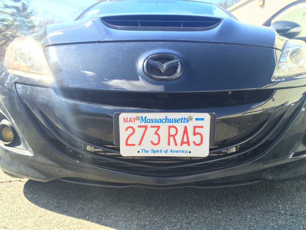

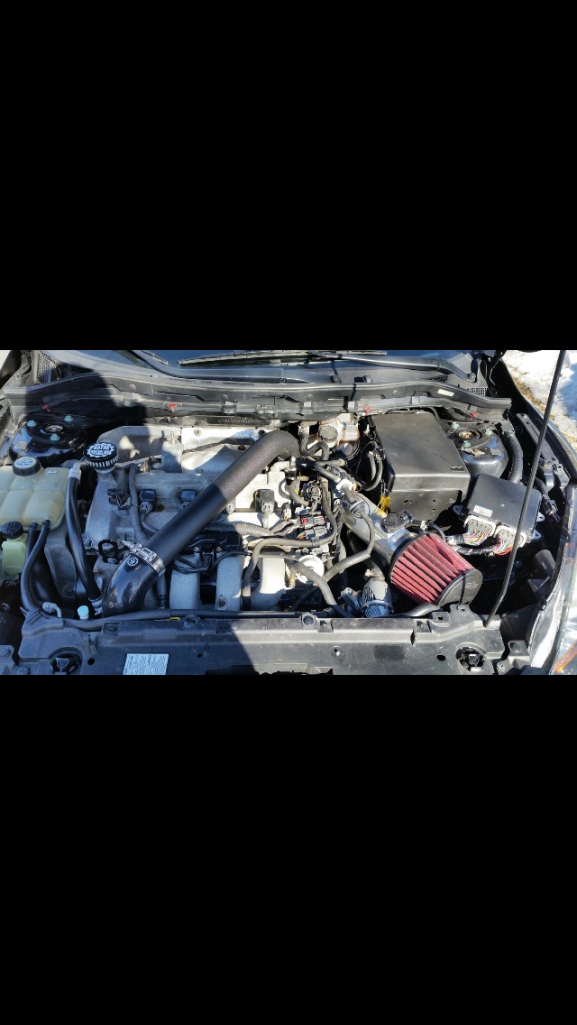

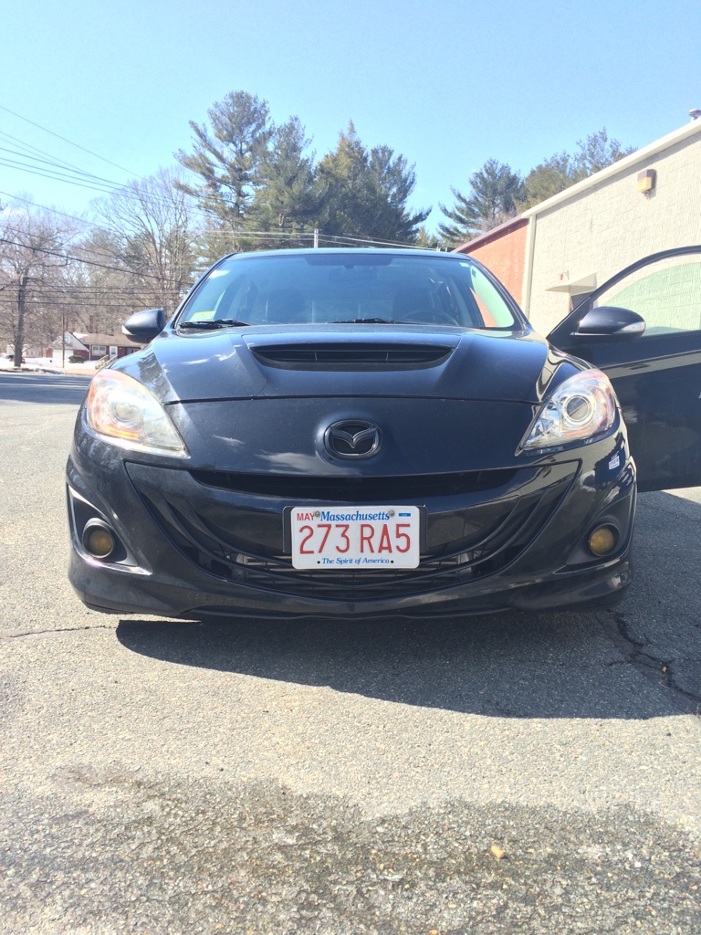

Installed this kit last week with a tr6. Fitment was perfect. This is my first front mount so I have nothing to compare it to but a few nator buddies that helped said it was the easiest kit they've ever worked with. Here are some shitty pics for people thinking of going this route on a pu.
Hows your experience been with this on the bnr?
