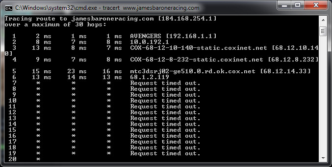

Could someone who can't connect go to a DOS prompt
and please type:tracert www.jamesbaroneracing.com
Then post the response please.
Thanks!!

I can't ping or trace from my EVO on Sprint. No problem on At&t DSL.

Sounds like a DNS problem to me... If you're on a PC and can't get to it, open up a command prompt (Windows XP -> start -> run -> cmd; Windows Vista/7 -> start -> type in search "command prompt" -> click command prompt), and type nslookup jamesbaroneracing.com
You should see something like:
DNS probably isn't replicating properly.
Someone who is having the problem can also try to add the url/ip to their host file to see if that fixes the issue.
It's also be nice to see what DNS servers everyone who is having the problem is using.

Can't connect to it either from my computer or any computer connected to my WiFi.
I'm using Google's public DNS servers. 8.8.8.8. and 8.8.4.4
No links or redirects work.
Please don't use my IP to haxxor me, I'm providing this info for the good of all:

Can you do an nslookup on the site?
