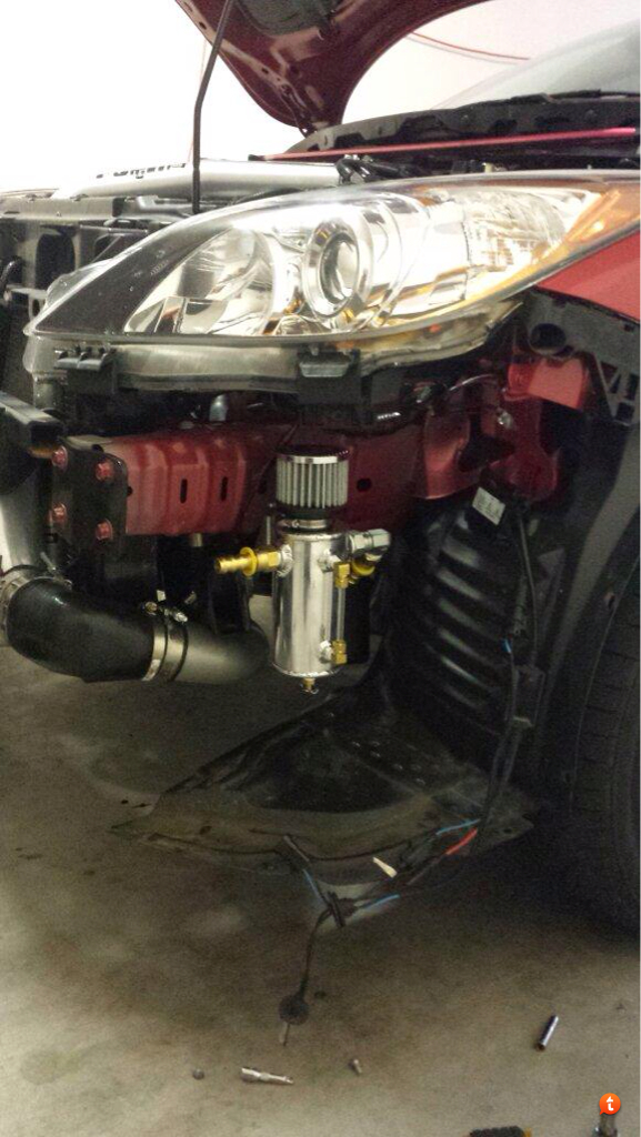

I envisioned something like this (pro MS paint skill, well aware)
But that isn't going to work for a vented monstrosity like that.
Agent_Orange (01-18-2014)

I think a replacement for the stock washer tank would be a bit more expensive but worth it in the long run. Maybe use a different bracket for pu vs won.
Here's the stealthy kit that was just installed on my ride last night (pics for clearance/space availability on genwon):
