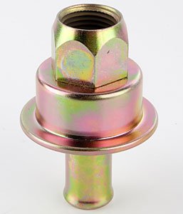

subaru's run a valve cover breather like ours, but T the crankcase with a check valve such that when in vacuum... IM sucks air in from the VC (like ours). And when in boost, the crank case vents to the TIP in conjunction with the VC (not like ours).
I'd like to see someone try a setup similar to this.

you'll get alot of argument on where but I am with Lenny....as close to compressor as possible.
Dustin, WTF is the difference between a PCV and a check valve? Aren't they the same thing.

PCV is similar, except it regulates (restricts) flow when open... like a coffee straw. It only lets so much air come out of the crankcase.
Like how PTP used a pill in the VC to increase vacuum in the CC and help with turbo smoke... one could have simply swapped to a higher flowing PCV and possibly achieved the same thing.

and jesus fucking christ stop puttin springs on your dipsticks you fucks. DONT YOU THINK ITS POPPING OUT FOR A REASON!?!?!?!?! stop bandaid-ing the problem and fix it for good.
i blocked off my stock PCV box on the block and drilled and tapped my VC.
added more holes to the baffle for better airflow out of the VC.
then you add a 100 PSI CHECKVALVE inline with your OCC.
JEGS Performance Products 52211 JEGS Crankcase Evacuation Kit
the stock PCV valve has been proven by scott to let in between 5 and 10 psi of boost into the crankcase. hmmm last time i checked the CC is supposed to be vacuum 100% of the time. before i added this CV i was popping my dipstick almost every day. since ive had it i have yet to have one occurrence of a blown dipstick. not even a little bit popped out but always snug in there.
