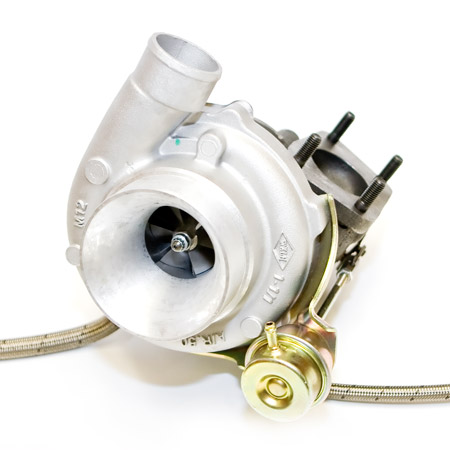

I'm considering a GT2871R...it's local, new and dirt cheap...but it's meant for a Saab...here's a pic:
It seems like this kit is clocked 180 degrees from ours...and I believe the WGA will have to be remounted...
Ours from ATP:
I want to know if it can be done...is this a 180 degree reclocking of the turbo and remounting the WGA? Is there anything I'm missing? I know about the GT30xx blah blah...but like I said, this is about as much as I'd spend.
Also, I'm interested in how to mount the turbo (with OEM turbo mounts?) or does it "hang" off the manifold?

Here are pics from the seller...I'm assuming it's a 5-bolt, and confirming now...what do I need to make it work?

Or get a mazdaspeed turbine housing, or get a T3 turbine housing.

yes the only reason why atp can charge so much for their turbos is because it mazdas have their own turbine housing flange....
which is why a lot of BT guys just get t3 flanges on their ex manifolds for more flexibility and cheaper turbos.

"It seems like this kit is clocked 180 degrees from ours" be careful the turbo might run backwards creating negative boost

so I'd have to get these two things to make it work, along with hoses, etc?
Turbine Housing, T3 5 bolt (ford style) Garrett .48 A/R casting machined for GT28RS/GT2871R/GT2876R : atpturbo.com
and
Ultimate Internal wastegate valve for T3 5Bolt, high flow 3" V-band Style : atpturbo.com
the seller is asking $700...but now it seems more trouble than it's worth...

You will need a new housing, as coldrice said. Mazda's flange is specific if you want to stick with the stock flanges. If you don't, then get a nice t3 housing, a t3 manifold, and a custom v-band downpipe. Easy? No. Cheap? No. Fun? Fuck yes. A well flowing gt28 would be a lot of fun.
