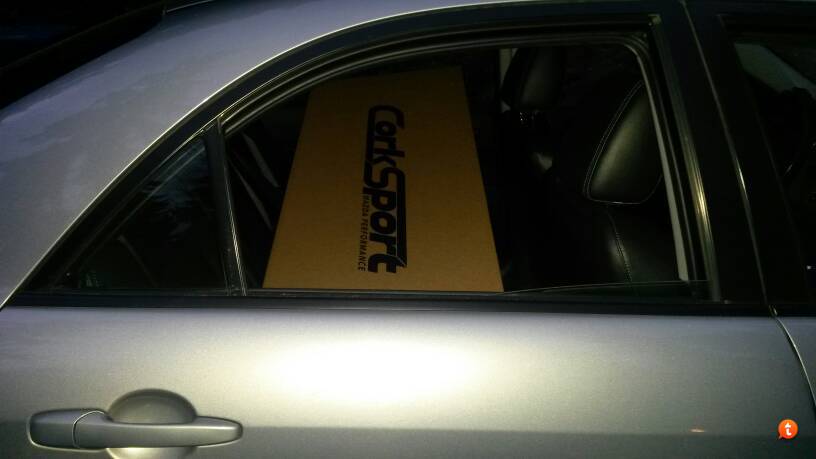

My friend had to pick something up in Vancouver so I asked him to pick this up for me...

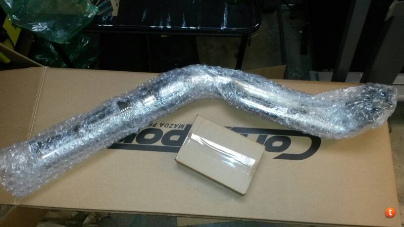

It's a big box...!
Woooo... can't wait to get it installed. .. thanks CS.

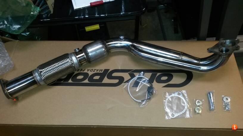

Just wanted to mention that it appears an o2 sensor extension is included so we can stay 'legal' without any extra stuff needed! Wasn't expecting the extension to come with it. Awesome!

I'm confused...you have a cat, it should not throw a CEL...so...what gives on the defouler?
Moreover, it is legal with the inclusion of the cat. Why the excitement over the defouler?

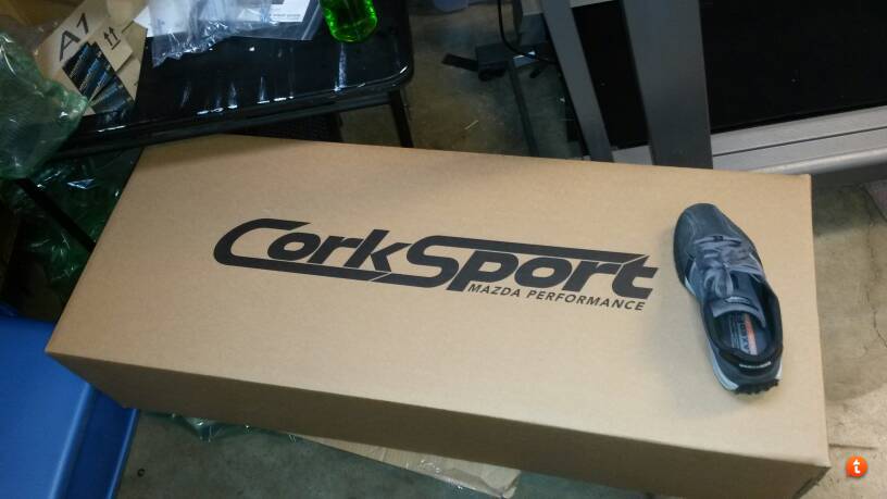

I like the shoe. Is that CorkSport as well?

Ha ha. It was for scale. Skechers.

Probably won't need the extender with a cat, it's most likely included in case it does throw a CEL for whatever reason though. I'd run without it unless you absolutely need it.

I thought to avoid a cel you needed an o2 sensor on each side of a cat.

Pretty sure it's after, the pre cat reading is going to be what it is if you have a cat or not. Probably Fuck up your afr reading too.

you dont want to use the defouler period.

I wouldnt say that its a defouler unless I'm missing something. I thought that a "defouler" was an angle connector to take the o2 sensor out of the main exhaust stream to fool it into thinking that there's a cat when there isn't. The bung appears to be a standard for a legit o2 sensor connection. I assume that since there is a cat, both o2 sensors can be hooked up normally. others had said that they get no cel with this dp so I'm guessing that they must have connected them normally or else the o2 sensors wouldn't see enough of a before and after cat air difference...

The piece you have (defouler) places the O2 sensor out of the exhaust stream. You should not need it, just put your O2 sensors in and drive.

There is no defouler that I see... I don't know why it would come with one.

I think I got lost in translation. Looking at the photos, I don't see the piece I was referring to. In the last photo, what is the item second to the right?

Bolts. Hehe.

Fuck me.
