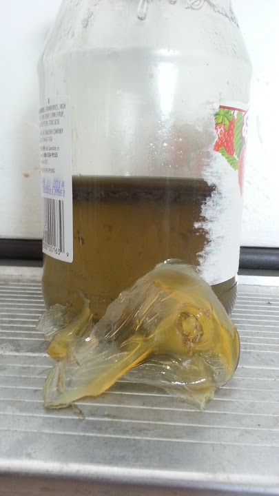

I understand the top is welded but thats not the sealant that ended up in my hoses. The largest piece I have found yet was from one of the mounting bracket screws. Is there a revision of this sealant aswell?
jamesr242 (01-23-2013)

Here is a picture of the bottom of the can aswell (hard to tell but its bare steel)... do these ship uncoated in the lower section or has the paint been pulled off from the chemicals it is exposed to?
I wonder if this could potentially cause an issue over time, hell, even oil pans rust out.

Everytime I convince myself it's ok to buy this, you post scary pictures! Damn you @El_Diablo;! Lol I am going to wait and see the response from @CorkSport; on this one.
Nice work on providing info and pics though.

So it seems not only the top needs to be welded, but everything...Whatever it takes for there to no longer be glue used period....

Whoa....thats awful....no wonder cans were blowing their lids. Plugged up inlets/outlets would do that. I hope corksport fixes this and removes the glue from all parts of the OCC. If they do I'll gladly order theirs.

Due to a manufacturing challenge that was missed by our quality assurance department, a small batch of oil catch cans had an issue that has since been resolved. Regardless of when you ordered your oil catch can we are here to help. If you have any concerns regarding this product, please contact Kelly here at CorkSport and we can take the necessary steps to make sure you are taken care of and can continue to have the piece of mind that we strive to provide. Since 1998 CorkSport has been dedicated to the Mazda community and have been committed to excellence. We pride ourselves in our customer service and can’t wait to prove it to you. If you need immediate assistance please call us at 1-360-260-2675 or email Kelly in our warranty department at: Kelly@corksport.com
