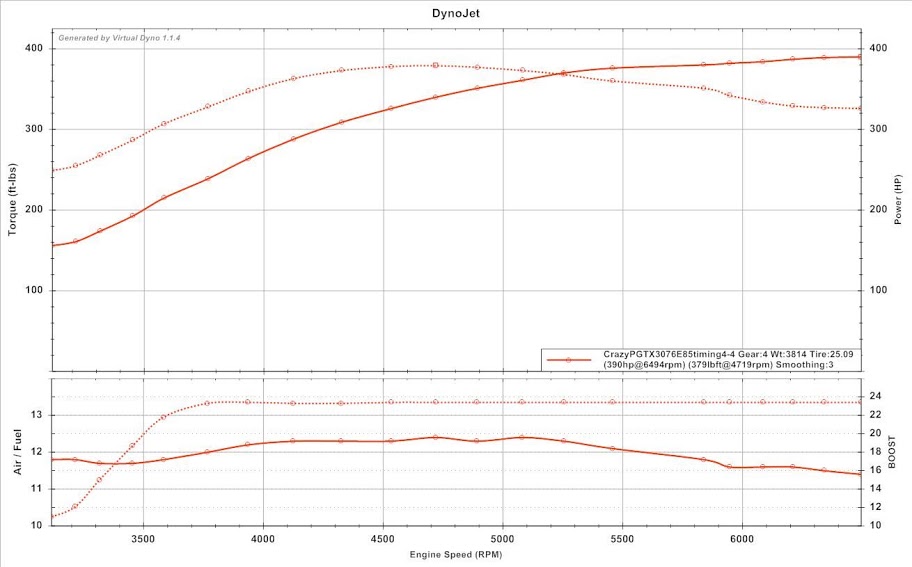

Dustin, if I'm not mistaken, the Dynojet option in VD has a 1.09 correction factor built in.
djuosnteisn (10-18-2011), phate (10-18-2011)
 Old 10-18-2011, 02:23 PM   #19
Captain
djuosnteisn's Avatar
Location: Rio Rancho, NM
Posts: 11,480   (View Stats)
Rep Power: 15759
Thanks: 33,656
That sounds high. So does that mean it's 9% optimistic compared to uncorrected DJ numbers?
I think the guys in the E85 thread are using a custom CF of 1.01 which actually matches up with their real DJ numbers.
