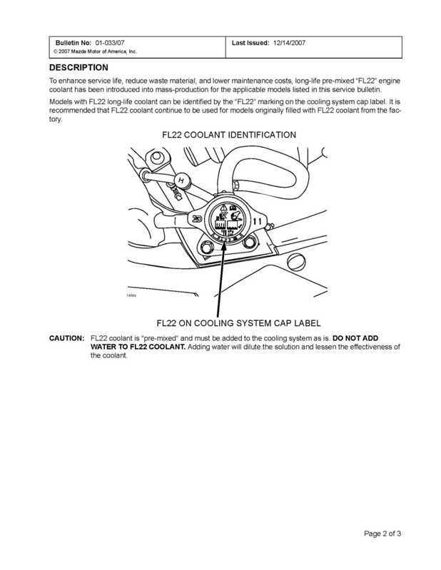

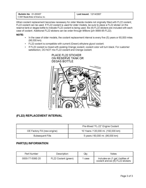

John, if you need FL-22, i have like 3 jugs of it. you only need about 1 1/2 to fill your car up. let me know.

From @TiGraySpeed6 on the mazda6club forums
MS6 Fluid Notes & DIY Pictures - Mazda 6 Forums : Mazda 6 Forum / Mazda Atenza Forum
> Coolant
'06 MS6 Manual - 8.5 us qts (2.25 us gallons)
Type- Mazda FL22
Mazda OEM - part# 0000-77-508E-20
Ford Specialty Green Coolant - Motorcraft part # VC-10-A or VC-10-A2 - $27.59 gallon 50/50 mix
Zerex Asian Vehicle Coolant - NAPA Part # ZRX 675130 - $13.99 gallon of 50/50 mix
It seems that only Mazda has coolant called "FL22"
- - Well, OK then, just WTF is FL22, and is this going to be a PITA?
Some clarity, compliments of the BobIsTheOilGuy forums, and a poster named ponderosaTX:
"...Mazda automotive coolants are green but they have almost NOTHING in common with conventional North American green coolant. Prior to the 2005 model year, Mazdas were equipped with a first generation P-OAT (phosphated organic acid technology) coolant developed and manufactured by CCI, the leading Japanese coolant company. P-OAT coolants rely on a combination of phosphates and organic acids to prevent corrosion; they contain no silicates or borates. In the 2005 model year, Mazda started using a second generation P-OAT coolant which has a lower concentration of phosphates and an improved organic acid additive package. The other major Japanese auto manufacturers, namely Toyota, Honda, and Nissan all use essentially the same coolant technology.
The only aftermarket P-OAT coolants are Japanese OEM coolants from Mazda, Toyota, Honda, and Nissan, Zerex Asian Vehicle coolant, and Motorcraft Specialty Green Engine Coolant (which reportedly is identical to the second generation Mazda FL22 OEM P-OAT coolant). For the record, Ford started using Japanese P-OAT coolant technology in many of its 2009 models (those sharing engine technology with Mazda) instead of G-05. Ford evidently found the performance of Japanese P-OAT coolants was superior to G-05 in Mazda engineered engines.
Using conventional North American green coolant in a Mazda is a bad idea. Even German (BASF) coolant technology as embodied in G-05, which contains silicates and no phosphates, is a much better choice than conventional North American green for vehicles with aluminum blocks and aluminum radiators. But a genuine P-OAT coolant, particularly a second generation P-OAT coolant like Mazda FL22 or Motorcraft Specialty Green, is the best choice."
It now looks like Ford Specialty Green Coolant may be the cost-effective alternative to Mazda FL22. Zerex Asian Vehicle Coolant is another option.

Default PRE-MIXED LONG-LIFE "FL22" ENGINE COOLANT Service Bulletin
The Following 2 Users Say Thank You to Lex2007 For This Useful Post:
jax ms3gt (08-30-2015), ZetaDrift (10-02-2015)

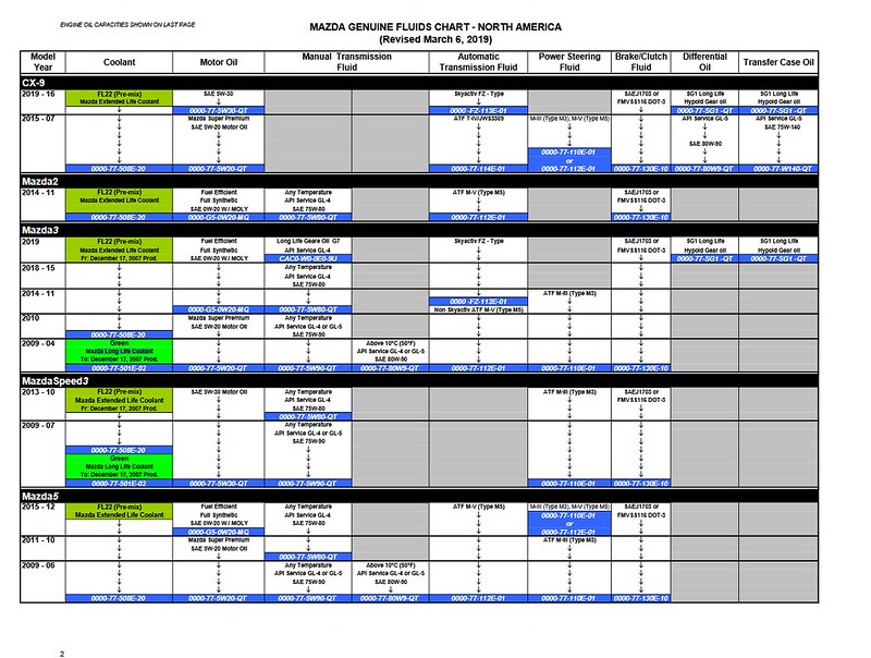

According to Mazda parts counter (Dan at Ourisman Mazda in MD) any Speed3 produced *after* December 17, 2007 uses FL-22. Before that it *does *not use FL22. AllData contradicts this, and states I need FL-22.
AllData isnt incorrect but there is a caveat. As per the TSB 01-033/07 in the above post, you CAN use FL-22 on older Speed3 but dont mix it with orange coolant because it will turn black.
Dan sent me this Mazda Fluids Chart updated March 16 2019 is as follows:
