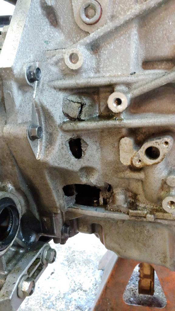

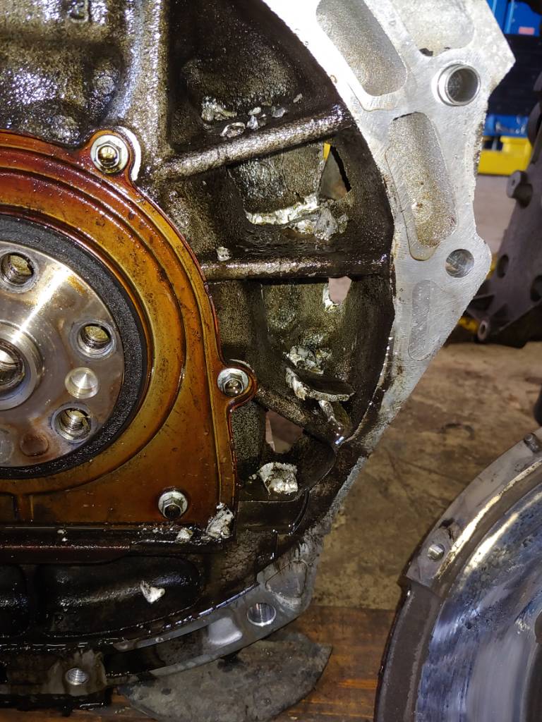

So, finally got the fresh motor in my gen1. It's great. Love it to bits, as I always have. No major hiccups, other than an axle being stuck in the hub and getting in the way a bit. Thermostat is also stuck open, but it's summer and I'll get to it soon.
Have about 600 miles on the motor so far, did a 500 mile oil flush and then out the good stuff in there.
I'm a paranoid type, and yes I know the car has a wideband in it stock, but I have another just so I can watch it. The previous motor ran around 12 under hard load if I remember correctly, and was pretty stable. Now, under hard load (4th, scared to truly lay into it still) it drops real low. Into the 10s. I can feel it, there's a slight drop in power. Scares me pretty bad, I cleaned the MAF, checked for leaks, haven't found a thing.
Bonus images of the 3 (or 6, if you count it) holes in my old motor included below.
