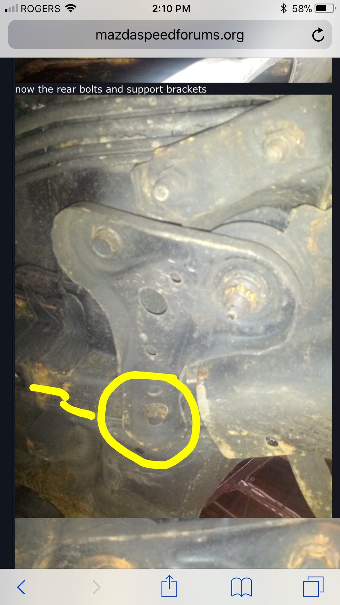

I think I’m going to helicoil it and jb weld the helicoil in place. I don’t have correct pitch tap as it’s m12x1.25 and finest I have is 1.5. But for sure there’s not much point in trying.
There’s no access behind unless I’m cutting a hole into unibody frame rail. I found a pic of which one I’m talking about. Luckily other 2 are holding very strongly.
