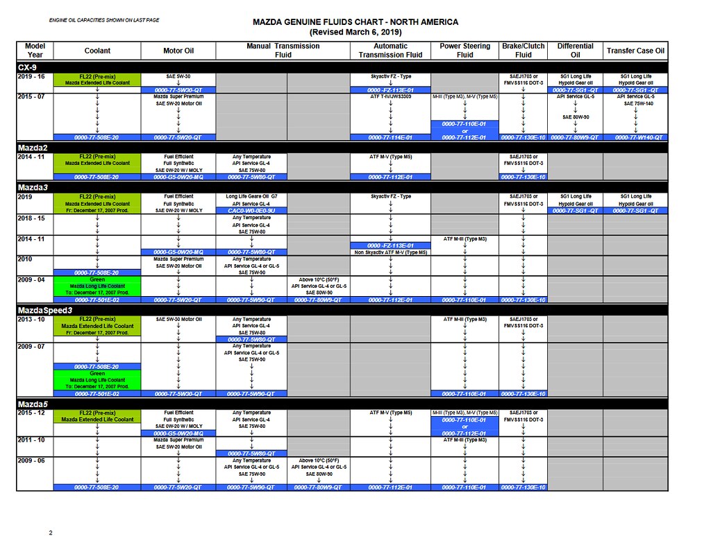

Default Mazda Approved Fluid Types by Year & Model Chart - Updated March 6, 2019
Provided by Dan at Ourisman Parts Dept. Mazda in Maryland.

Speed 6? I know...same as MS3 except transfer case.

It might be on a subsequent page. Ill ask him for it.
