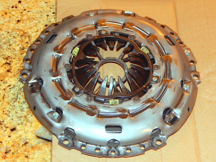

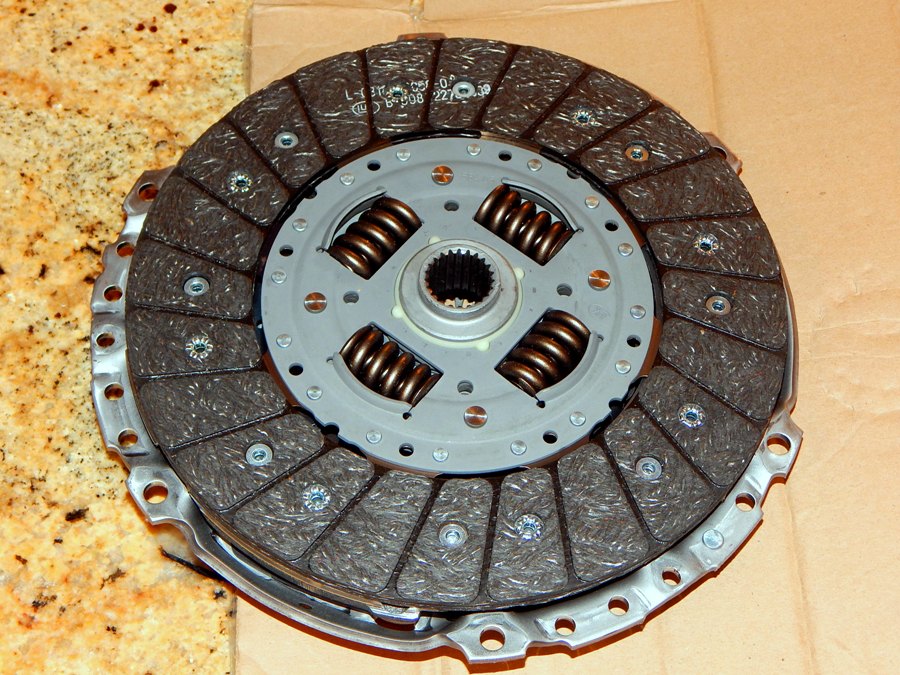

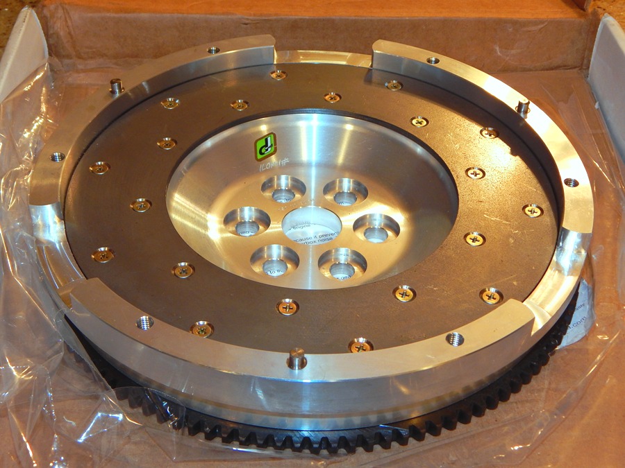

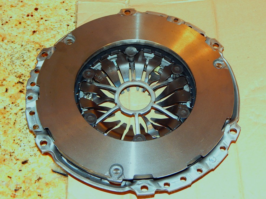

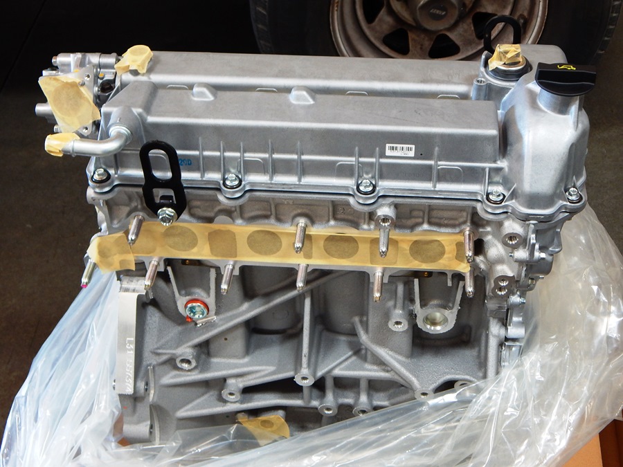

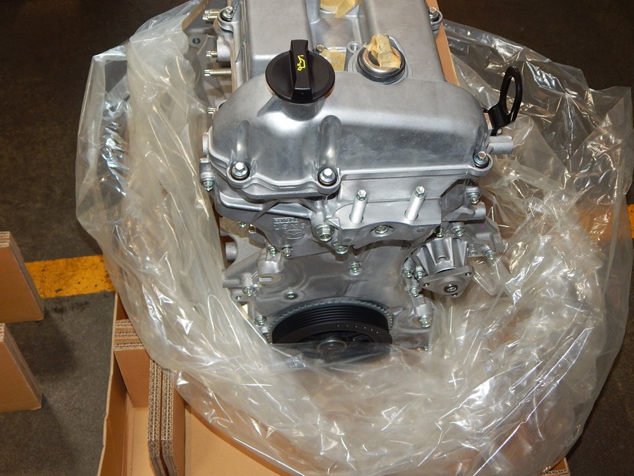

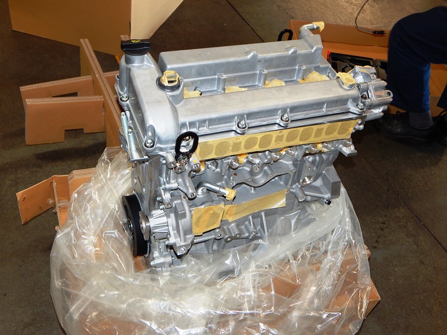

Little early motor porn... Stopping by shop tomorrow to snap a few more shots including virgin mzr.
Fidanza FW
Only big surprise with FW was this right here; not very common anymore.
LUK CLUTCH
And CP-E safe seals. Damnit if I didn't put about 1-2k miles on my car since I installed a set of these on the last motor...
Injectors are going out for cleaning and then it should start coming together pretty quick. Maybe by Friday.

Is that a LUK stock replacement?
08 MazdaSpeed3
 Old 08-27-2014, 09:01 AM   #94
dale_gribble's Avatar
Posts: 4,720   (View Stats)
Rep Power: 5431
Thanks: 2,552
Yes

That's the one I'm getting when is time too, 299 on eBay for the kit =)

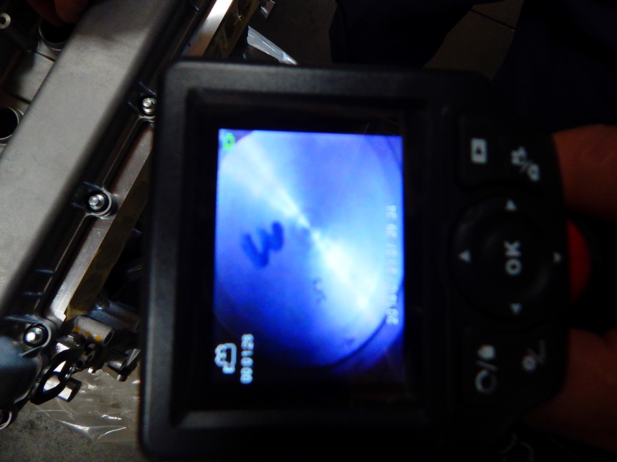

Here's some motor porn. Gen 1 pistons of course, no surprise there. We inspected the cylinders, there were a couple TINY bits of what appeared to be shavings and/or debris in the cylinders on the pistons/walls. Definitely worth it to clean them out before install.
Pistons were numbered with handwritten numbers up top; I assume that's part of the balancing process.

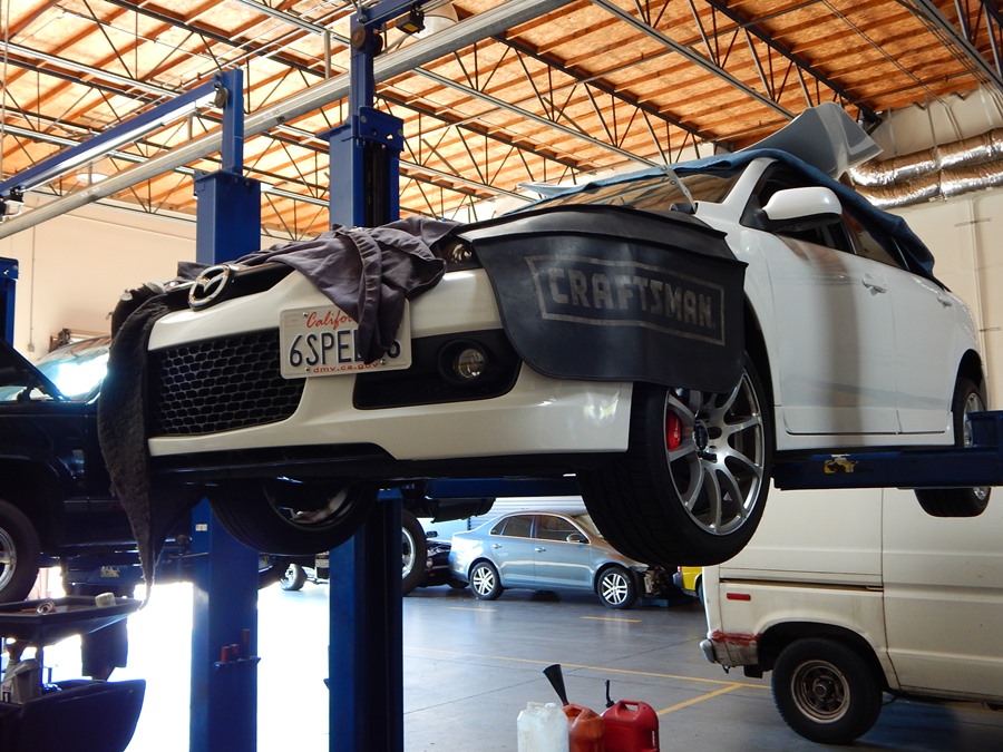

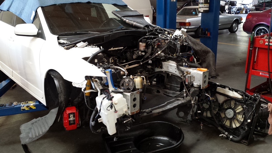

MS6 still looks good in the air in pieces.

Why is the hood off?

Hmm. .. dunno.

I stopped by shop today, it looks like motor should be swapped over today and tomorrow delivery is still a reality. I would have taken pictures but it wasn't very exciting. Just a ripped apart car. They did decide to pull the motor out of the front of the car.
