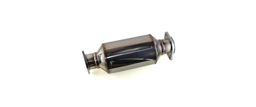

| Not Ranked : 0 score Several members have the Magnaflow CBE, but I haven't seen the Magnaflow DP before. Thanks for sharing this. Not for sale in the state of California - lol Do you happen to know what it fits (MS6, MS3 Gen1 and / or Gen2)? It just says Mazda(10) when I push "Vehicle Fitment". Also, can you see a price? It might be picking up my foreign address or that I do not have a logon.
