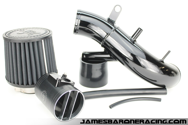

James Barone Racing (JBR) DISI TIP
(Stage I SRI, Stage II SRI / TIP, Stage III CAI) or Wide Path (3” tube 59% up to 3.5” 41% for 4” turbo inlet, but then requires a small battery box (JBR 51R) (Black, Blue, Red, White); or stock 2.25” turbo inlet) 5-ply, wire reinforced silicon. The TIP reduces turbulence seen in the OEM factory accordion rubber hose version and can flow to 300 g/s on stock K04 turbo. SS T-Bolt Clamps, plug to run in non-recirc mode; James Barone Racing (JBR) Filter: soap and water washable dry filter (avoids over oiling) can flow 200% more air than OEM while providing superior engine protection capable of removing extremely fine particles down to < 0.1 micron; developed with K&N (similar to CorkSport and Cobb)
Available from:
