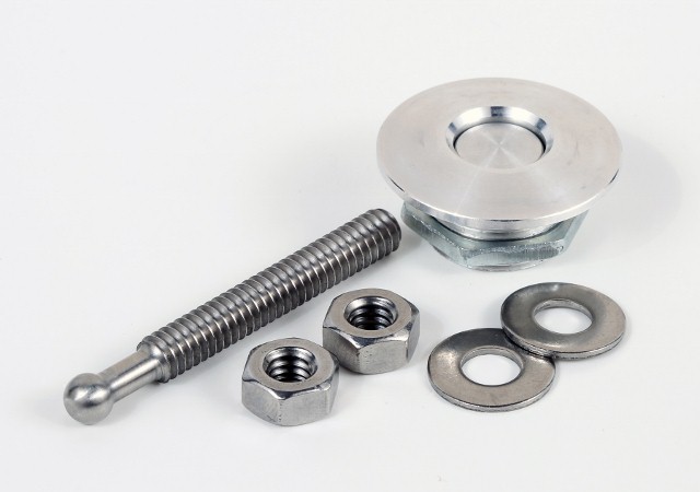

Update 11/24/14. After 2 years, empty promises from fabricators, I had a set from Quik-Latch sent to me to DIY. With help from @CheAlde; and the North FL Nator crew at our Thanksgiving Install Meat, we have a solution. This probably will also carry over to MS6 and GenPu, if you see how we did it. We used @speed3 britz;'s pics as reference, did the rest by trial fitting.
QL-25 S Quik-Latch Mini Latch Fastener
Pics are attached. Very happy with the results. How to is here: http://www.mazdaspeedforum.org/forum/foru...ent-fix-180663
And please like their page! https://www.facebook.com/pages/Quik-...14256808648202

Just saw these,
QL-25-B Mounting Buckets For Quik-Latch Mini Latches
I am going to look into these a little more, as they offer depth adjustment, and are pretty easy to install. Just need to drill the mounting bracket to fit the bucket.

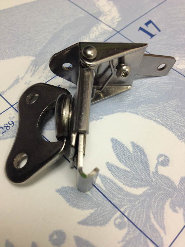

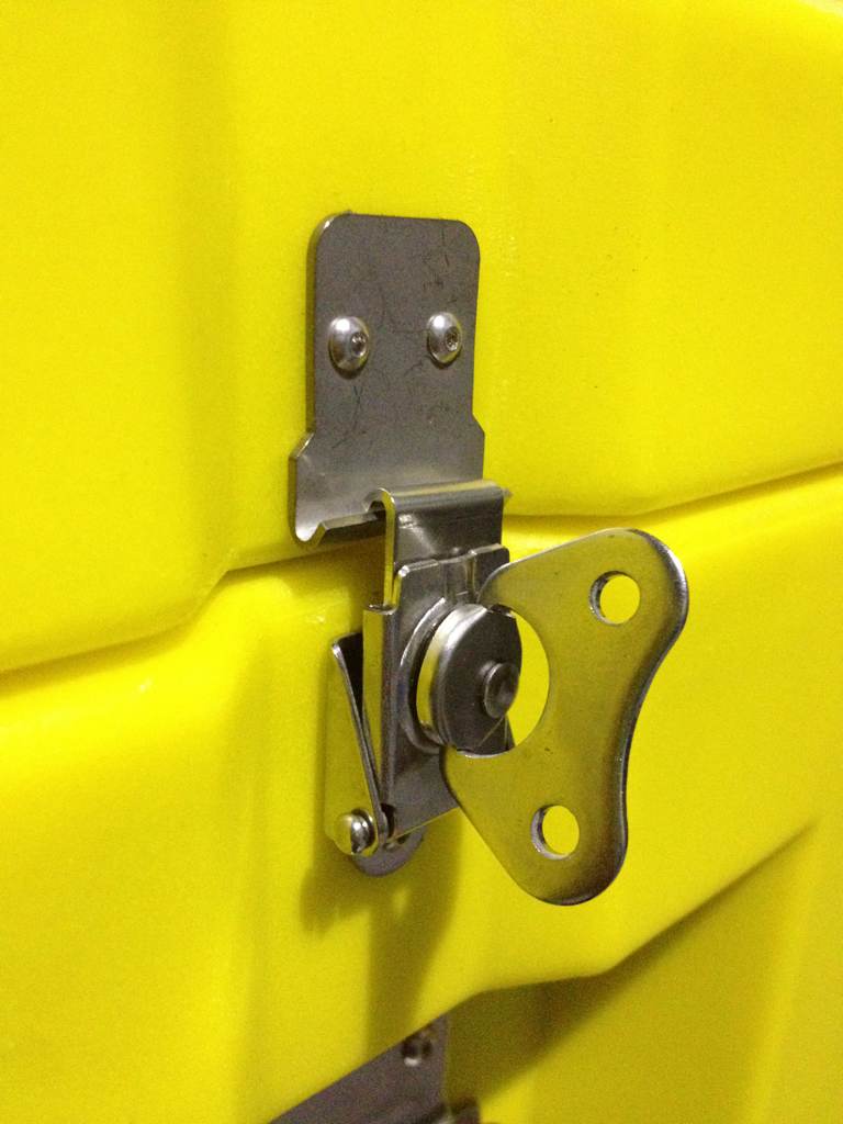

@Raider i have been looking into doing this since the car blew. and now that im close enough to have the car running again i have been looking more and more into this. these are both great ideas, here are a few things i have been personally looking into, no flame aloud, just LOOKING, some more than others:
I love the idea of these and the simplicity of it, but they are, without question... FUGLY!
Quick Release Fasteners
I think these would be sick, or something along those lines, these could be easily made/ purchased from home depot or something.
Elise Parts - Bodywork & Styling - Exterior Trim - Quick Release Fasteners
they are essentially a hood pin, but used for skid/windage plates/trays as per the website.
the ones you are talking about will work but with my experiance with that kind of thing (naval aviation) are prone to corrosion, but pending on what they are made of, the two I linked are the two main ideas i have been looking into but have yet to actually install them on the car, I dont know if i would want to use the larger of the two you posted as you would have to cut a fairly large hole in the bumper... *not a fan of that*
EDIT: this is also something I'm looking into, I use these at work...
