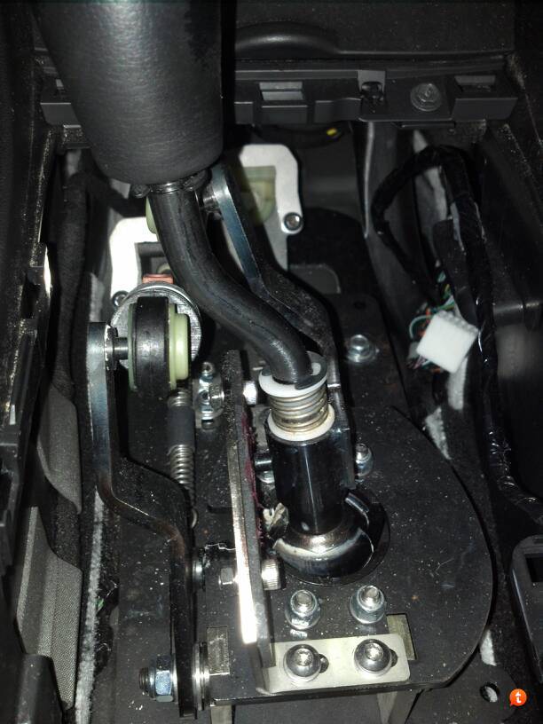

Would anyone be willing to take a photo of where they have their lockout plate set? Or even the base mounting bolts? Any visual details at all?
I just need some visual reassurance that this thing can't be adjusted any better than it is. Maybe I'm overlooking something silly.
"... adjust the side to side movement until there is about 1 mm between the shifter shaft and the cable end." Bitch, it won't even reach 1mm from the selector cable!
I'll post a photo of mine later tonight.
Have you loosened up the base bolts?

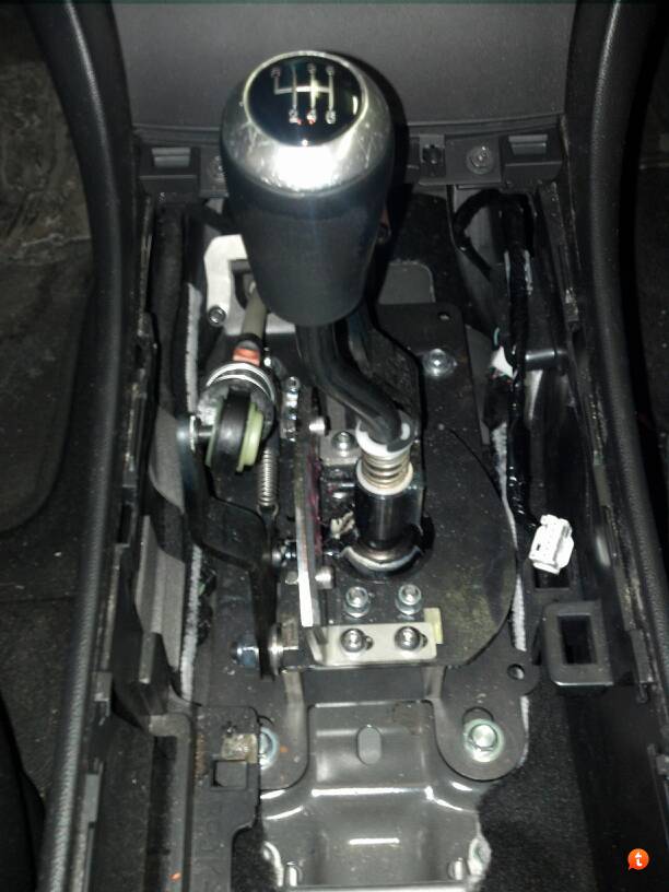

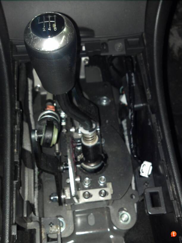

Anything unusual here?
Sent from my XT912 using Tapatalk
