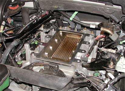

Would there be any outword tell tale signs of this happening? Like oil level going down over the course of so many miles? I have an 09, will you be looking in to any 09's to see if anything has been corrected on them? How many 09's have popped?

Well I can tell you that before I got my catch can (saikou michi) I would get a good amount of part throttle knock and right as I was going WOT I would smoke puff out the exhaust. Ever since I put in the occ, rarely any part throttle knock and zero oil puffs out the exhaust.

this is great info, so a baffled oil catch can, egr delete oil is still getting in the IM? Even you you clean it frequently?

so is this puff of smoke good or bad off start up? cause right now if my car sits for the evening then i start it up the next morning i usually get a puff of smoke.

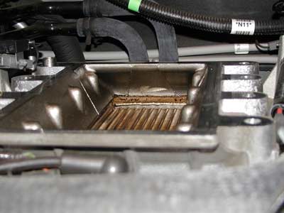

i'm here watching all this get figured out "again" lol
no offense John, but the oil in the mani is an old news kind of thing
a correct OCC with extra pcv or check valve and deleted egr kept my intake clean as a whistle
I never had knock on my no tune set up
additionally, the reason I opened up the rear of the valve cover and vented it to a different OCC (vented/filter on top) is because I didn't want any oily vapor entering the intake tract when boosting as I was at or above 20psi
no BS it's a full time job to keep this engine clean
I cleaned or replaced plugs often, changed my fuel sheared oil every 2500 miles with PP and kept my OCC empty all the time (every weekend)

The problem is oil control, and the intake filling up with oil on long trips at a particular RPM (cruise at 3000 rpm seems to be the key point that causes the oil build up).
If that much oil is getting into the combustion chambers, that could be reason for the knock we get under light throttle, or the heavy knock after you get off the freeway or after a long drive. Again, I suspect that there is a bad RPM that causes oil to build up in the intake manifold due to the very very poor design of the PCV system and the oil control in the pan.
