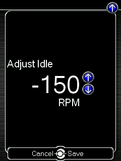

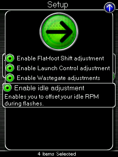

Accessport Idle RPM Adjustment:
Creating additional vacuum at idle can help to subdue an exhaust smoking problem that is common on Mazdaspeed vehicles. With Advanced Tuning Settings activated on V3 Accessports, users will now see an option to adjust idle RPM in 50 RPM increments with a range of +/- 300 RPM from the initial idle value. Once enabled, users will be prompted to adjust the Idle RPM during a Map Change. Most have found an increment of 100-150 RPM addresses issues with smoking at idle. Please note, adjusting the idle values too low may prevent the car from being able to maintain idle.

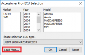

Users can now load a Map File from the ECU Selection Panel. This is convenient for Protuners who need to make updates to a custom tune file where the file name does not indicate the exact ECU type.
