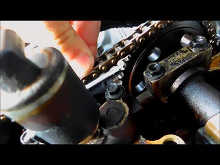

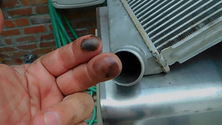

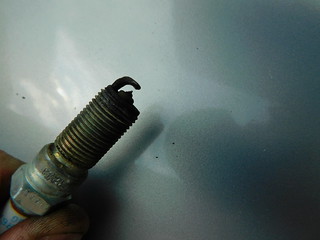

Then I found all of this earlier:
Time for a new chain? Click for video.
Nice plugs, two of them were like this.
I think the turbo may be leaking...
Play stupid games, win stupid prizes...

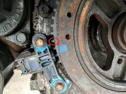

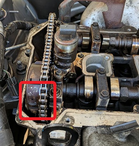

ok as for the chain its not your chain that is doing that its your tensioner.. as for your oil issue check your PCV maybe even change it and add a catch can with another check valve to to stop crankcase pressure.. also as for the low cylinder you can also have low compression from a leaky injector seal so you might want to do a leak test for that..
Sorry I might be misinterpreting this. Are you telling me that chain is okay and the tensioner is bad?

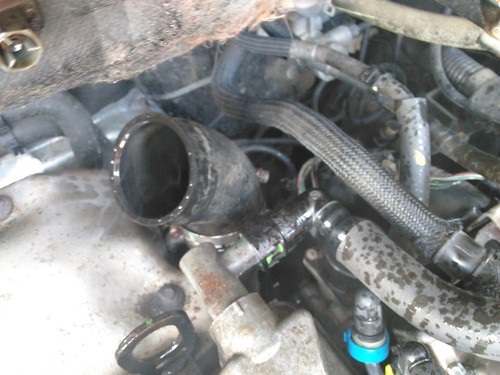

The PVC, I blew threw the cover and the hose and the nipple on the turbo intake. It flows great both ways forward and backwards. The check valve must be blown. Would you suggest a new factory PCV or something like a Krankvent?

Let's make sure we are speaking the same language. Can you post pictures of what you blew through etc? And by "turbo intake" do you mean the intake manifold that's connected to the head, or the intake attached to the turbo compressor inlet?
See, the PCV system has nothing to do with the intake attached to the turbo compressor inlet. On a ms3, the valve cover does vent to the intake. The PCV down on the block is attached to the intake manifold (which is past the turbo compressor, the intercooler, and the throttle body) through the PCV valve which is essentially only there to provide anti-backflow during boost conditions.
Even if your PCV valve is blown, as long as it is open, if you hooked up the corksport OCC that would fix the problem. Because basically they have you tee the PCV outlet tube and the valve cover outlet together, then connect to the tube on the (pre turbo compressor) intake. They have you cap off the normal PCV sucking port on the intake manifold. Since the pre-turbo intake is always under vacuum, it constantly evacuates the crankcase and the valve cover. It's not necessarily the ideal setup depending what you're going for but it's simple to install and it works.
That #3 compression result sucks, man, big time. Definitely do a leakdown on that cylinder to see if you can identify the loss. If it's through the ring/crankcase then read the following thread: https://mazdaspeeds.org/index.php?th...dventure.3316/ and maybe try the ring cleaning procedure on that cylinder...
I'm wrong, it was the valve cover, the ventilation hose and the fitting on the plastic turbo inlet. I will download a manual so I know what I'm talking about. Sorry, I am old school. I saw the hose coming off of the valve cover and thought that had to be it. Old dog- new tricks.

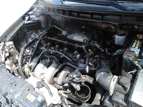

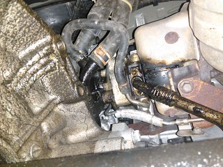

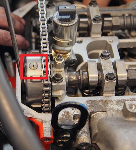

Today I learned a lesson...
I have decarbonized engines in the past by running a small plastic hose drawing water from a bottle into the intake. So I set everything up on the CX-7 and it smokes a little bit and I turn my head around to look forward and see smoke under the hood and then I see my fence.
c3 b
I shut the car off and was greeted with this mess. The turbo must have spewed half a quart on the engine.
a1
b2
Apparently Mr. Turbo couldn’t handle all that spinning and threw up all over the car and fence. I cleaned it up, bought the GM Top Engine Cleaner and I’m soaking the cylinders like a good boy. I guess I can’t be left alone… I'll let you know the compression and leakdown test as soon as I complete them.. Today was brought to you by the letters, F and the word ME...

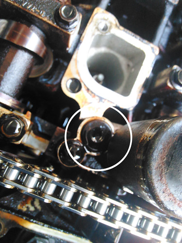

I let the AC Delco Upper Engine and Fuel injector Cleaner sit in cylinder 3 overnight. I modified a turkey baster and sucked the cylinder out this morning. I cranked the car over to blow out the cylinder and let it sit until 4:45 p.m. I did a compression test and with a cold engine, the dry test was 164 pounds. This puts it at 18 pounds less than the rest of the cylinders but with the Mazda recommended variance of 28.5 pounds.

As far as my chain video above, is the adjuster bad? Or is it the chain?

Good work, another win for the cleaner. I tell you what the dude that suggested that is THE MAN.
I can't help you too much with the chain but I'm pretty sure they are replaced together so there's really only one question - is it too much play.

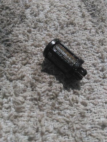

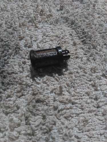

Guess what, there is a filter. I'll take some pictures after I pull the valve cover off.

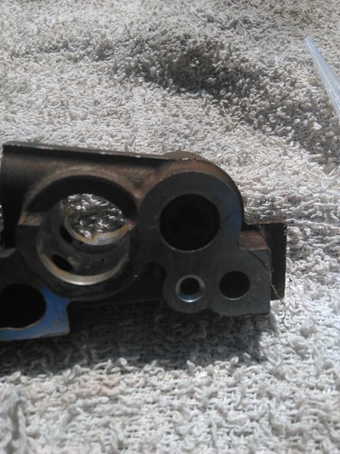

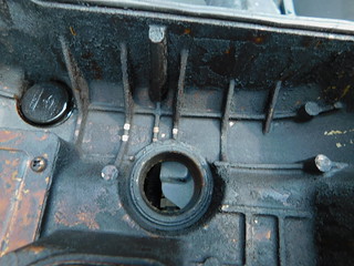

Excuse the crummy cellphone pics.
The filter is under the cap that is circled in the pic. . I couldn't remove the the cap and I didn't want to use any heat on the plastic filter so I pulled the whole cam bracket out.
sa
You can see the filter inside the cam bracket, I had to carefully pop it out with a small bent screwdriver.
sd
You can see the filter is dirty. I washed the bracket and filter with brake cleaner. I cranked the starter for a sec to blow anything out of the oil galley that may have been trapped by the filter.
sc
sb
I reassembled everything and started the car, the nack sound was back and lasted for about 4-5 seconds. I know that's because there wasn't any oil in the filter, solenoid and bracket. I'll wait 4 hours and try it again. The idle did drop down and smoothed out quickly. I hope this cured it.

Wow that's pretty fantastic. Have to wonder if there have been a lot of replacements that could just have been cleaning jobs, if it works. If not I guess you're going to have to full-up fix it. Wish you luck here.

Okay everyone I believe I have a huge problem. In order to put my timing plate in place, I have to rotate my crank off of top dead center. It also looks like my VVT is the wrong position compared to pictures of other VVTs by other members.
Here's a picture of a VVT in Rokusek's how to VVT thread. HOW-TO VVT
[IMG]2606ark
My VVT position and my balancer position (two teeth off) when the cams are timed with a plate. The timing mark is the tooth in the red circle.
[IMG]VVT
XCrank
Do I just continue with the disassembly and retime the crank back at TDC then put the crank pulley on the correct tooth and then put the VVT in the same position or as close to as I can to Rokuisek's in the photo?
Thank you in advance, Joe

The orientation of the cam sprockets do not matter. All that matters is that the cams are in time with the crank when at cylinder 1 top dead center. You do need the crank oriented properly, tooth wise, but cam sprockets can be attached whichever way you want.
