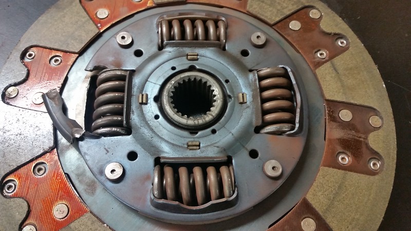

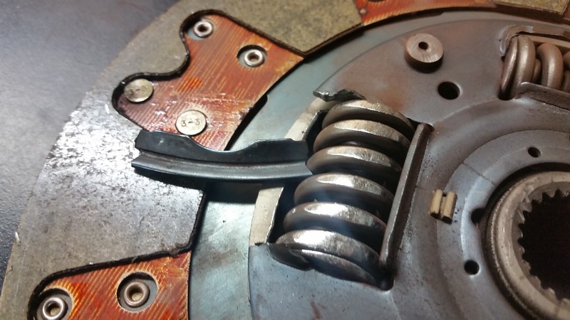

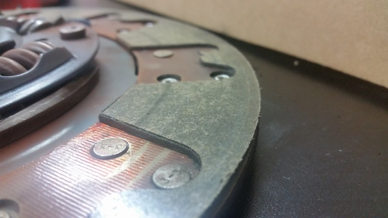

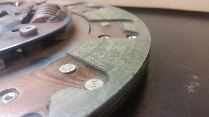

Trans has been pulled and looks like I'm the first person to experience a problem with this clutch. One of the retainer clips broke off on the clutch disk that holds one of the springs in place. This would explain the symptoms I was having! My new throw out bearing which I ordered from you on Friday will be delivered tomorrow so I'll just put that on since my transmission is out, guess it wont hurt.
Wonder if Southbend will replace the clutch disk for me since I will probably be the first to come to them with an issue and with only 21,000 miles on this clutch, I would have thought it should have lasted longer than it did. Since I was one of the first people to buy this clutch, maybe there was a defect in the clutch disk that caused this to happen? Sucks I already spent $250 replacing all the hydraulics which are perfectly fine. Guess i'll toss my old stuff up on MSF to see if anyone wants to buy any of it since it's all good and works perfectly fine.
Thoughts on why this would have happened? I dont race my car, I dont track my car, I rarely even get into higher boost.
Here are some photos of the carnage.

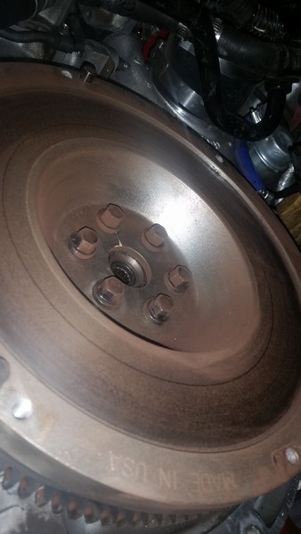

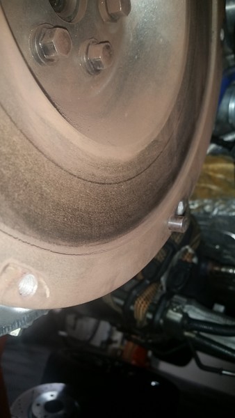

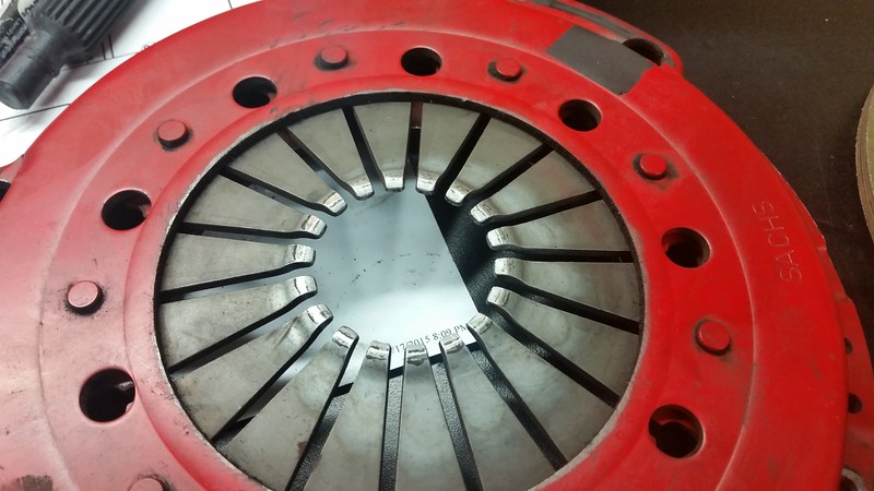

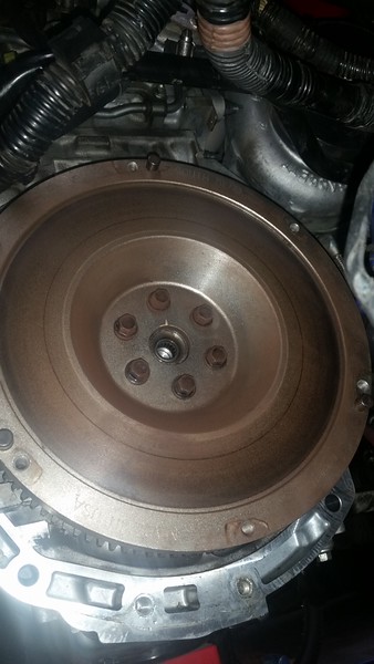

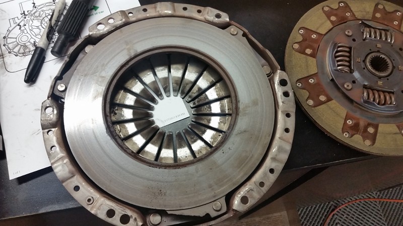

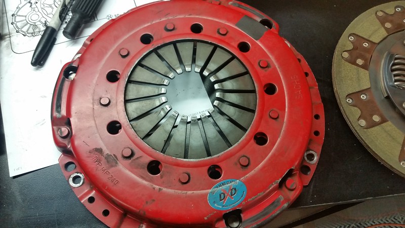

Here are some more photos of the condition of the clutch disk, pressure plate and flywheel at about 21,000 miles on the clock.

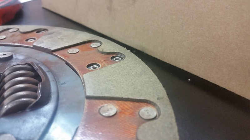

Other than the area where it broke, it looks to be wearing well. Mines done 13K and will be coming out this weekend to be reused on a built motor.
I will get the engine builder to give it a good going over to see if there are signs of trouble where yours broke
Are they cracks as well or just lighting on your pic?

Yeah those do look like cracks. If you were abusing the clutch for that kind of damage to happen, I would expect the rest of the components to show said abuse. And the disc, pressure plate, and flywheel all look great and appear to have lots of life left in them. Have you contacted SB yet? If you need anything from us let me know! We definitely want to make sure you get taken care of!
Excellent eyes! After further inspection I do indeed have additional cracks on 2 more of the spring retainer clips. So 3 of 4 are cracked or broken.

I wonder if it was cracked before you even put it in. Any chance you got any pics that might show that?
I was just thinking the same thing. We'll probably never be able to know that for sure though...

Attachment 194240
Attachment 194241
Attachment 194242
Attachment 194243
Does yours say if it was made by exedy?
Edge.. Do you know what version stage 3 clutch disk that southbend sent me? My previous disk is different from this one.
The new disk says it's made in Japan by Exedy and my old clutch disk says nothing on it.
Any idea which they sent me?

Looks like my pressure plate is rubbing on the inside of the bell housing. Is this a problem and could it cause issues such as making my clutch disk break?

This is the one that went in mine (seems to share same part number as your new one), it was purchased June last year through Edge. I don't remember seeing anything on the other side with exedy on it,
The bottom end along with the clutch is due back tomorrow from engine balancing i will have a look.
When i first researched i think i did read a couple of reports on here with the early ones rubbing (one was a speed6)the bell housing but was fixed after it was reported to SB with newer releases,
