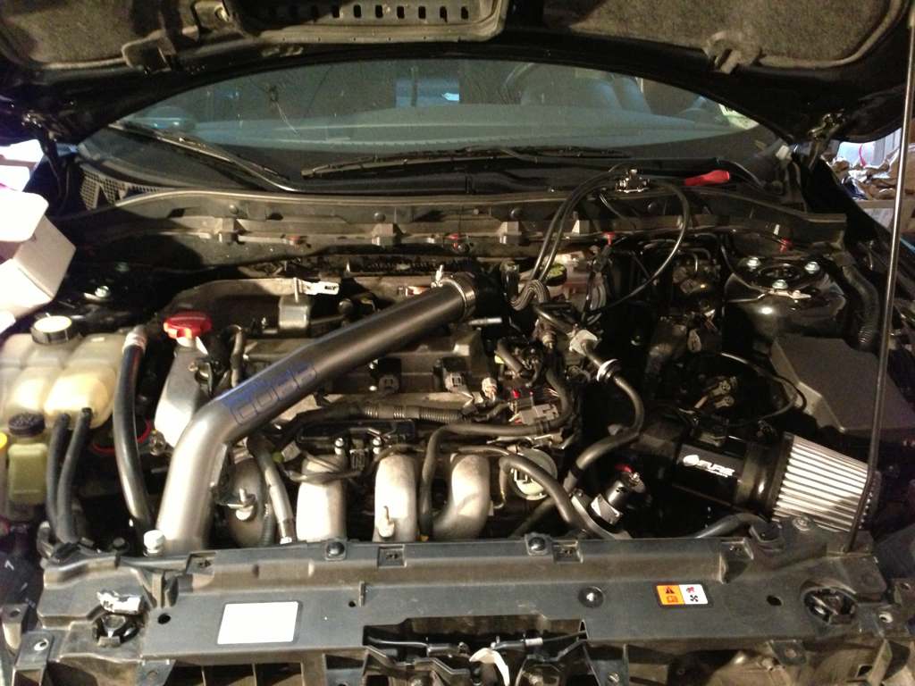

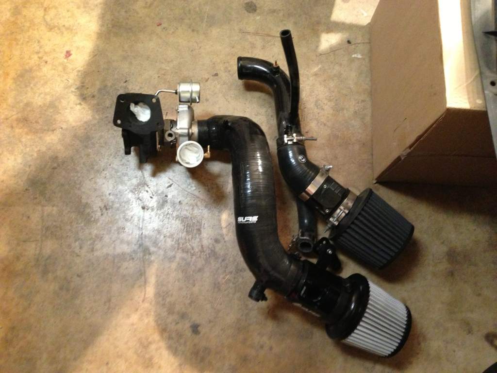

Update: Just a few pictures from the install. Everything turned out really well.

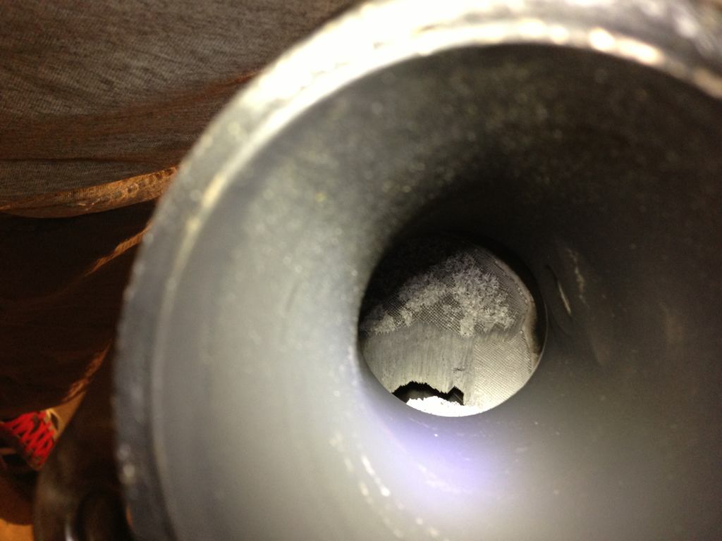

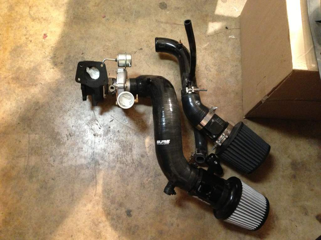

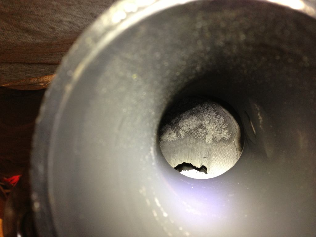

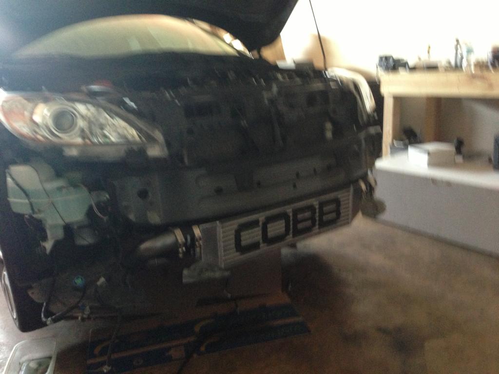

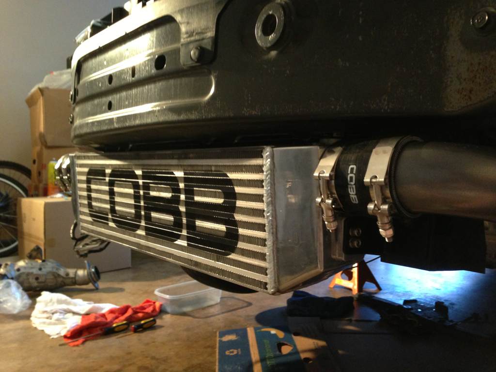

Got everything being replaced taken off. OEM DP was a pain in the ass to take off and I finally got to see if my cat was blown or my O2 sensor was messed up. Probably will be done today, but there's a slight chance we may go another day over. So excited to get everything on.

FMIC looks good. Looks like you guys are getting there! Keep on rockin it!

Alright guys, here everything got in there. Here is the first start video:
Austin's BNR S3 First Start-Up - YouTube
Enjoy
2010 MS3 Mica Black Tech
Cobb AP | JBR RMM 70 Duro | JBR SSP | CS SRI+TIP | CS Racepipe | NGK Plugs | KMD Internals
CS Interior LEDs | Custom Hatch LEDs | Rear Wiper Delete | Custom "Evil M" | Red Taillights | Resonator Delete | SWAS Switch

As Randy said, everything is on and running well. No major hiccups during the install. FREEK base map is spot on. I'm so excited to see what kind of power ill see.

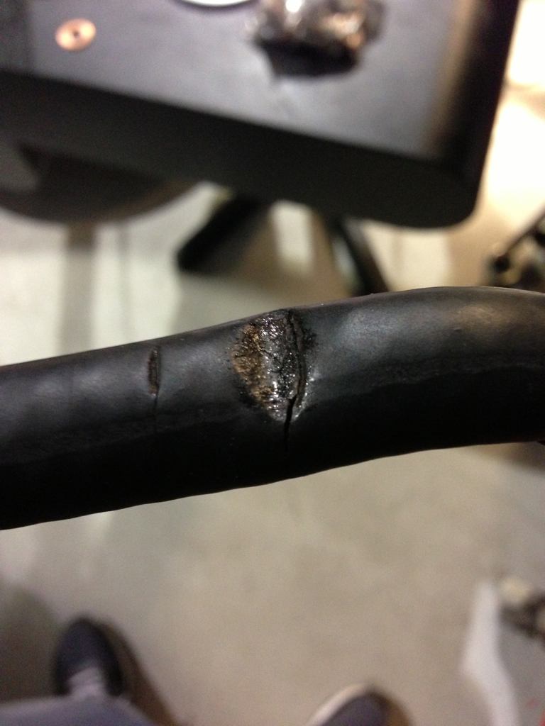

Only issue with the entire install was the coolant hose rubbing against the exhaust manifold and leaking coolant.
After sitting at the Kozmic Motorsports (formerly SSP) for 6 or 7 hours, we also figured out that the banjo fitting that BNR sent me was one size too small and that the crush washers are getting crushed unevenly. I believe that either means the threads are drilled at an angle or the fitting is not right. We did not over tighten the banjo bolt or strip the threads. So now I'm waiting on BNR to send me another banjo fitting and new crush washers to see if it will fix it. Anybody have some thoughts or any experience with this sort of issue?

Definitely seen people used braided lines for coolant hose when doing BNR
