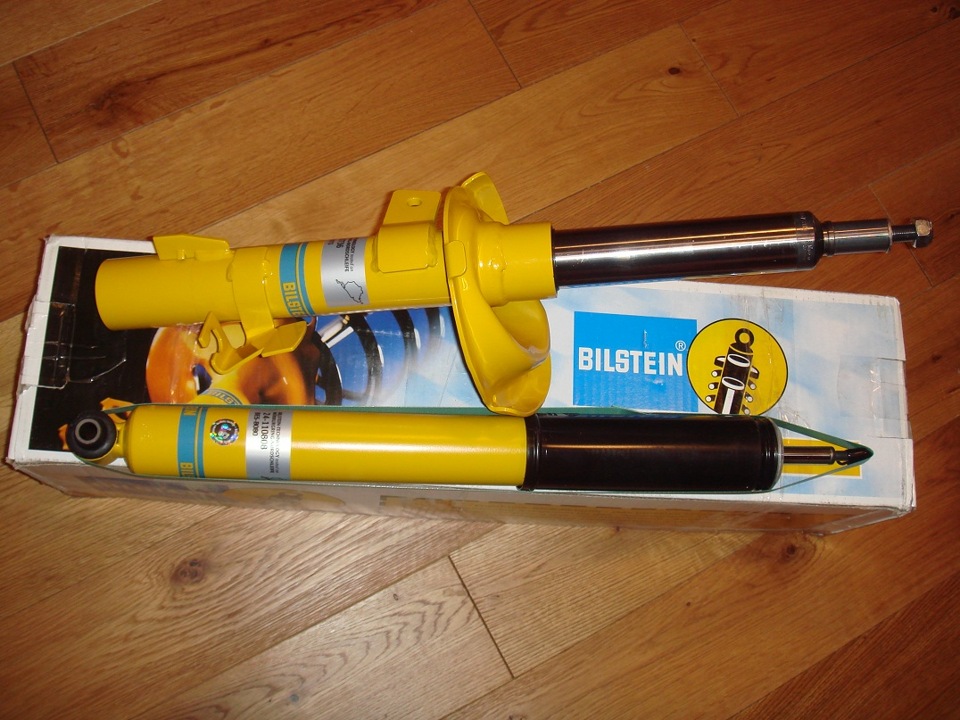

Dampers: I believe I will be using the Bilstein B6’s because they have an extended rod relative to the B8’s, which will allow me to run at stock ride height without the struts limiting the suspension downward travel. I will need to have them revalved because Shaikh indicated to me that they are factory valved for the stock spring rates and sent me this dyno graph of some stock B8’s, which honestly I don’t have enough experience to speak much about:
I'm not sure how you plan on making this work with either the b6 or b8 since the shoulder is so much smaller on the inverted design (GC kit will not work)
I don't understand what you mean here. Are you saying that because they're an inverted design, the adjuster will not fit over the shock rod? In that case couldn't I just buy a different adjuster from another company?

Bilstein dampers are a great choice. I agree with you in not swapping the rear sway bar yet until you finish tuning the car with the springs and corner balancing.

I talked to ground control just now and the guy on the other end was very helpful. I obtained the following information:
1) I can get any spring rates I want in increments of 25 lb/in
2) I can order them in lengths of 6, 7, or 8 inches. The standard size they send people is 6". @zenit; you may be interested to hear this)
3) Their coilover setup will physically fit the Bilsteins, however he told me that during their testing, they found the Bilsteins' internal bump stops limited travel in the compression direction, although he did not specify whether they tested with the B6 or B8. Personally I believe this will be a non-issue at stock ride height with the B6's. I will verify with Bilstein when I call them about the revalving.

Like I said I thought about a cutout, even an electric version of the above device. They are too loud for my taste. After 30 minutes driving up and down the dragon with that thing open, I have a feeling I would want to die.
look closer at the ECV valve, it's actually designed to be sammiched between a two bolt flange connection and is spring actuated, with a cable manually adjusting preload, very similarly to the VT muffler. There is no vent to atmosphere.
Yeah Shaikh told me that GC could probably get me longer springs. I would try to get longer springs front and rear and use the adjuster that comes with their kit for the rear. I still haven't called them yet. I got home too late last night.
7" or 8" springs in the rear should be the ticket, if using the GC rear adjuster. I'm using 6" provided with the kit. 8" would likely be safer since there's at least a couple inches of adjustment in the rear and you'll be running softer springs than what I'm running.
You know it's interesting, Shaikh had some kind of concern about the fitment of the GC kit but I dismissed it because I couldn't understand how there would be any fitment problems when both the Koni yellow and Bilstein B6 are designed to be OE replacement parts.
The bilstiens use a much thicker "shaft" (which is actually an inverted shock) as compared to oem or koni's standard twin tube design, which means a greatly reduced shoulder, where the GC coilover sleeve rests.
Before you spend money with GC, I would call back and get specific about how they have resolved this issue and if they have any cars actually running bils with their kit.

Thanks @zenit; I will call GC again tonight to confirm, although the guy I spoke to sounded pretty knowledgeable and he was sure that they would fit the Bils. Have you measured the stock springs at all? I can't find any measurements here on the forums. I want to run the tallest spring I can both front and rear without raising the car by any significant amount.
@Mauro_Penguin; I definitely see your point. You're right, braking (and also accelerating, which produces the opposite weight transfer) is one area where having different wheel rates would definitely be non-ideal, because the weight transfer easily overwhelms the relatively small difference in observed corner weights. Whether this would be enough to matter, I don't know. Let's say under braking I throw another 600 pounds on the front wheels and I have a 450 lb/in spring on the driver's side and 400 lb/in spring on the passenger side. Assuming the weight transfer was equal on both sides, the passenger side would compress another 1.500 - 1.333 = 0.167" (minus whatever residual effect remains from still having my weight on the driver's side). The only thing is, I believe having a higher spring rate on the driver's rear would actually increase the weight transferred to the passenger front, and I don't know how the math would work out there. @phate; any input?
The best route may either be going with a small difference in spring rates in the front only, or no difference in spring rates. I guess no matter what I end up with, if the setup pisses me off and feels squirrley like my current one, I can always just buy another set of springs and try again. The dampers are going to have the same valving on both sides
One thing I do wonder about is what the tolerances on these springs are. I wonder how GC can even offer 25 lb/in increments.

I am hashing out some of the suspension details with phate offline. In the meantime I spent more time planning other stuff.

Hashed out some of the details with phate offline. This guy is a fountain of suspension knowledge. Basically determined, my original theories with the different spring rates are not going to work for what I'm trying to do. I think different spring rates could actually work well in some situations, like low-speed autocross events where cornering response is paramount, but not for me
Take as an example just the front "axle" - the driver's side has more weight on it, which increases cornering load on the driver's side tire during steady state cornering relative to the passenger side. Increasing spring rates individually has the same effect - increases cornering load on the tire, therefore, my plan would have actually exaggerated the differences between the sides during steady state cornering...in theory.
Moving right along...I talked to "Tim" at Bilstein in North Carolina who will be revalving my B6's. E-mailed him the info. I will be ordering 425/500 lb/in springs front/rear from ground control in either the 7" or 8" size.
I'm also thinking about ordering the Moog K160228 top hats instead of the OE for when I swap out the fronts.

Minor update...As always RPM hooked me up with a killer deal on some Bilstein B6's, which are en route to Bilstein in North Carolina to be revalved...get this...$40 a corner. I cannot wait to get these things installed. I know they are going to perform well. Also have to give a shout out to RPM for providing >90% of the parts on my car at this point that I haven't bought locally.
Ground Control springs also ordered. Ended up going with 8" springs all around, 425 lb/in front and 500 lb/in rear.
Bought new front OEM top hats and bearings as well. Will likely reuse the front end links for now and replace later with whatever I decide I want.
On the methanol injection side I discovered today that the cold pipes are different between the Gen1 and Gen2, so I'm going to have to send the one I bought off MSF back and get another one (the seller didn't realize there was a difference either)...
Once I get the new cold pipe I will probably end up tapping it myself since I can't find anyone locally with a 1/8" NPT tap, and that will complete my methanol kit other than the tank from HTP.
Woah, why so cheap for revalve?? They advertise at ~$100 a corner. I'll have shocks moving next week if it's that cheap.
You have the phone number/e-mail you contacted?
Edit: I think we have a couple PU coldpipes at the house. Tag wetz, and I when you put up a wtb. Don't know how the new regime is with banning
-Wetz
Already squared away on cold pipes, I'm buying g00s3y's old one. Thanks though.
I honestly don't know why it's so cheap. His explanation which I tried to recreate above is still confusing to me.
I e-mailed him to ask permission to share his contact info and he said "normally it is $75.00 shock and $85.00 strut - just let them know that". That's still a really good deal IMO...probably more than worth the money, especially if you're running anything significantly different from the stock spring rates. Send me a PM and I'll hook you up with his contact info.
2007 Mazdaspeed3 GT
When I checked last year it was $100/$120, or $90/$110 or something like that. You must give really good head. Good work.
